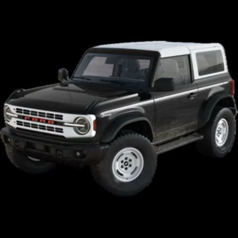

It is a great feature as well as lane assist. I haven’t had those other two warnings on my ‘24 Heritage-yet. 🎄
