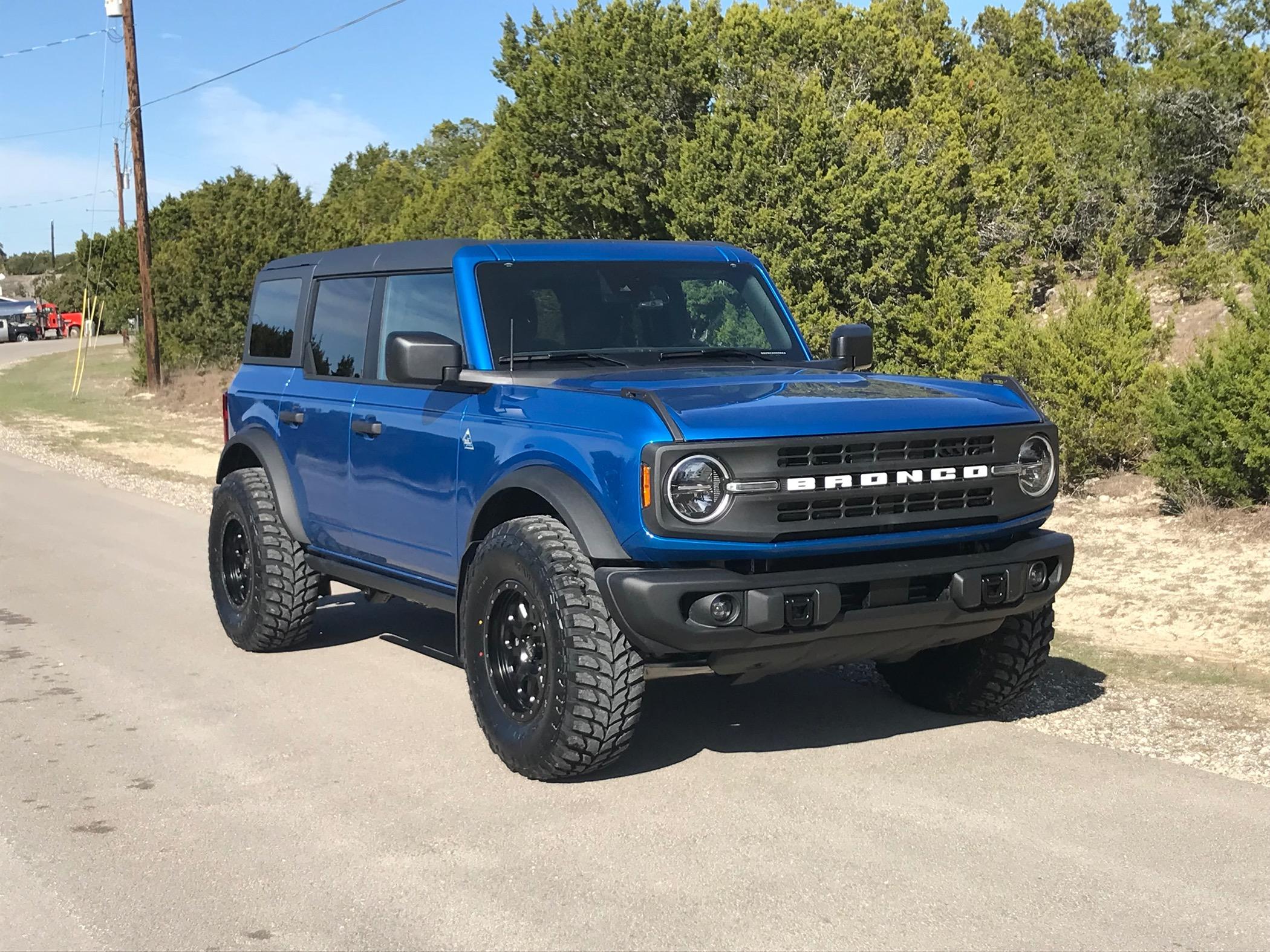

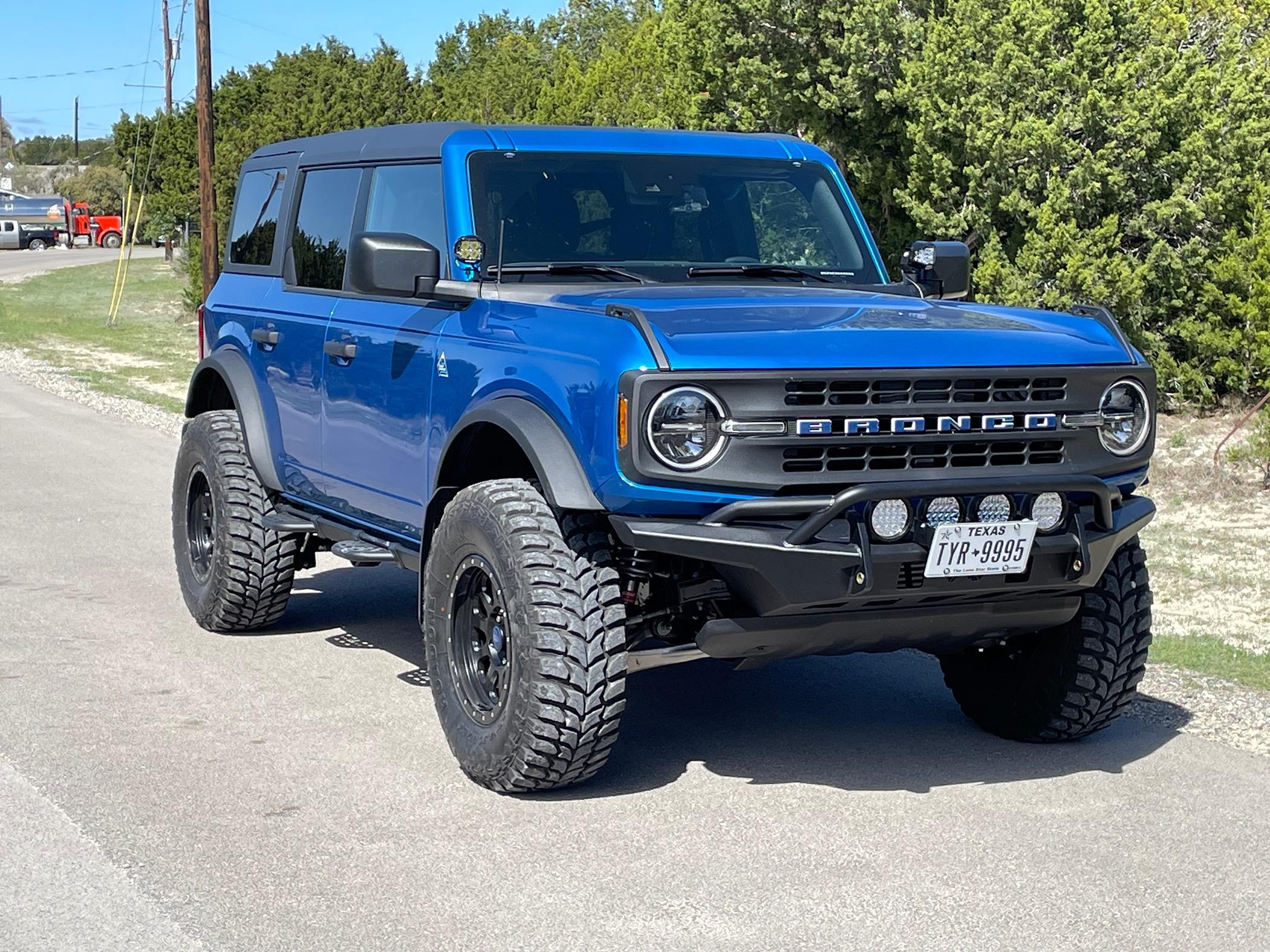

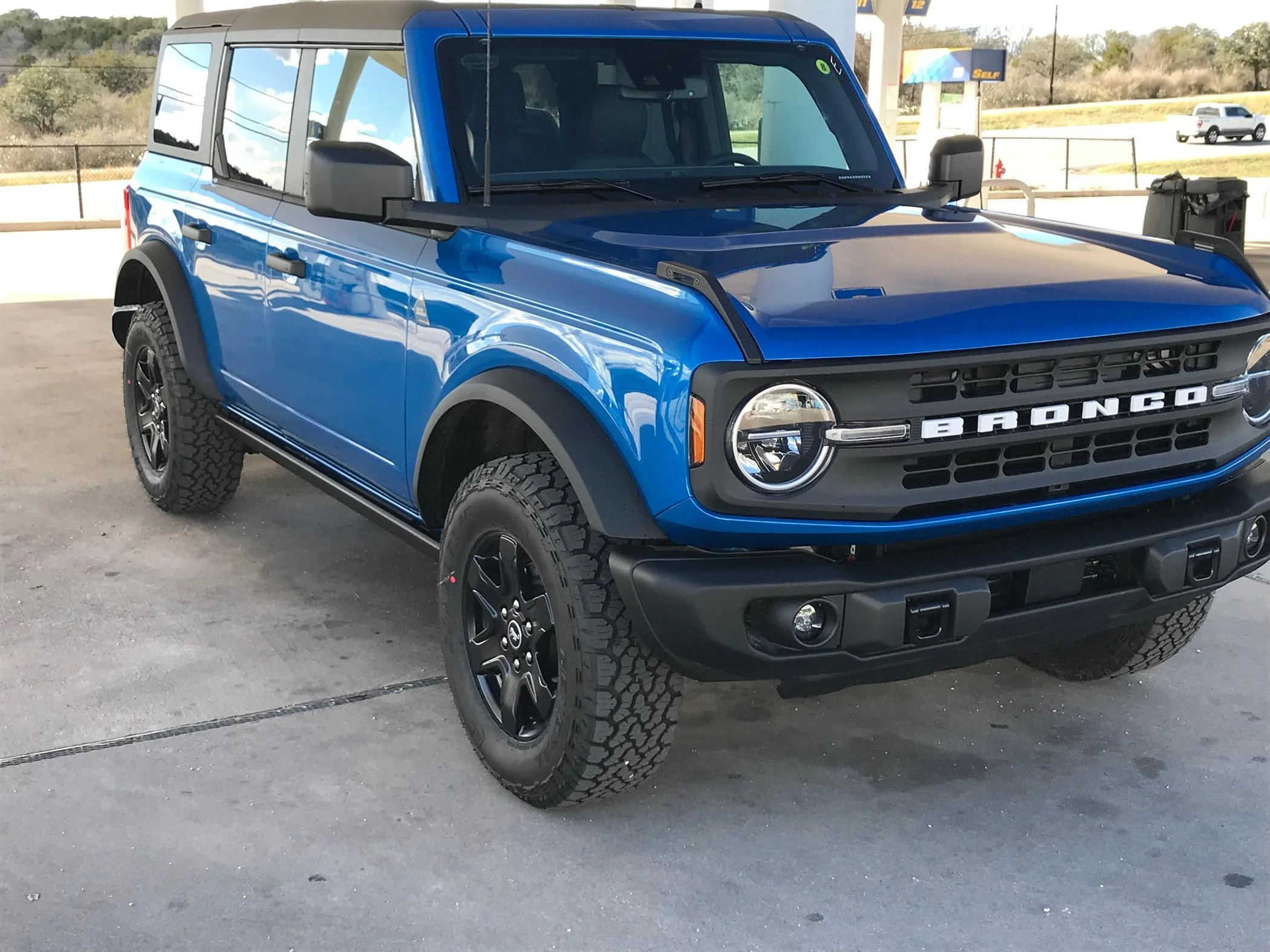

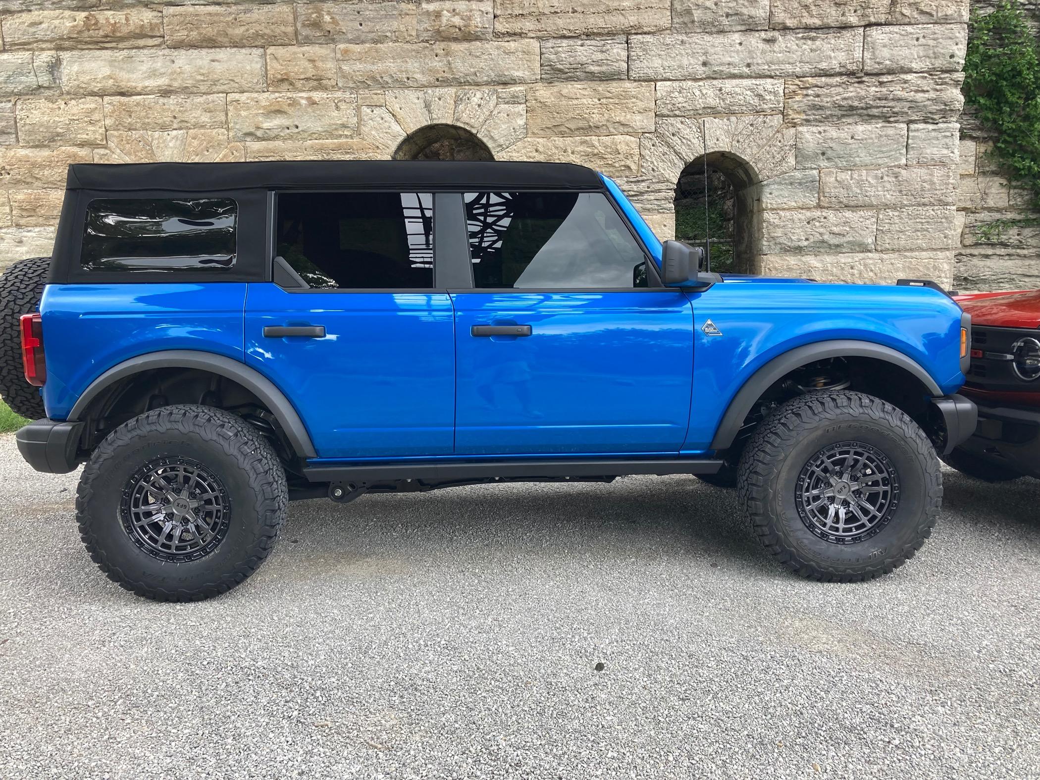

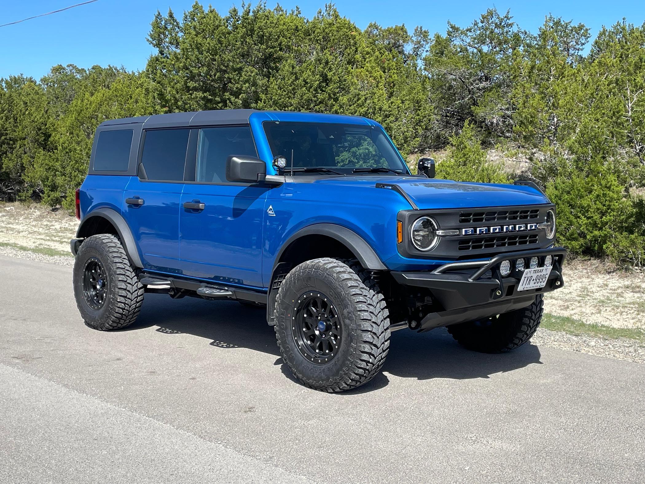

Pics are…Before, then 35” tires stock suspension, then last 2 with Eibachs. Love them by the way. Very cushy ride and plenty of height adjustability. Eibach has a chart that tells how much lift you’ll get out of the box. I turned my adjusters down allmost all the way.

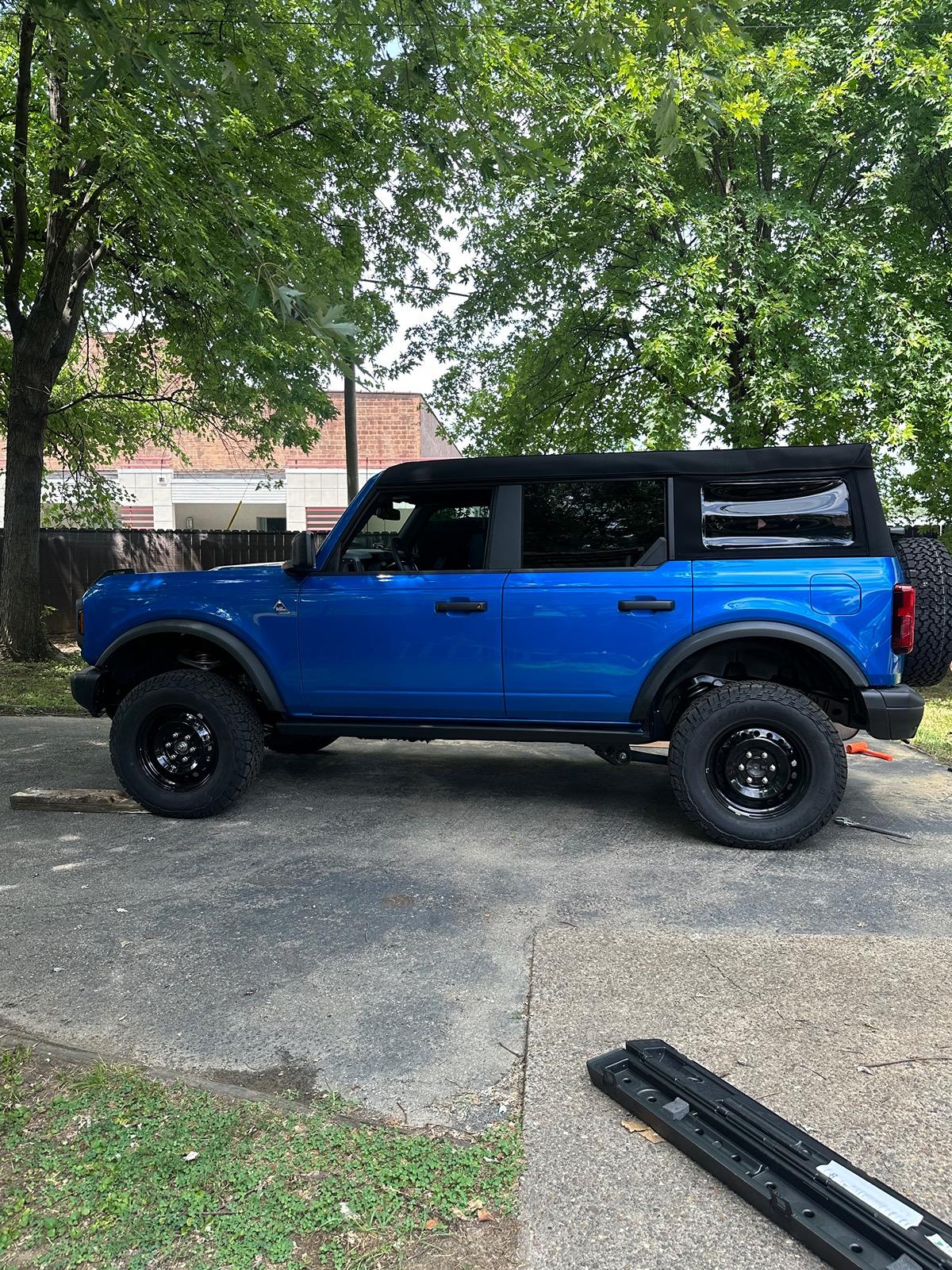

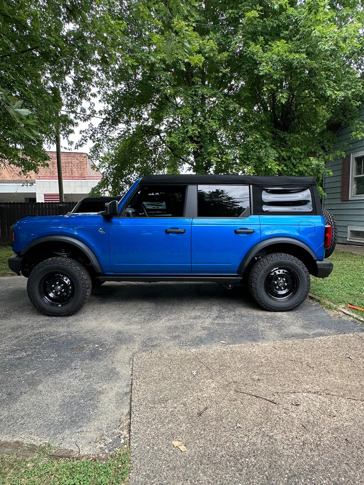

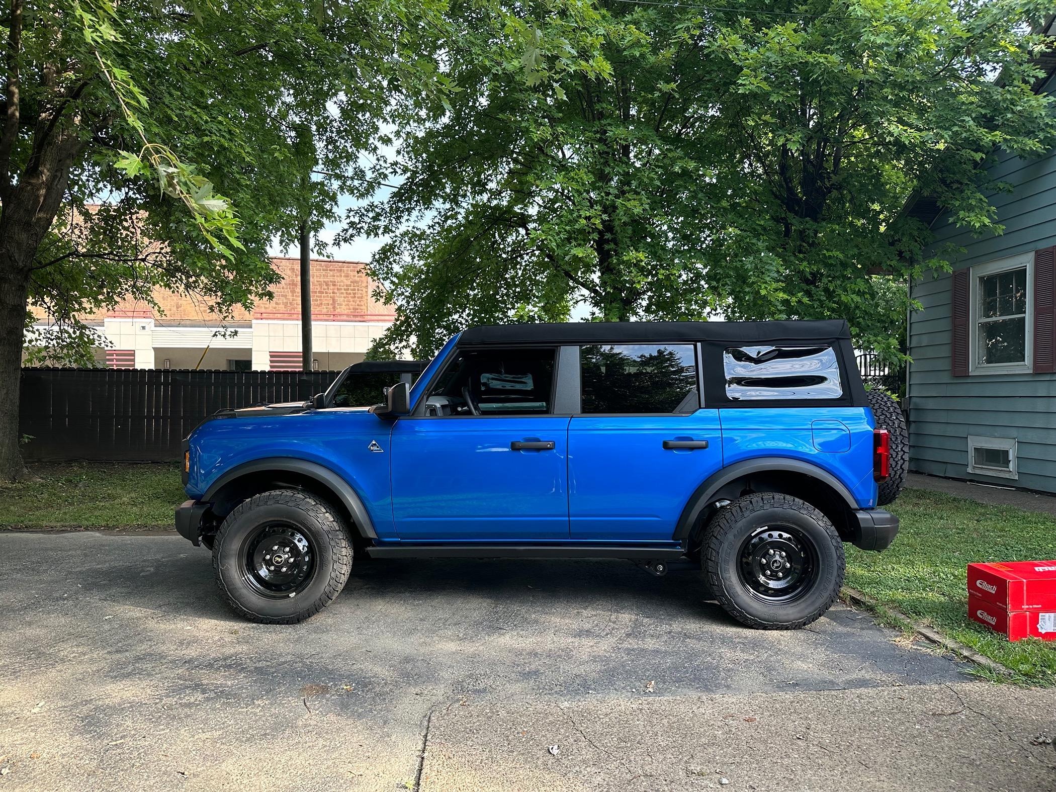

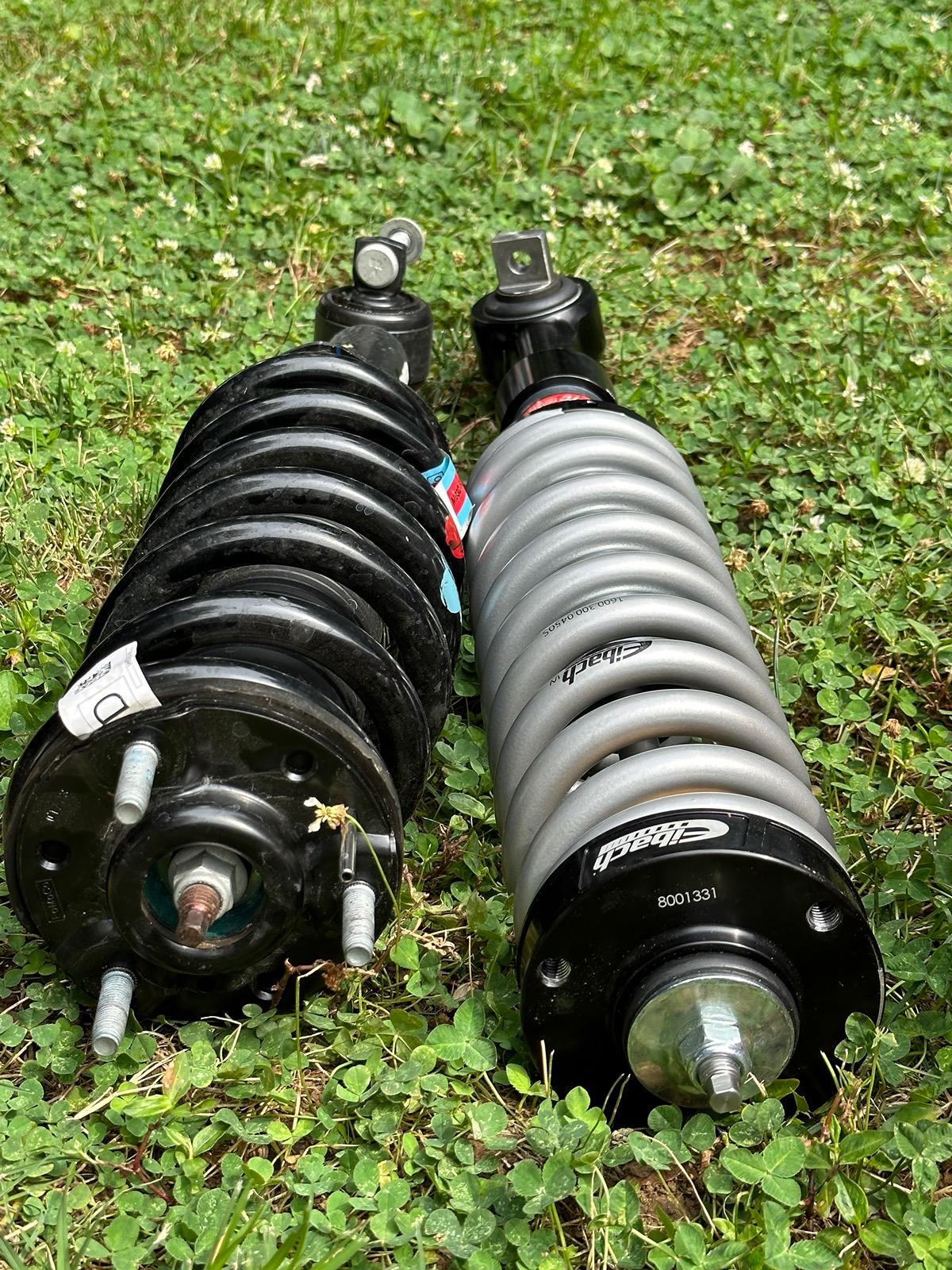

Installed some for a couple last summer on a black diamond. Final pic is him on 35s. Great coilovers. Drive it for a few days so it will settle then take it for an alignment job.
