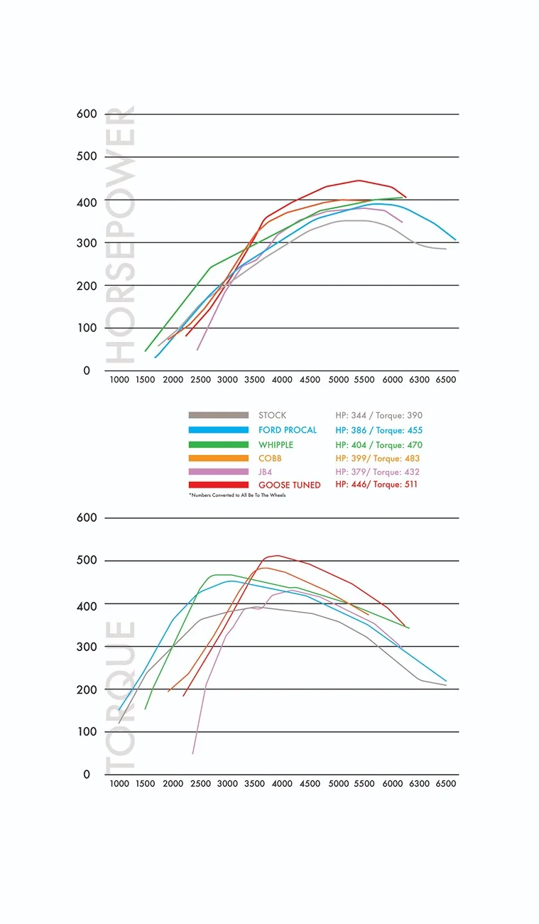

Overall: easiest and probably cheapest way to get +50hp to the wheels. Some small issues that they can easily fix, but overall I’m happy with it!
Here is a Facebook thread with a quick 2.5min video detailing as much as I can as quick as I can. Below is a chart I made that compares all the current plug and play tunes (as well as my Goose Tuned dyno results). All the data was pulled from their websites. I had to convert the Ford Tune to Wheel Horsepower to match (15% loss assumed).

Nice comparison for those on the fence, but you state in your post to the wheels, but on the chart is has an asterisk stating converted to at the crank. I assume your text is correct based on numbers but your chart may need a quick edit. Thanks for the info!

Good call! I was planning on converting them to the crank initially then realized only the FP Tune showed to the crank and swapped it to the wheels. Thanks for the heads up, I’ll fix that!

My persoanl preference is bottom end torque and amooth curve so I like the FP best.
