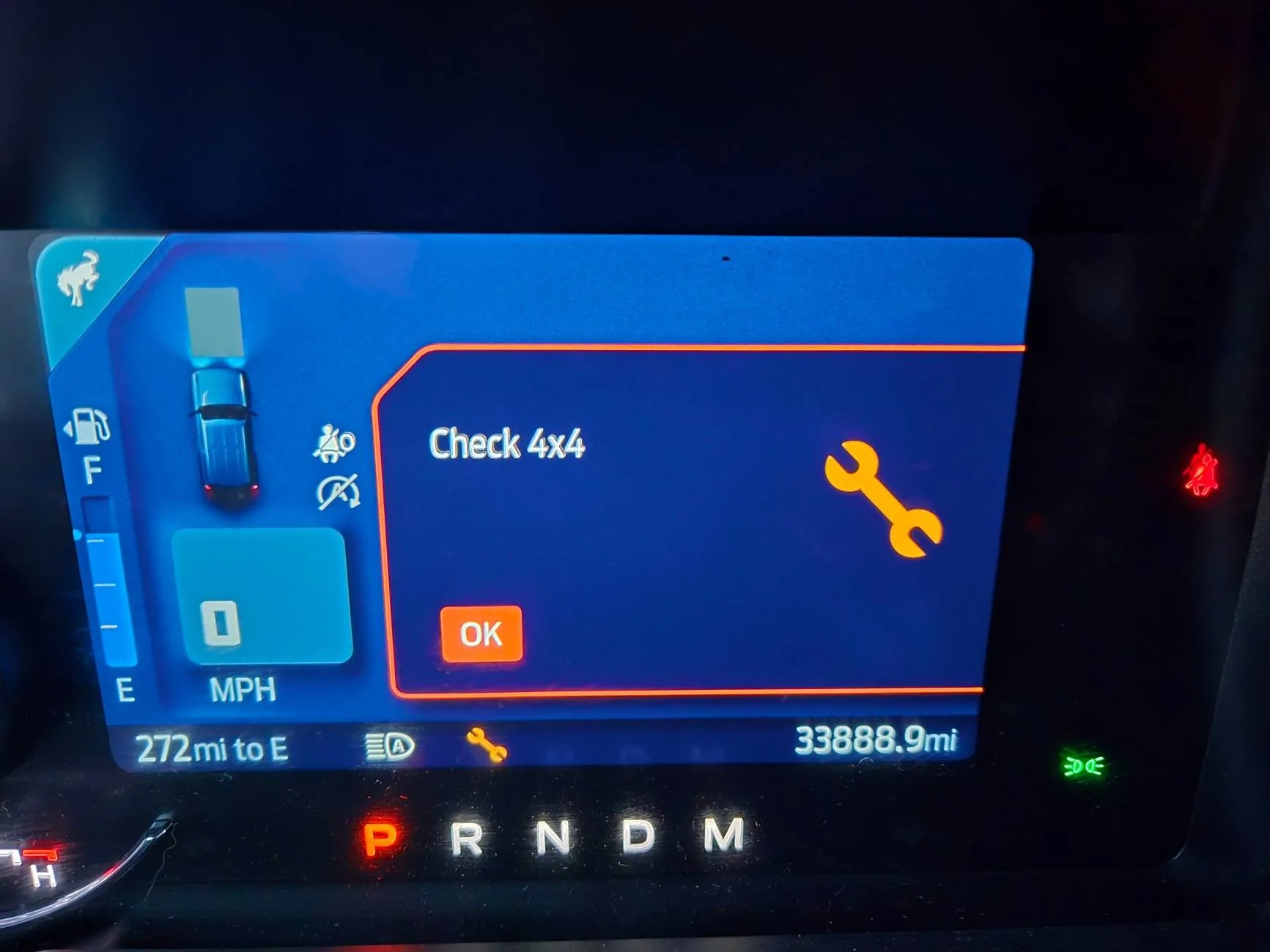

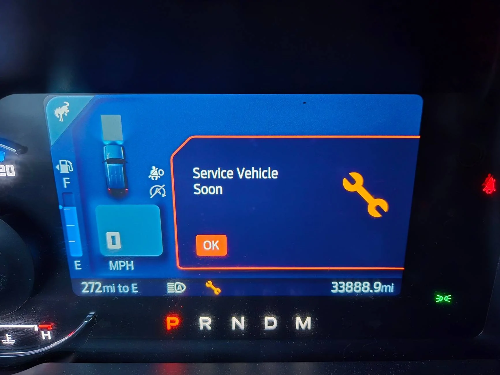

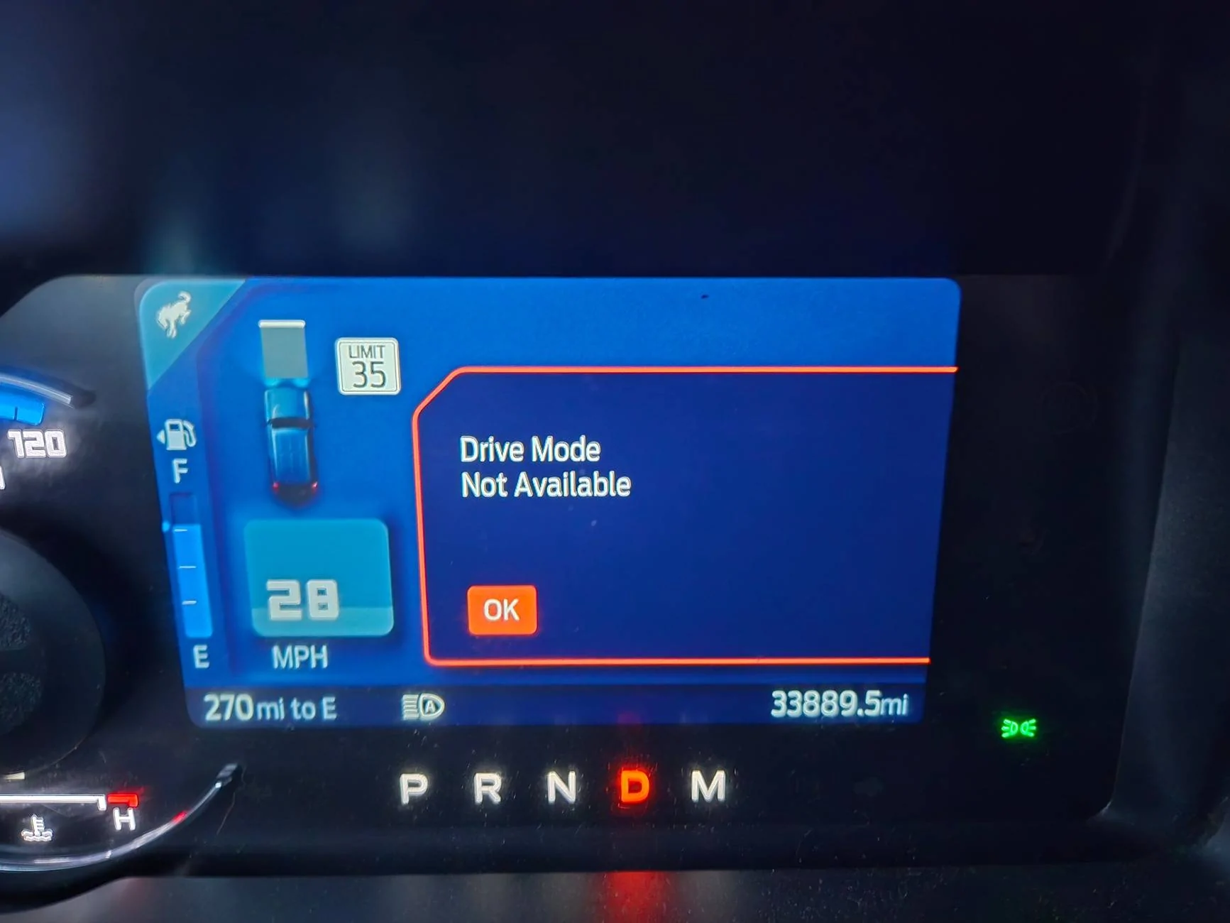

Hello, just in case someone else stumbles upon this thread for "Check 4x4" error, I've got 3 different errors: Check 4x4, Service Vehicle Soon, Drive Mode Not Available - due to: "the AWD module was left loose and it was periodically losing ground."

Honestly, the very first thing I do when I'm having any kind of issues is go around the entire vehicle to every exposed ground point and check for tightness. It sucks that the legacy of the older vehicle systems still has us run these extensive wiring harnesses and modules with so many connections that could flake out.
