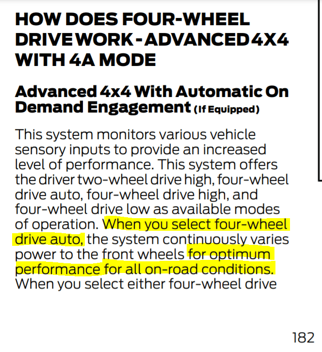

"I know it likely won't make a difference, but if you talk to the dealer again, ask in what conditions you'd use 4A. If they say it's only off-road or during slippery conditions, ask what then is the difference between 4A and 4H. I'm curious what the dealers answer would be."
Ford Bronco Updated: Check 4x4 warning alert - 4A 1641245685489
Point out page 182 to the dealer and inquire what "all on-road conditions" describes.
Myself, on dry roads, given the option I'd stick with the 2WD.
