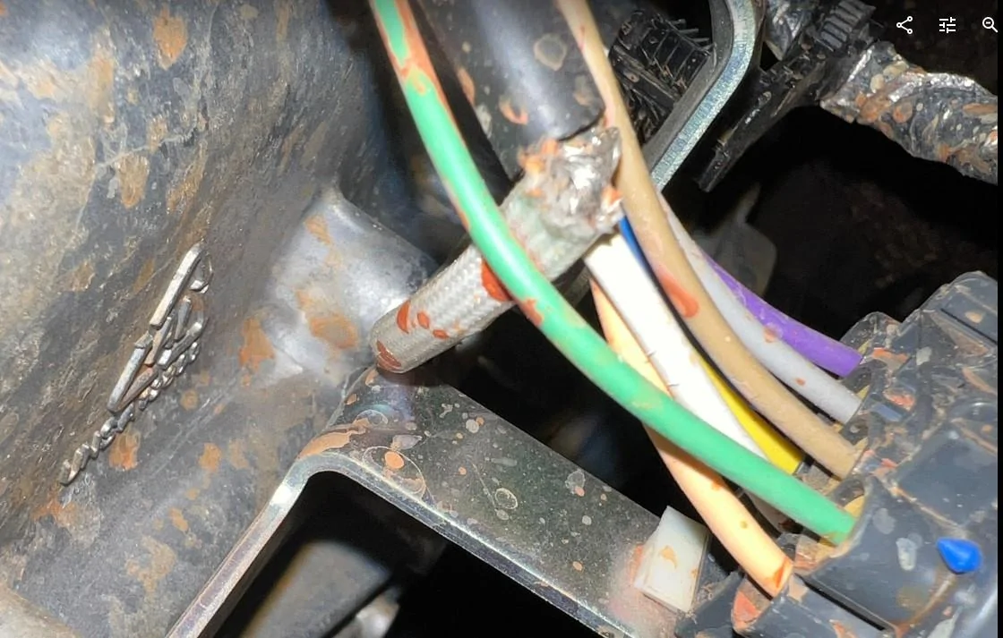

@mjp2 - See photo below. It looks like one of the wires at the transfer case has frayed and is exposed. I guess I am going to need to take it in. Is this similar to what you had? I am hoping it is an easy fix at the dealer.
Thanks for pointing me in the right direction.

Same place, slightly different issue. In mine the wires were bent at a harsh 90 degree turn immediately after the connector and I suspect there's a bad connection in there as a result. I straightened the wire bundle a bit and the error went away, which means I have a suspect connection and/or hidden wire break somewhere in there.
In the next <timeframe> I'll get under there and test/check each wire to see if I can identify the root cause. Of course, it'll be tedious, I'm lazy, and it's all currently working so we'll see when that actually happens. :)
Glad you were able to find something visibly identifiable to address!
