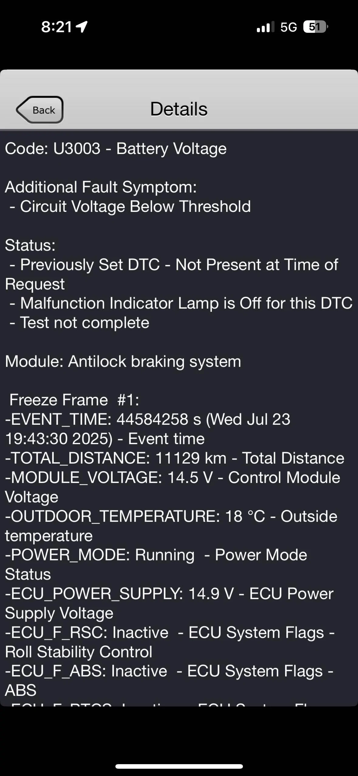

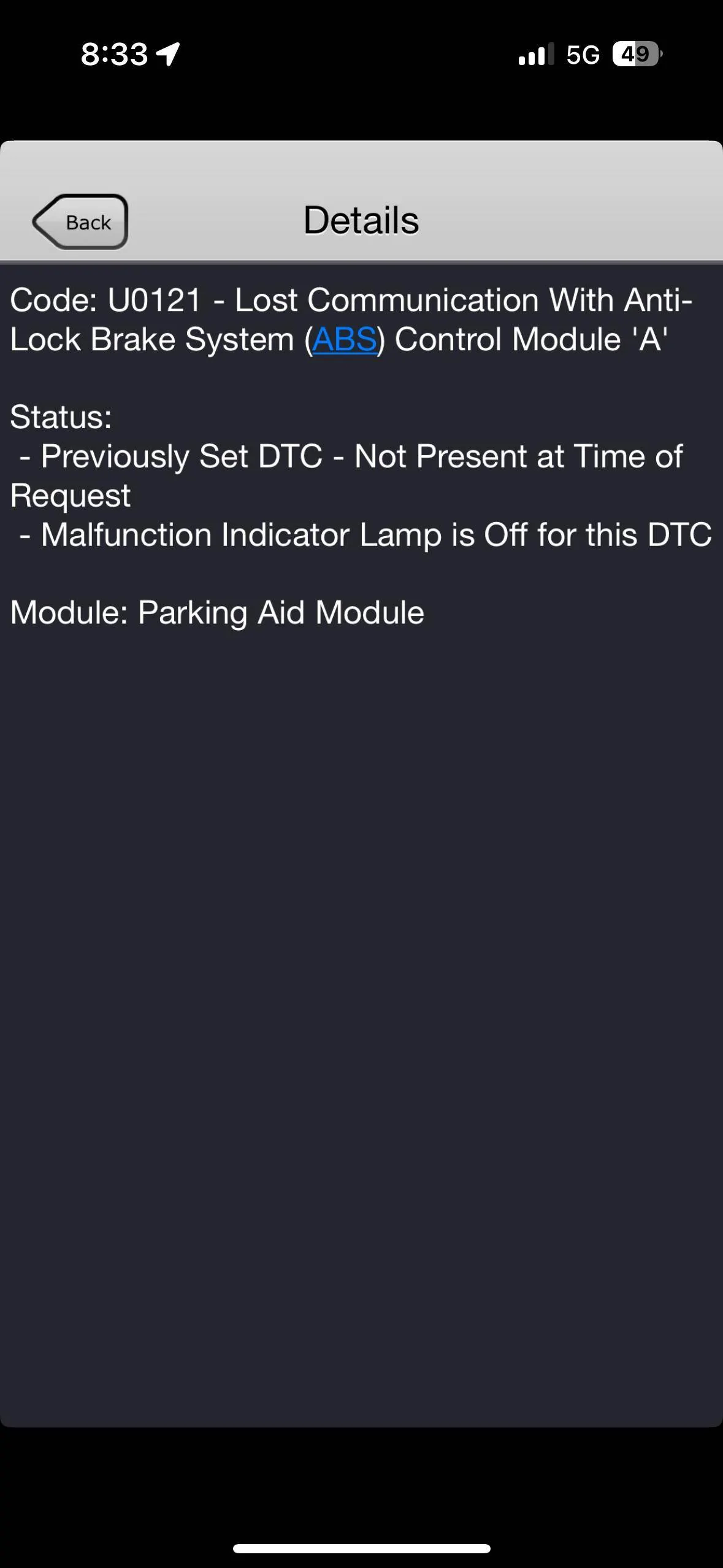

2024 Badsquatch. This started happening recently. Within about 5 minutes after startup (not immediately) I get two pop ups saying "charging system service soon" and check brake system". The brake light in the cluster comes on and stays on. This will go away if I shut it off and restart. These two pop messages sometimes come back the next ignition cycle and sometimes don't. I have ForScan and get the below codes. I can clear the codes, they do go away, but will come back next time I get the pop messages in the cluster. I am going to take to the dealer as it is under warranty but wanting to know first if this is a known issue. TSB out for this? Possible loose wire? Bad module? My battery voltage is fine, when the car has been sitting overnight and before starting I will have around 12.3 - 12.6 volts. Alternator is charging the system as I did a long trip over the weekend and it kept the system charged. Voltage in cluster while running is anywhere from about 13.5 - 15.0 volts. This all seems normal.

B11D9 - vehicle battery
U3003 - battery voltage
U0121 - lost comminication with ABS control module "A"
