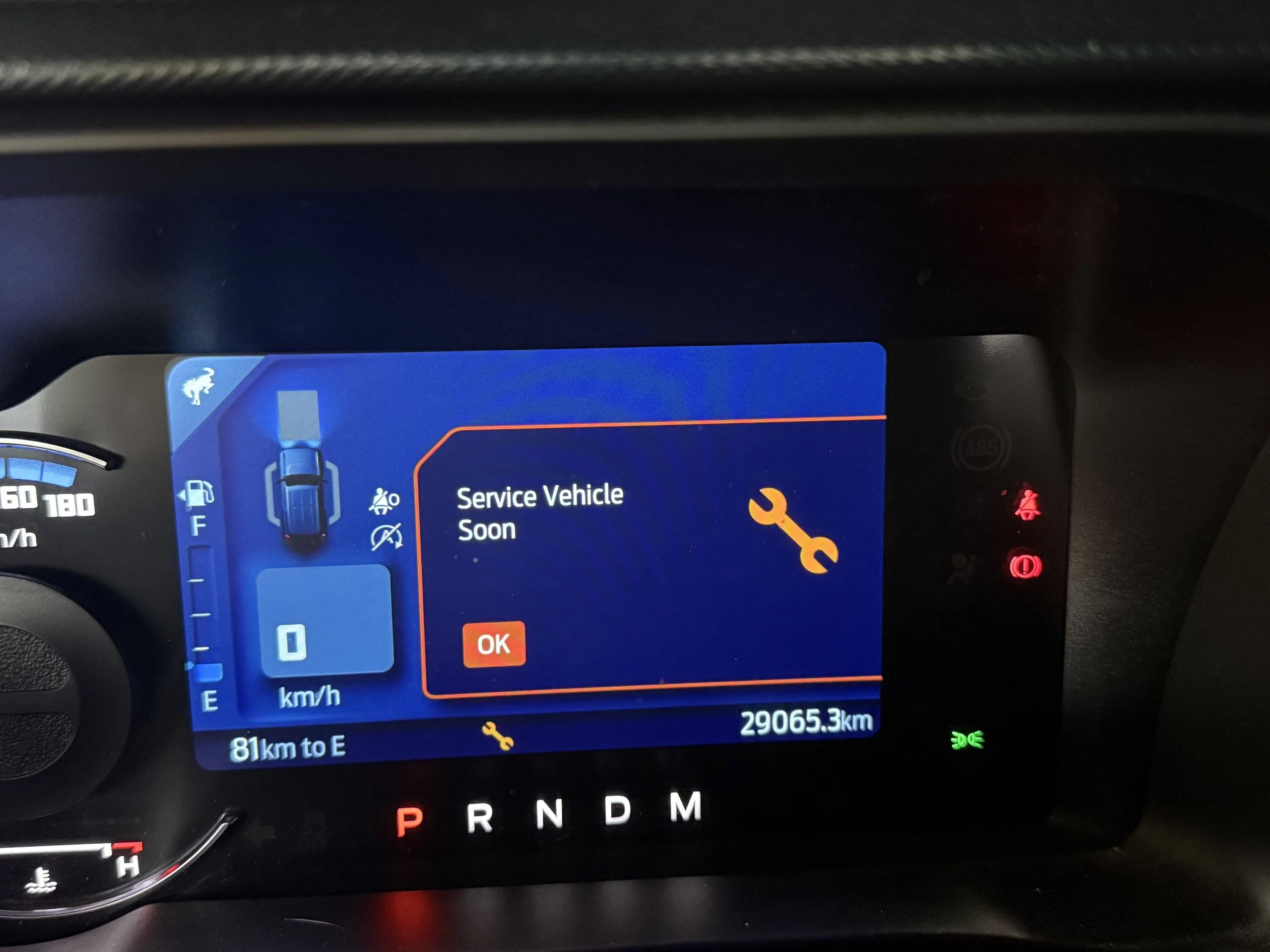

Saturday when I started the vehicle this message popped up.
It appears to be only a visual message as the vehicle does go into 4x4 high and 4x4 low.

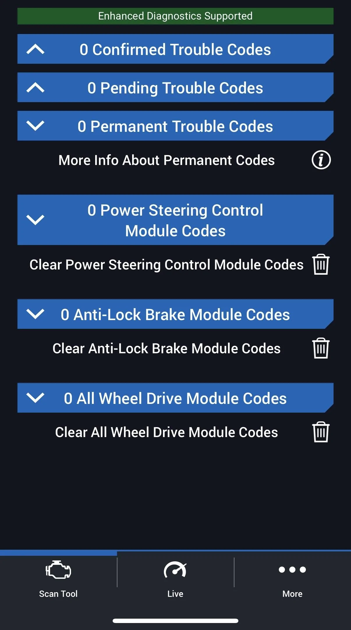

Ran a scan and there’s absolutely no codes to clear.
Pull the negative off the battery for 30 minutes put it back on, but the message still returns.
Anyone run into this before and if so, anyway, to clear it from the display?
I’ve driven 600 km since this happened and it doesn’t affect the vehicle whatsoever.
appreciate any input.
The vehicle has never been off road.
as a matter of fact, it’s only been in 4x4 high once last December.

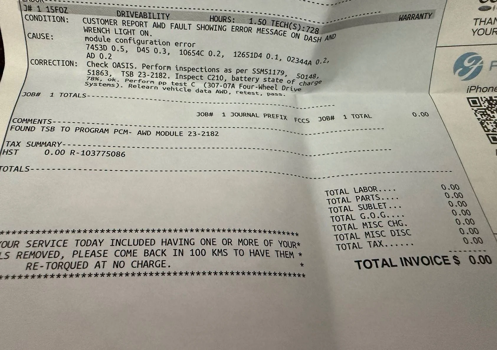

Whatever you're using to pull the codes likely can't read the one it set.
If you send me your VIN I can look at VHR and see what it shows.

Thanks.
Sent

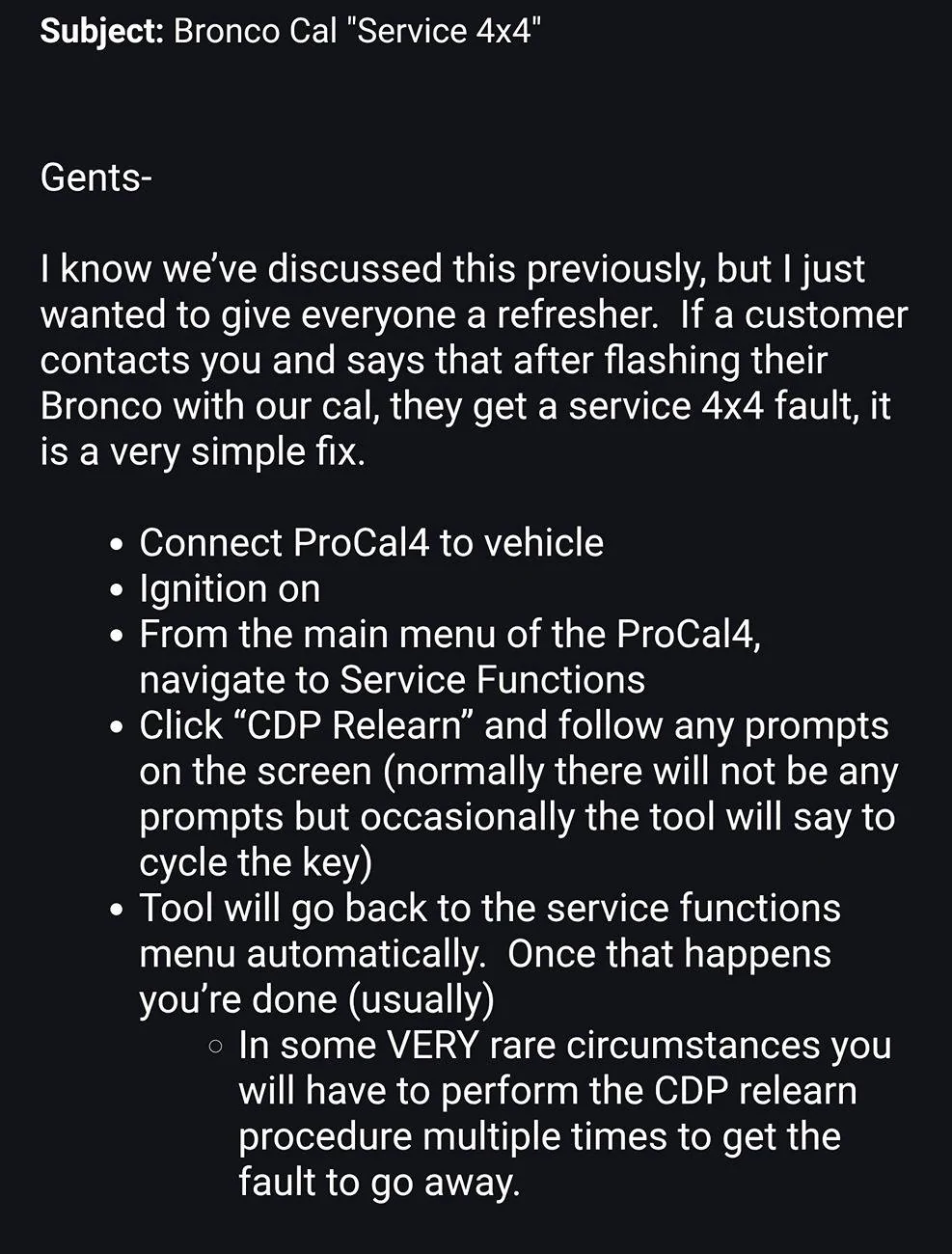

When I did my lift and bigger tires I changed the size in procal tuner and next day I got the same errors.
I emailed FPP CS and they gave me this which fixed issue
Wasn't a procal, but I will attempt to get the unit back and maybe set them back to default size.

Update:
Huge thanks to @Ducati1098
He ran the VIN and found a TSB for the issue.
Dealer cleared the code today under powertrain warranty.
It was from the tire size change we did last year.
They were able to see it.
Why it popped up now, is unknown.
We had the battery disconnected for an hour last week to install the Form taillights.
Perhaps that tripped it. Ford electronics, Always a mystery.
For everyone who posted suggestions, really appreciate the help.
