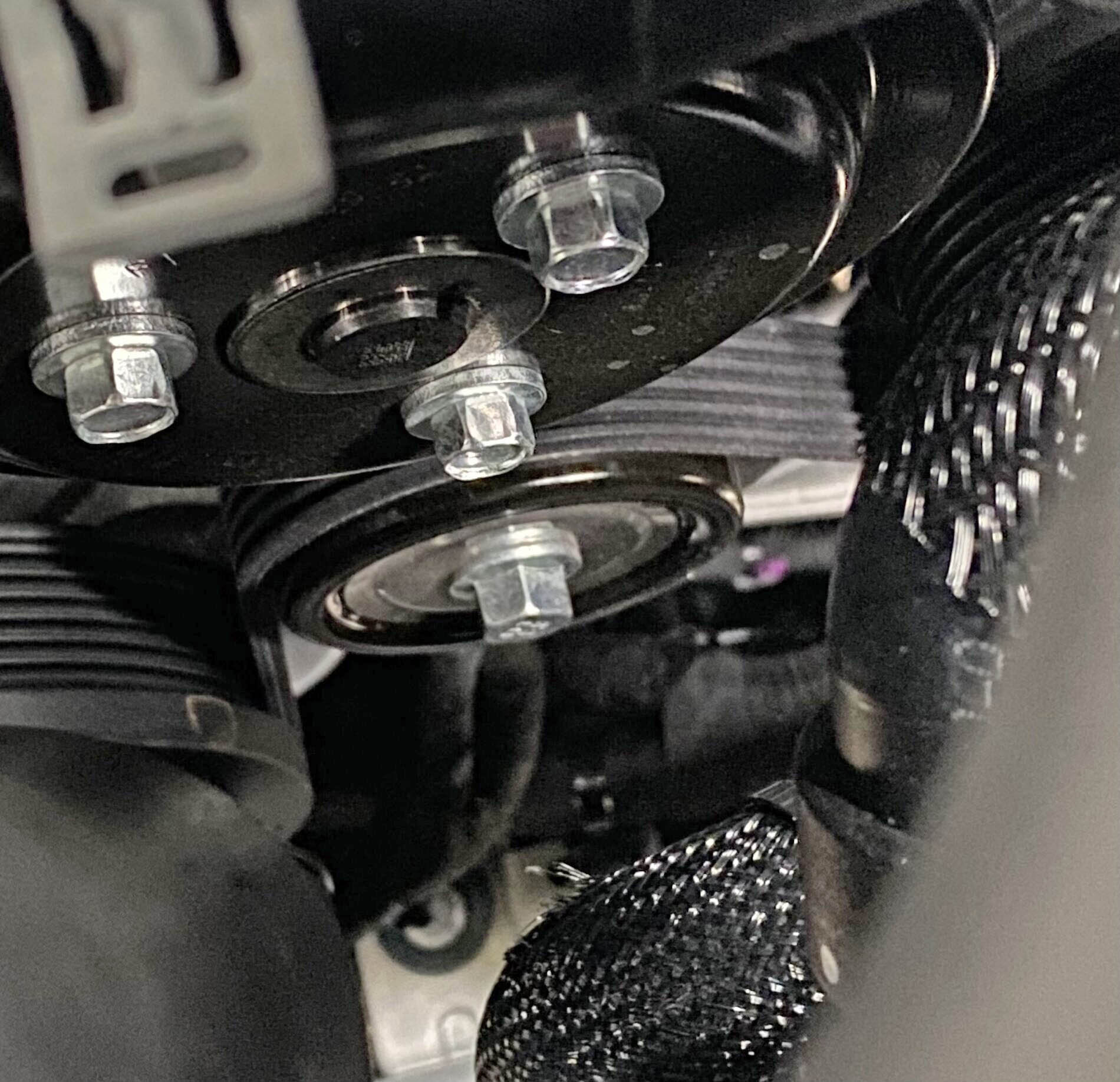

Update: this issue is what caused the coolant leak and stranded Bronco at this thread:
Just got the Bronco delivered today. After reading stories about coolant leaks, I decided to take a look and see if there were any issues. I found that a nut on a pulley was contacting the coolant hose. It had chewed through the nylon weave protecting the hose and started to work into the rubber hose. This was only after 32 miles! I gave it the quick zip tie fix as mentioned in other posts. Seems ok now and will follow up as part of the first service.
Posting this for other 2.7L owners. Pls do a quick check. A $0.25 cent zip tie may save u! Here is a pic (after the zip tie fix), u can see the mesh on the hose is frayed, the nut closest was the culprit.

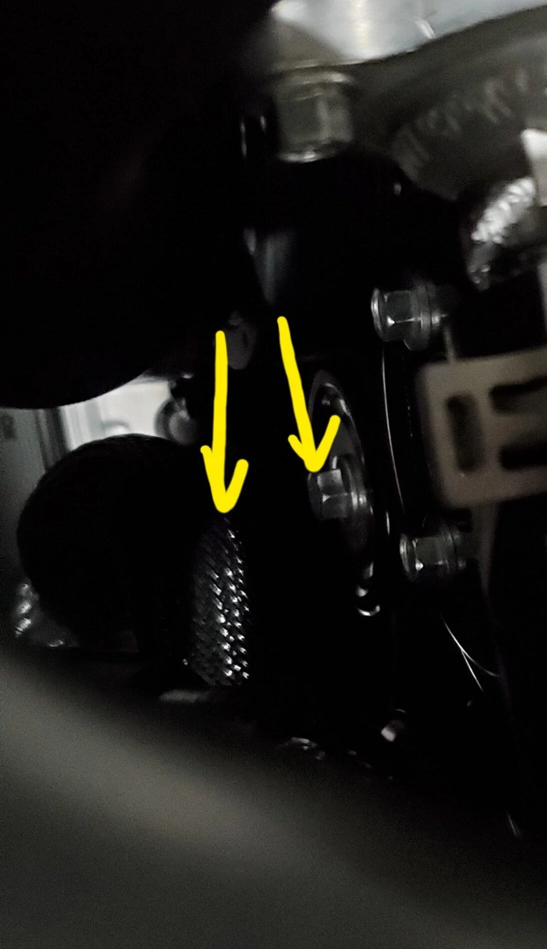

The idler pulley seems to be most common but in my case it was rubbing the center of the A/C pulley. This picture is taken from above the radiator looking straight down at the A/C pulley. Hope that helps.
Ford Bronco PSA for 2.7 engine: check belt pulley nut for contact with coolant hose PXL_20211022_192717130.MP

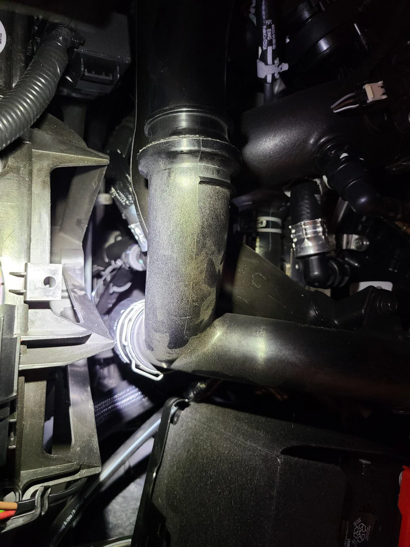

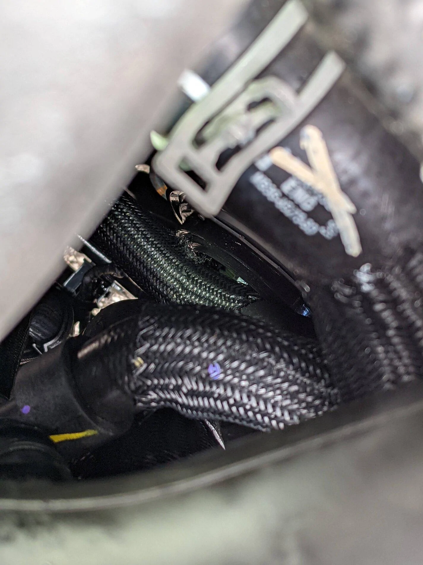

Zip tie repair complete! Mine was not touching but it was very very close. I'm not sure if mine was in the exact same place or not. Here are pictures for my location. It appears that there are already manufacturers clips in there holding hoses to one another, either way an additional one can't hurt. Also after extreme visual scrutiny I noticed my AC return line has wire loom around it and was contacting the engine and was slightly melted, no damage really but a very slight pressure adjustment on that hose fixed that issue as well moved it maybe 1/4".
Ford Bronco PSA for 2.7 engine: check belt pulley nut for contact with coolant hose 20211022_210531
Ford Bronco PSA for 2.7 engine: check belt pulley nut for contact with coolant hose 20211022_210554

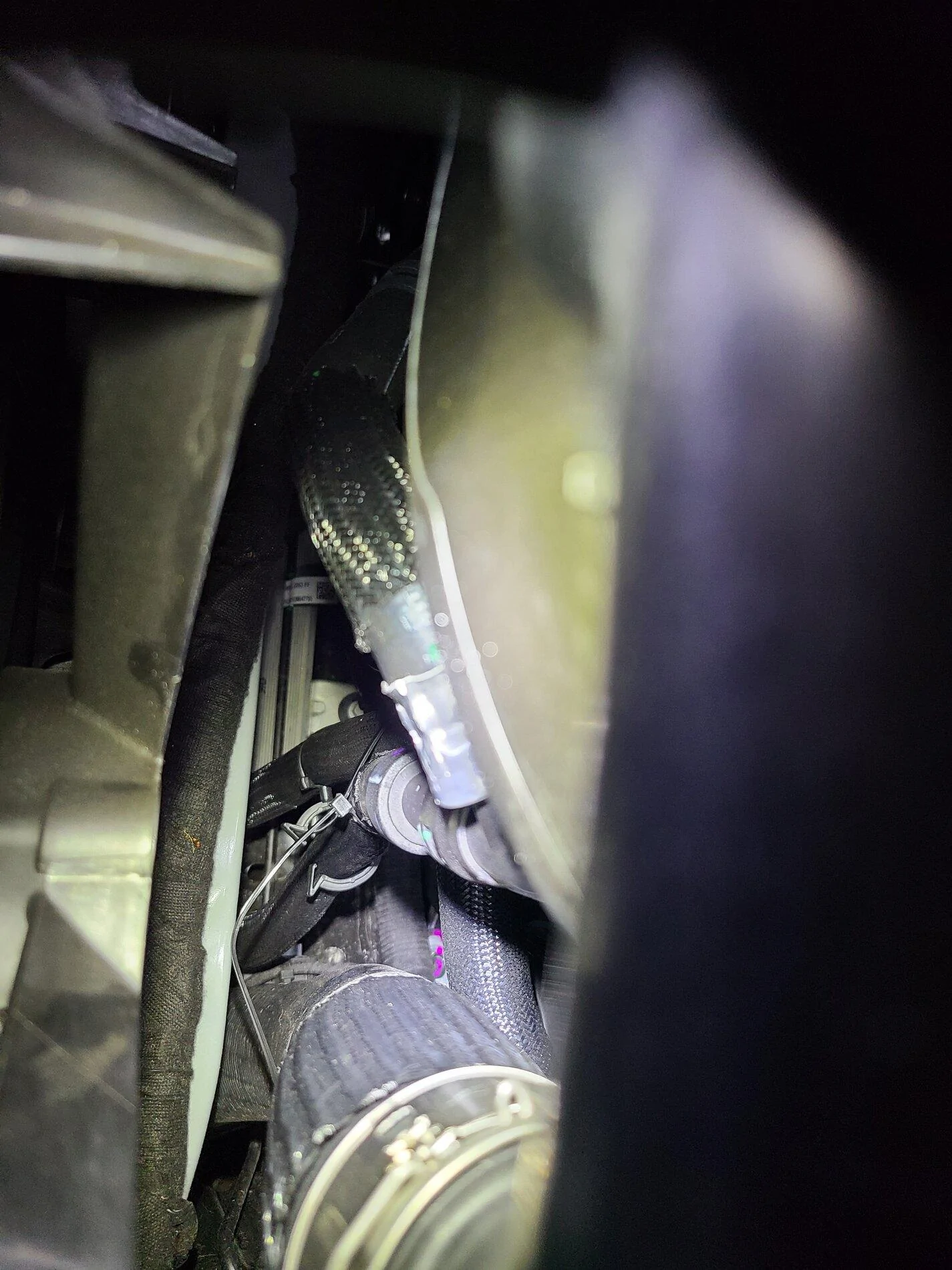

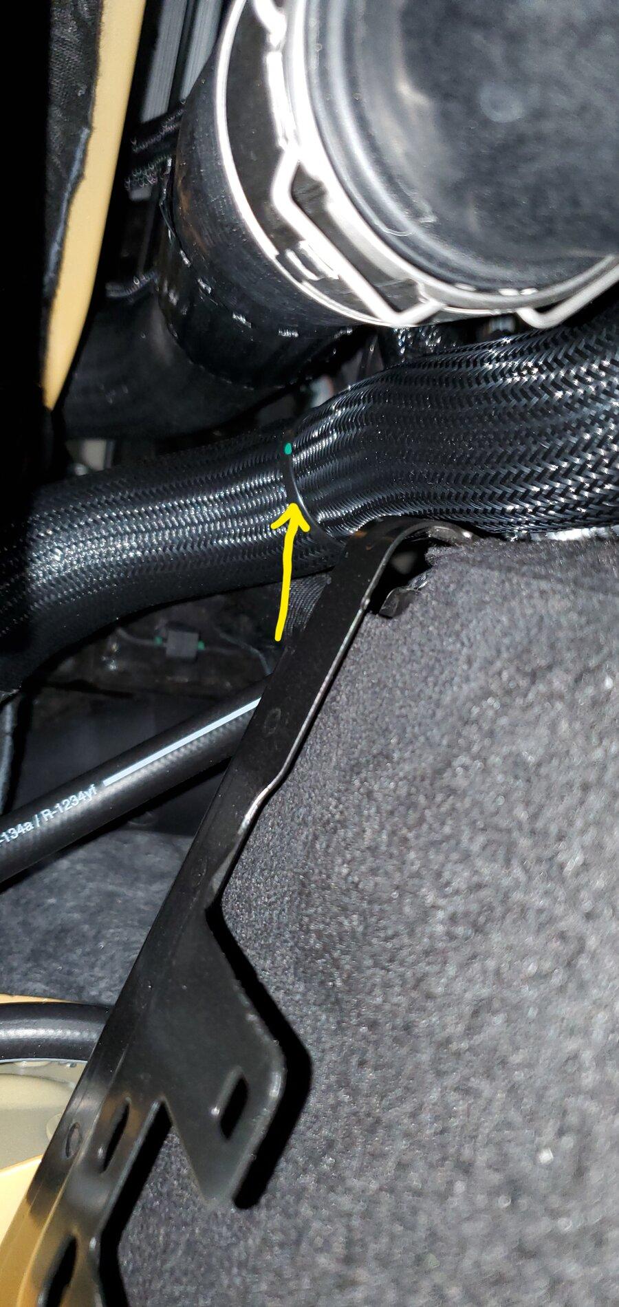

Looks like my 9/13 build OBX already has this fix, thankfully. Hose is not near the pulley (pic 1), and there is a zip tie holding the hose back (pic 2). Another zip tie may be in order, however.
Ford Bronco PSA for 2.7 engine: check belt pulley nut for contact with coolant hose 20211022_230938
Ford Bronco PSA for 2.7 engine: check belt pulley nut for contact with coolant hose 20211022_231001
