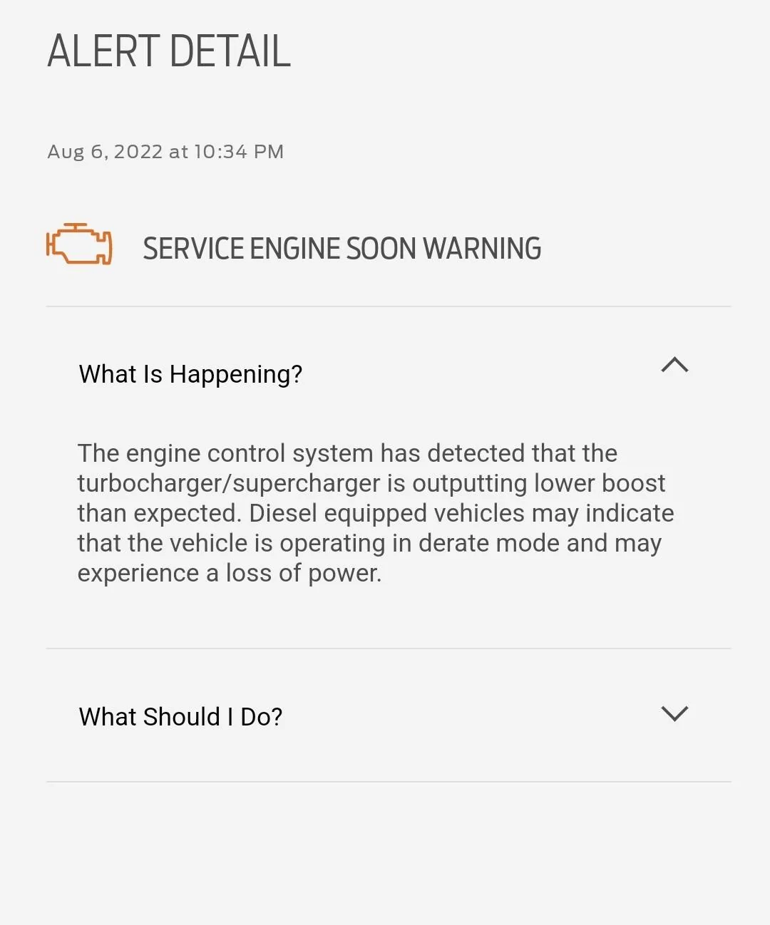

I just installed the K&N Air Intake on my badlands, 2.7. I took it on a quick run and had no issues. Second drive, I got a Service Engine Soon notice on the dash. Only have 200 miles on the beast... I've double checked all the connections and everything is good. Has anyone else had this?

Okay ladies and gentlemen, I finally figured it out... I tried to clear the code but it just came back... After much searching and head banging, I found that one of the clamps wasn't threading/gripping properly. So the clamp wasn't tightening around the hose properly. The tightening screw was skipping when it got to a certain level of tightness - if that makes any sense... So the clamp appeared to be tight and it felt tight, but when under pressure from the turbo, it allowed air to escape. Apparently, enough air escaped that the computer measured the differential and threw a code...
I replaced the bad hose clamp, cleared the codes, and now everything is right with the world. She runs beautifully, I have no codes, and my butt dyno says it has more power.

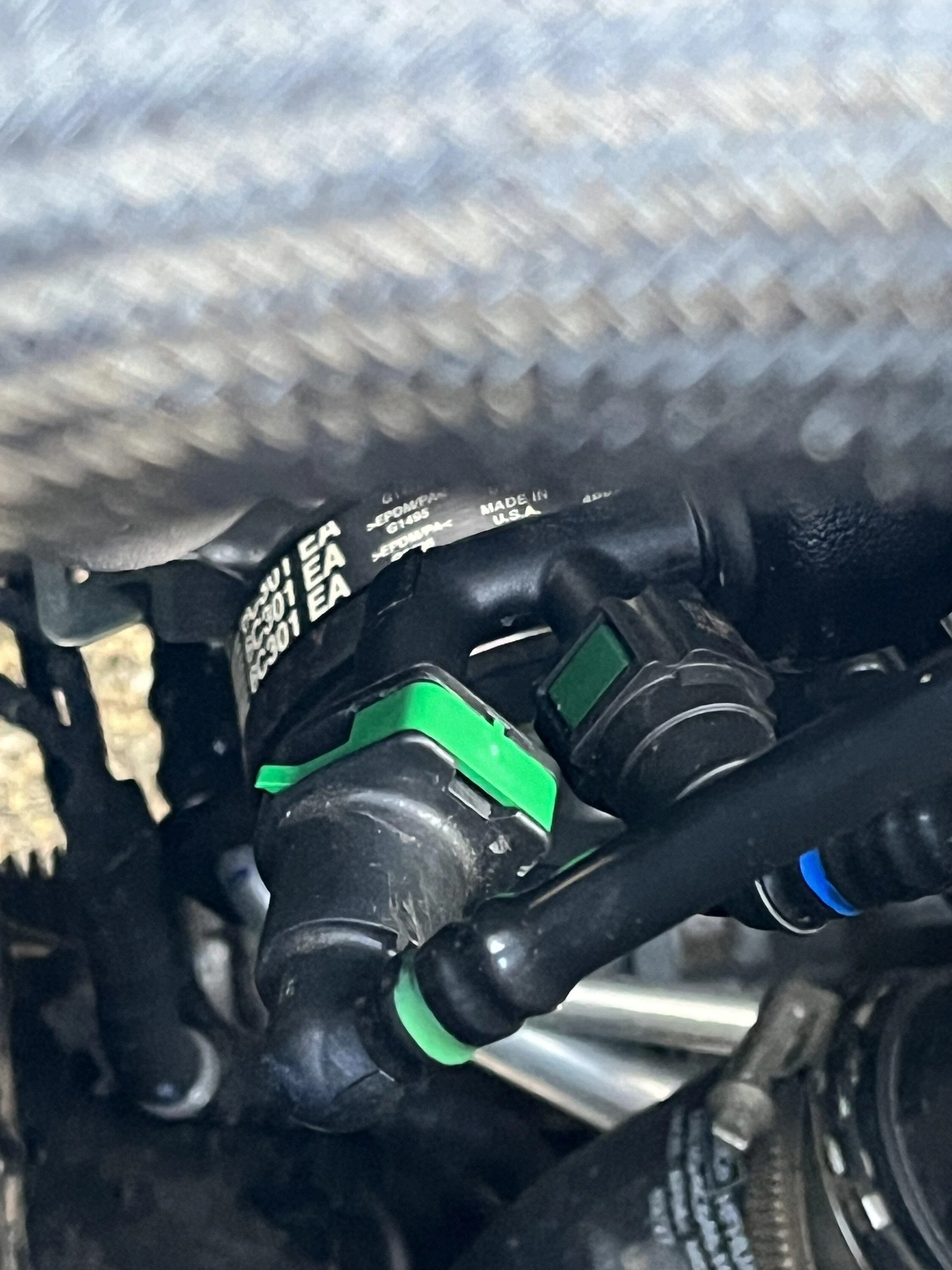

I put in a K&N 63-2620 Aircharger Performance Intake in my 2.3L and a week after less then 200 miles the check engine light came on. Check the lines and everything was tight. But then I saw that the ejector fitting was broken right at the elbow where it bends. I’ve contacted K&N and motoroso, who I got it from, to see if I can get a replacement for the fitting. Or what else can be done. I watched some videos and people mentioned that this fitting is way too fragile

Another guy on here mentioned that he cracked a fitting unbeknownst to him and only found it after digging in deep. So that's another possible cause... Either way, the K&N definitely does not cause codes if it's installed properly and everything is tight.
