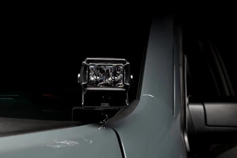

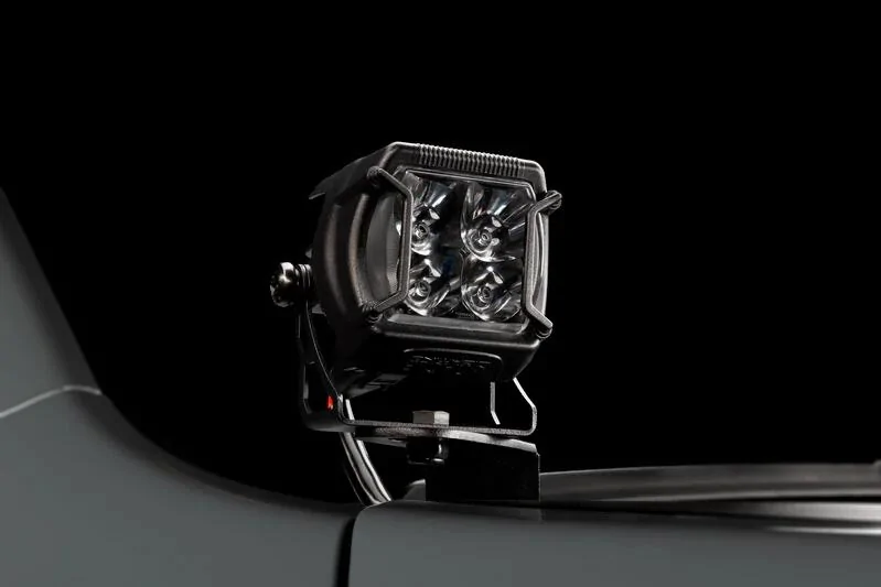

LIGHT UP YOUR ADVENTURE WITH ORACLE !
Please, don't forget about our affordable, industry leading lighting products.
ORACLE LIGHTING VEGA™ SERIES LED LIGHT POD SPOTLIGHTS (PAIR)
Ford Bronco Cheap vs. Expensive Lights 1721247427202-5a
Ford Bronco Cheap vs. Expensive Lights 1721247471296-w1
ORACLE Part Numbers:
5921-2-001 - VEGA 20W Series 2
5921-4-001 - VEGA 40W Series 4
PLEASE USE CODE JEFF15FORUM TO SAVE 15 %
(STARTING PRICE OF $143 - NOW THAT'S LOVE ;0)

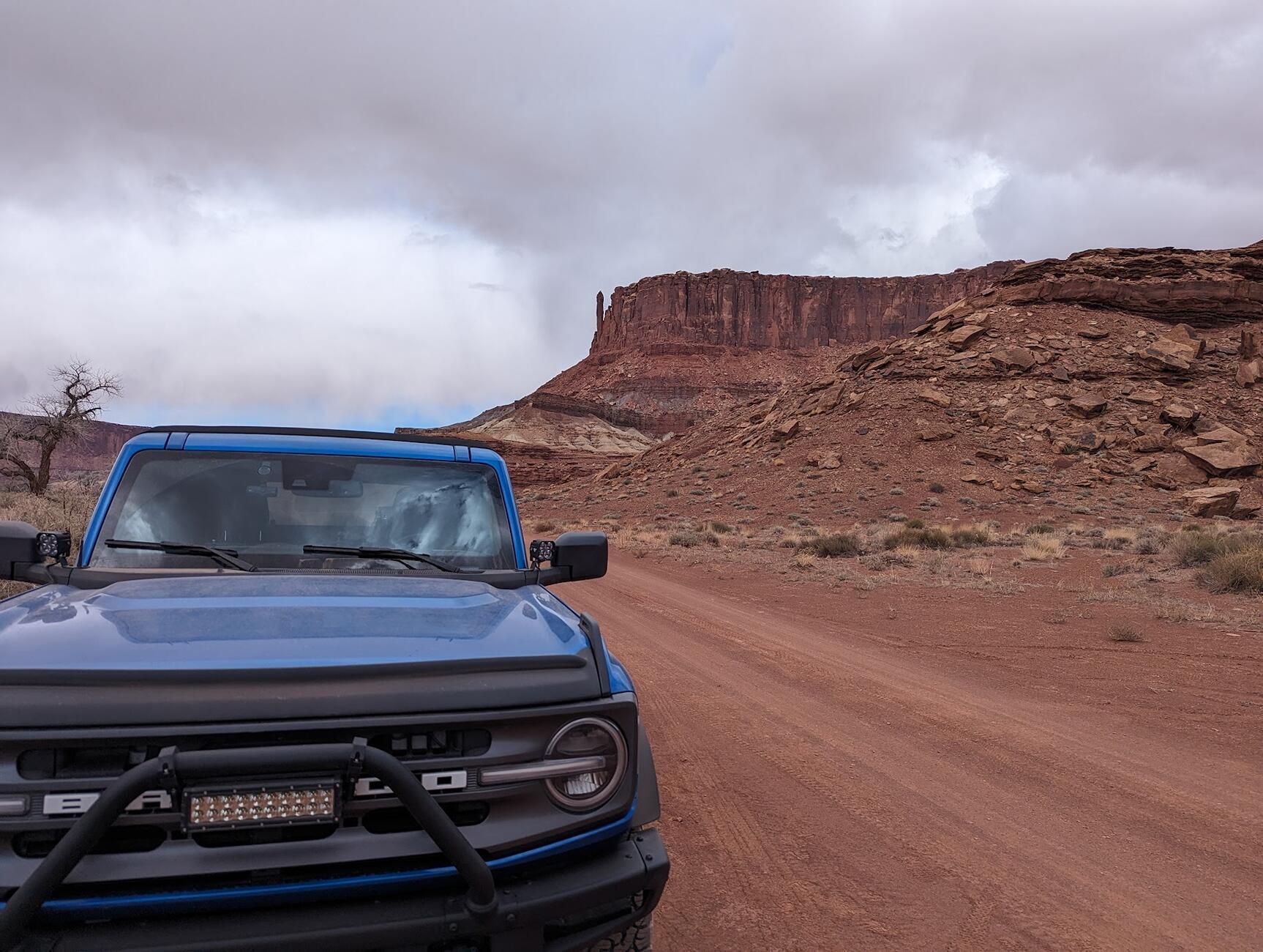

This is why I avoided the Chinesium lights, or the American lights (also usually made in china), and went with the Aussie-made ones:
Ford Bronco Cheap vs. Expensive Lights 1721249792777-ev
Nearly 3 years into the main light and ditch lights, and no yellowing, no dead leds, housing still looks new too. My truck is not garage kept, and sits in the Arizona UV all day, and no age-related issues.

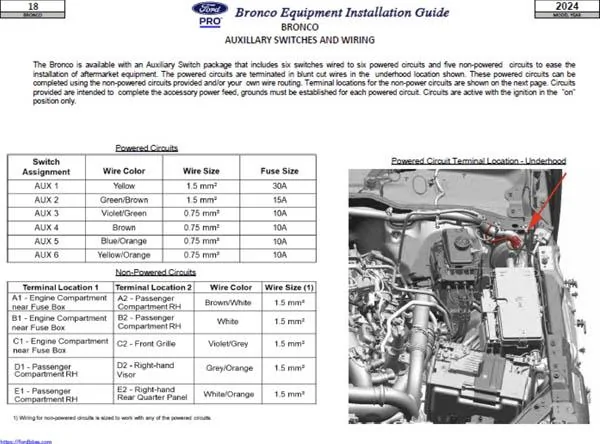

Remember too that the Aux Switches 1&2 are wired with 16ga wiring which should limit you to 10A, but Ford fused them at 30 and 15 Amp. Aux Switches 3-6 are 18ga and fused at 10amps so you want something with half those amps.
Check the wattage of what lights you are installing if you plan to use the Aux Switches. Sometimes you might need to pay for higher efficiency CREO LED's to reduce the wattage draw. 🤷‍♂️

Anything that is "Made in the USA" is nto made in China...
Diode Dynamics for example makes their products in the USA. They make their own circuit boards and all that jazz.. They DO use LED chips from overseas... but so does ARB and other Australian brands. Because pretty much all LED diodes are Made in Germany and China.

Most of the lights come with heavy guage wire and relays. All the amperage comes straight from the battery. All the switches do is trigger the relays.

IF you wired it in that way, then absolutely and that is exactly how I would wire in a 50” roof light bar. However, the “typical ditch” lights are low enough amperage to be wired directly through the Aux Switch without the need for relays or tapping the positive wire (still need a ground).
