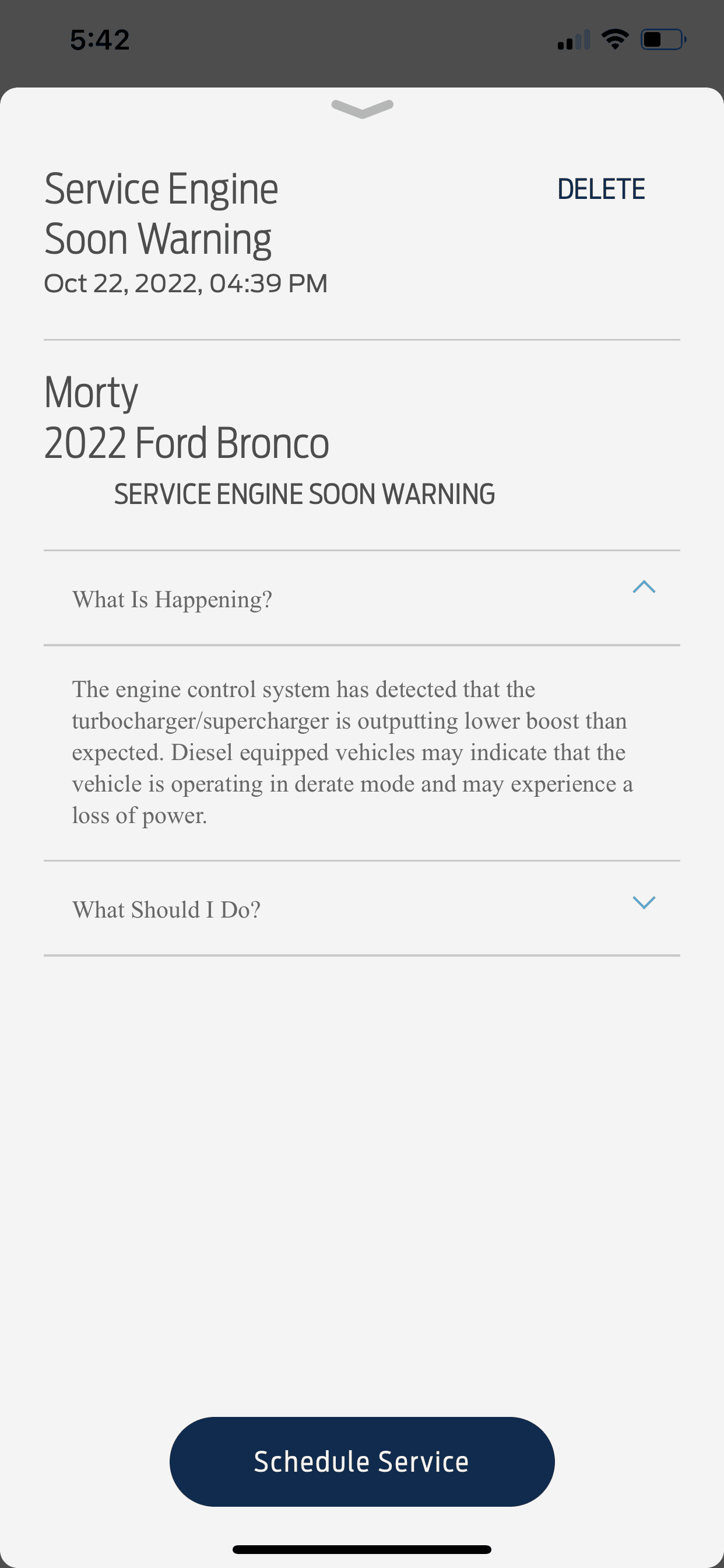

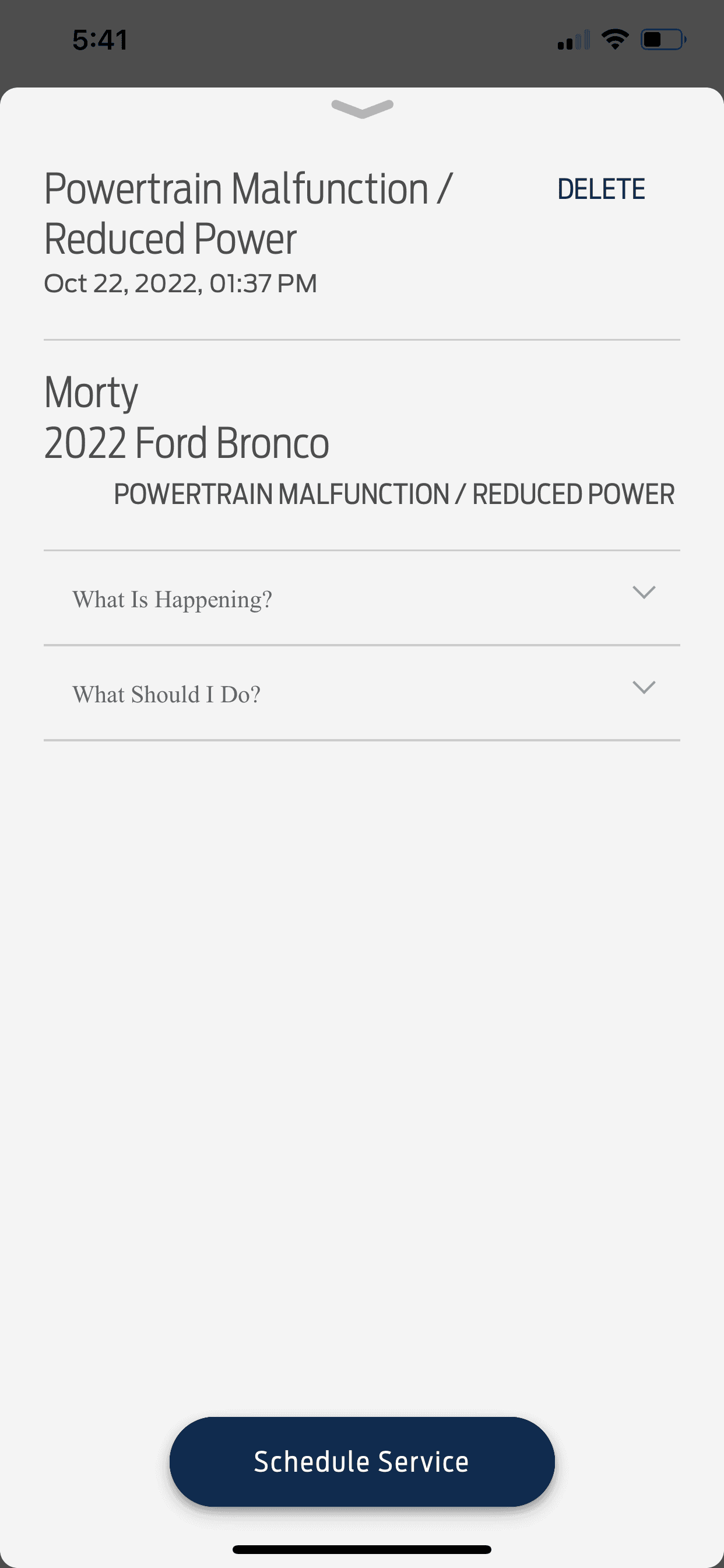

Here are the messages I got through the app
Would be helpful to know the actual code. It's important to understand the computer's failure mode. It's clearly capable of producing boost, but when it detects a boost level outside of what it considers normal it will go into a sort of "limp" mode, and limit boost intentionally. I doubt charge pipes alone would cause the boost to fall outside parameters, however VERY small leaks, can sometimes set it off (like a cut oring on the intercooler connections). If you don't have a code reader, most autozone stores will read the code for you.
