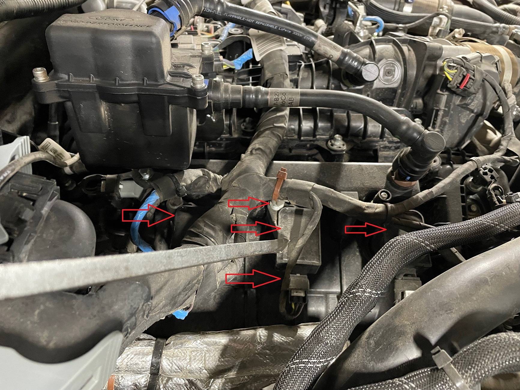

So, I have a 2.7 and recently ordered the "gapped" plugs from Panda Motorworks :) (hoping to get better fuel economy.....)
Anyways, I keep getting labor quotes that are insane....Does anyone know of a step-by-step video that exists anywhere to show me how to do this? I do have the "magnetic" spark plug tool to secure it properly and also a TQ wrench. I just need a guide.....to make sure I get past all that wiring and connectors that area ll over the top of the engine.

Now you did it. You made me go out into the cold garage :sneaky: First picture shows a big screwdriver pointing to the center coil pack middle red arrow as well. It shows the connection you will need to unplug bottom center arrow. It shows the nut/ stud you will need to remove top center arrow. once unplugged & nut/ stud removed pull the coil pack up & out and you will see the spark plug. Left & right arrows show location of the other two. Rinse & repeat.
Ford Bronco Changing Spark Plugs...... passenger coil pakcs
Screwdriver & arrow point to center coil pack. same procedure. Hard to see in this picture but there are 2 more 1 left one right. With the other videos you should be able to get the idea. HTH 🤠
Ford Bronco Changing Spark Plugs...... driver coil packs
hahahahahaha!!!! Youre the best bro!!! :)
