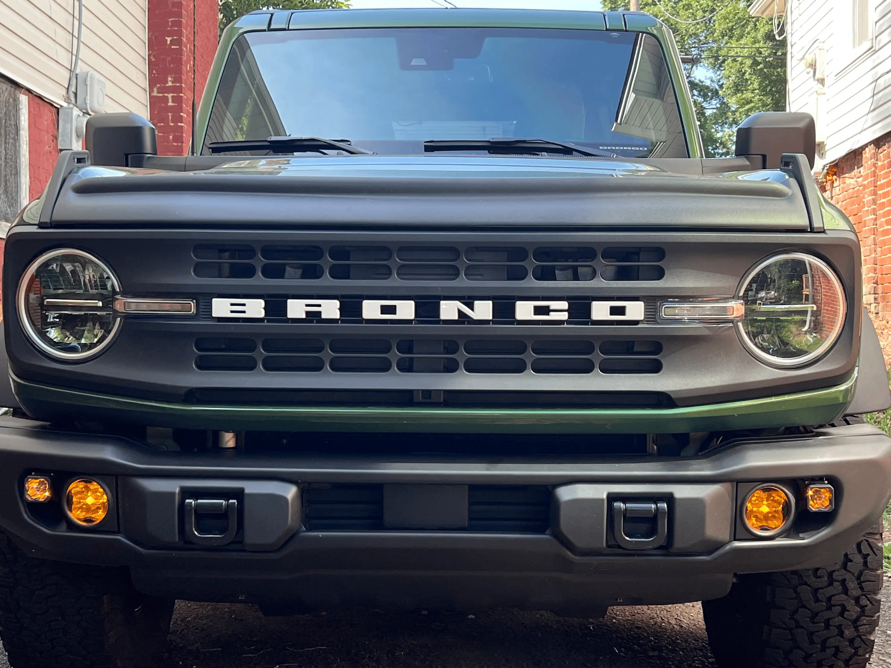

Yeah I got white. I Like running them most of the time at night just for a little extra all around brightness and the ssc2’s already on the pillars are yellow. I know it probably doesn’t make the most functional sense, but I like how it looks. Plus I may eventually do what you did with the ssc1’s , but in yellow. So between the yellow ssc2 and ssc1’s I’ll have my yellow all covered! I’ll update once I adjust them. Probably wont have time until at least the weekend though.

These are my SS3's and SC1's with the amber backlight on.

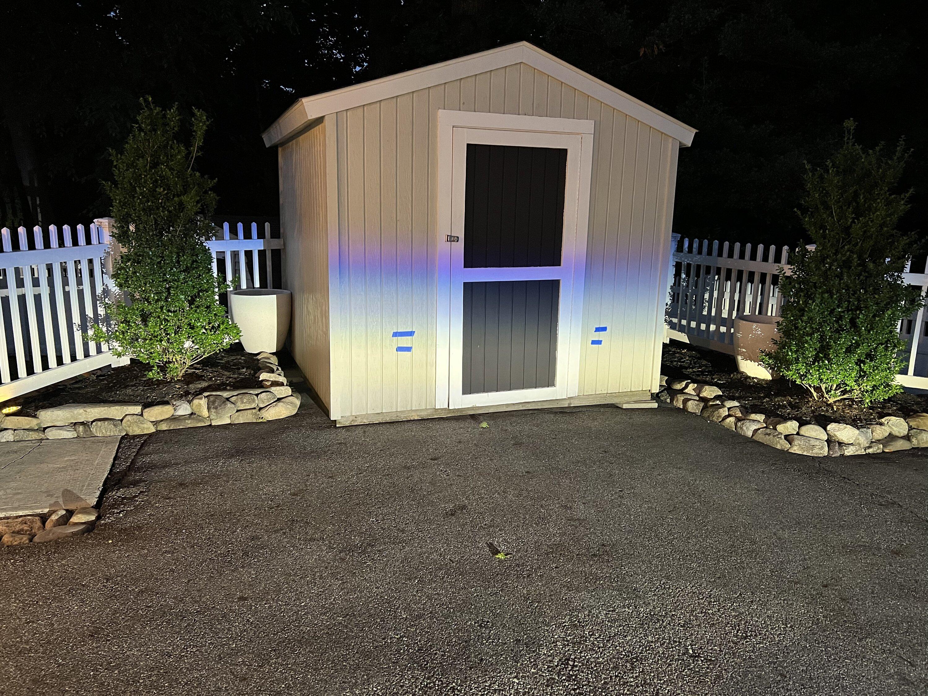

Little update on my elites. I went to finally adjust them last night and realized one of the lamps was faulty. It shines bright, but the beam pattern was wrong and unfocused. Good news is, Diode responded to my email about it right away and are sending me a replacement. Very happy with the quick assistance. Down side is I wont have it until sometime in August since they are now backordered, but no big deal.

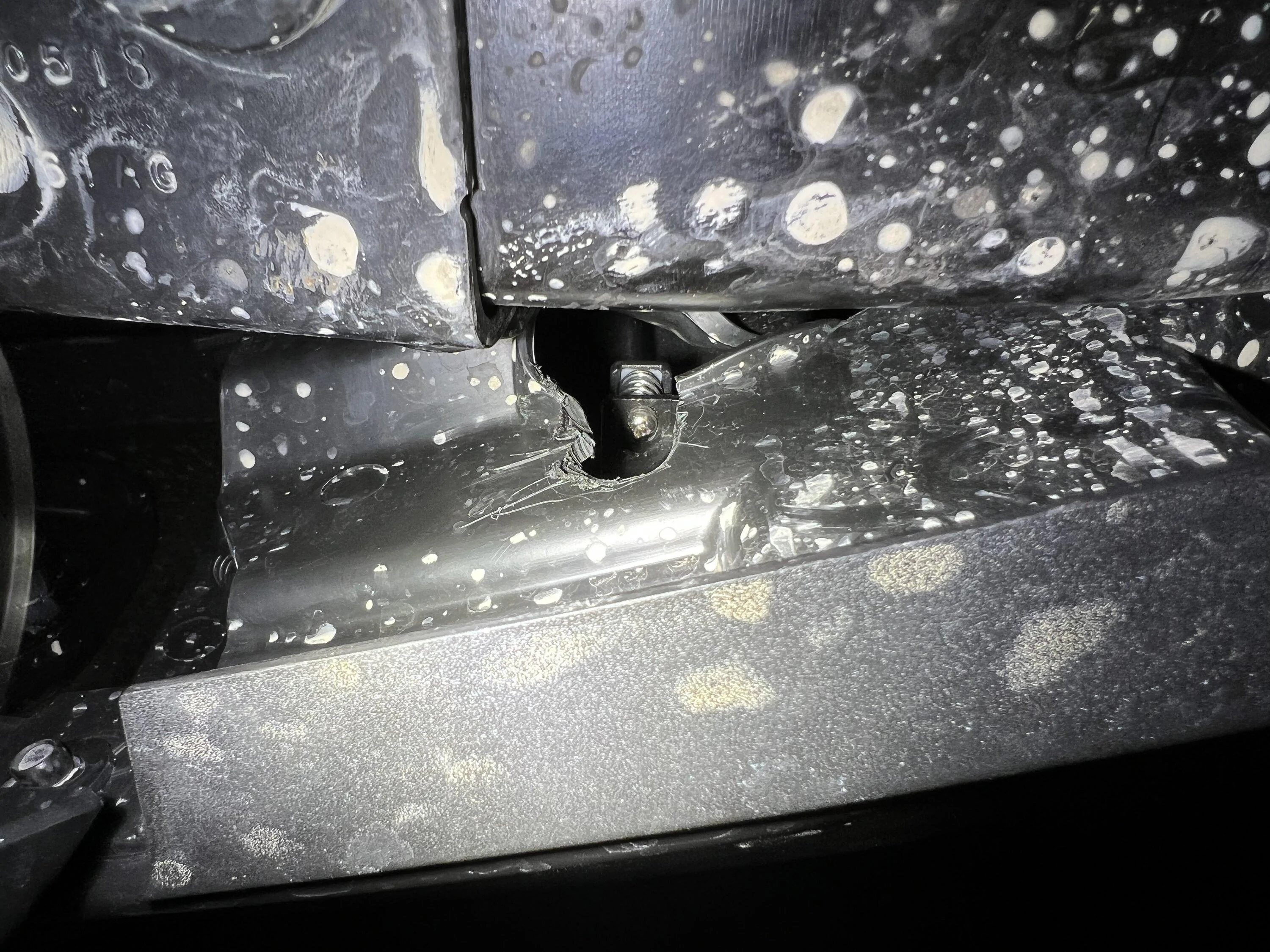

I was able to figure out how to access the adjustment screws though. The driver’s side is super easy, with clear straight on access to the screw when looking up from below the bumper. Just need a long philips head. The passenger side screw is tucked up behind the plastic, so I used a dremel with a sanding wheel to open up access. Its definitely a little wider than necessary, but its what I had and no one sees it anyway. Took 2 mins and had access to the screw from below.

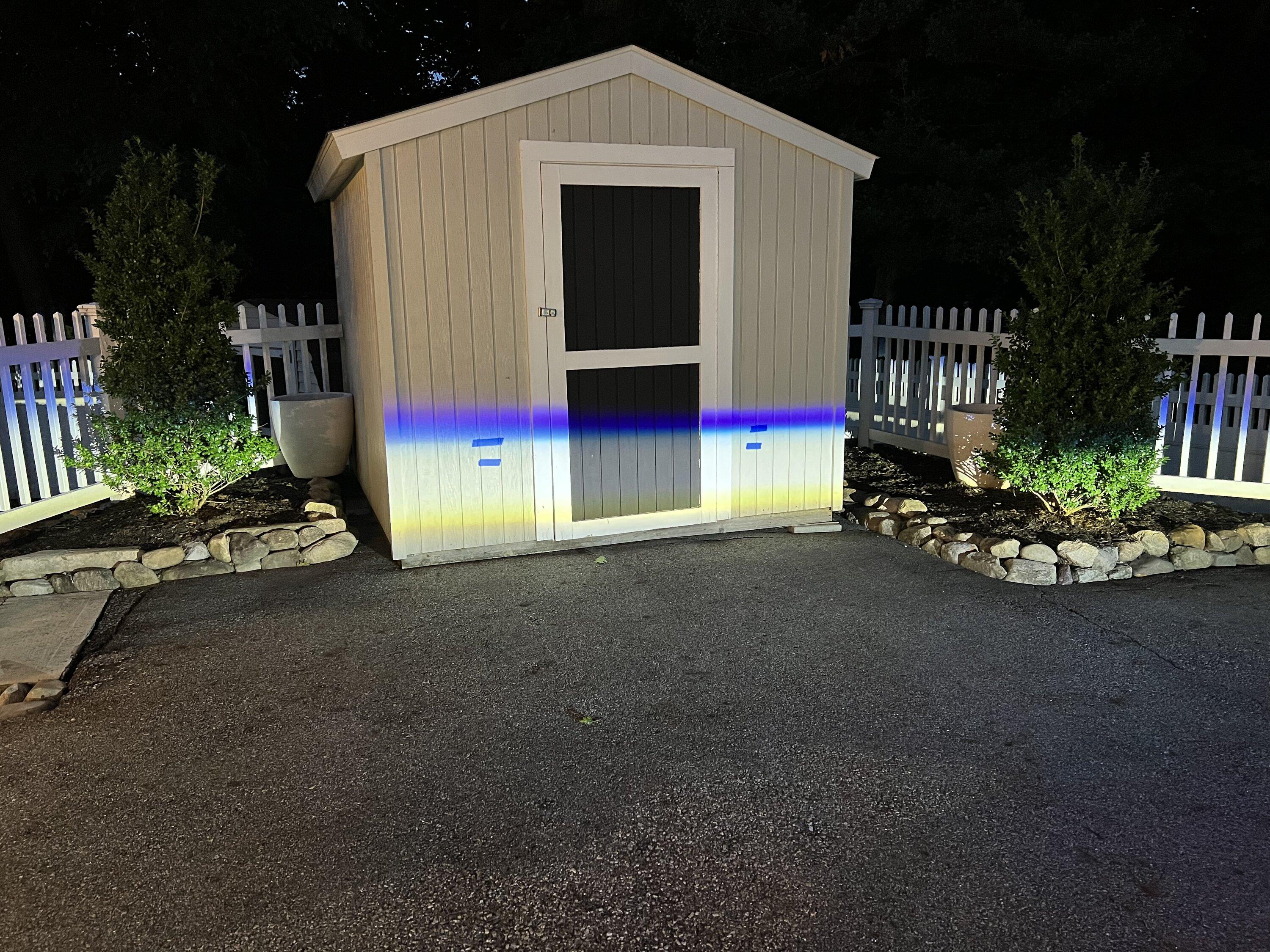

passenger side beam only (the good one - prior to adjustment):

Drivers side faulty lamp:

Cut made with dremel on the passenger side:

Very nice. That’s a sharp cut off line…
does it appear purple to the eye? Or is that somehow from the photo?

It does have the bluish line you see in the photo. I believe it is intentional. DD says on their site, “including a BMW-style “color flicker” at the very edge of the pattern.”
I don’t really get the purpose of it but it isnt nearly as noticeable when the headlights are on as well. Or when the lights are shining down the road and not on my shed.
