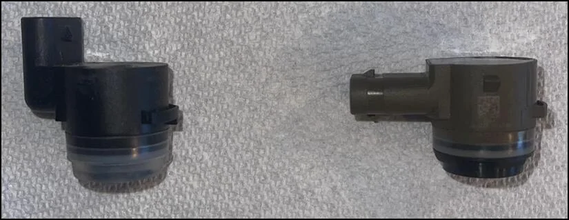

Kon - Thanks!!!, that's the part number that the dealers estimate shows, but on FordParts.com the picture shows the wrong connector. I'm going to order one and see if it's the correct connector.
Smurf - That’s the issue, everyone that posts a sensor part number is swapping to the modular bumper. I can find the part number for the modular bumper, but can’t seem to find the one for the capable bumper.
Capable needs the connector on the left:
Ford Bronco Capable Bumper Parking Sensor P/N 1725127547368-b8
Photo credit to braddavis2017
Ford Bronco Capable Bumper Parking Sensor P/N img_6241-jpe

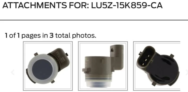

There’s a black one and a tan one depending on build date. Can‘t verify either without an engineering number, but they look correct.
Ford Bronco Capable Bumper Parking Sensor P/N IMG_4881
Ford Bronco Capable Bumper Parking Sensor P/N IMG_4883
Ford Bronco Capable Bumper Parking Sensor P/N IMG_4882

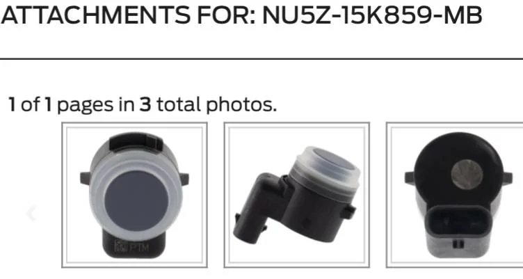

Looks like the CA part is discontinued and the MB part is on back order, but I have the correct number now.
Thanks again!

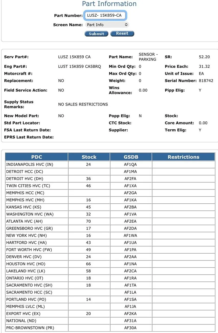

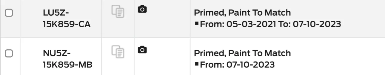

CA is still available with plenty of stock.
But you’re correct the MB is on backorder.
Ford Bronco Capable Bumper Parking Sensor P/N IMG_4886
