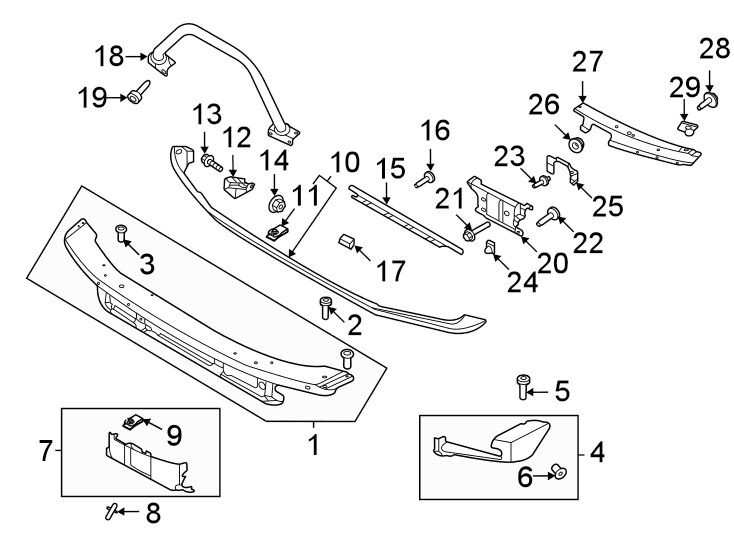

Have you installed the sensor with the rear plugs along with the metal bracket that mounts inside of the modular bumper on the ends, right behind the sensors (#27 in the diagram below)? That's where the interference generally happens with the sensors on the outer corners.

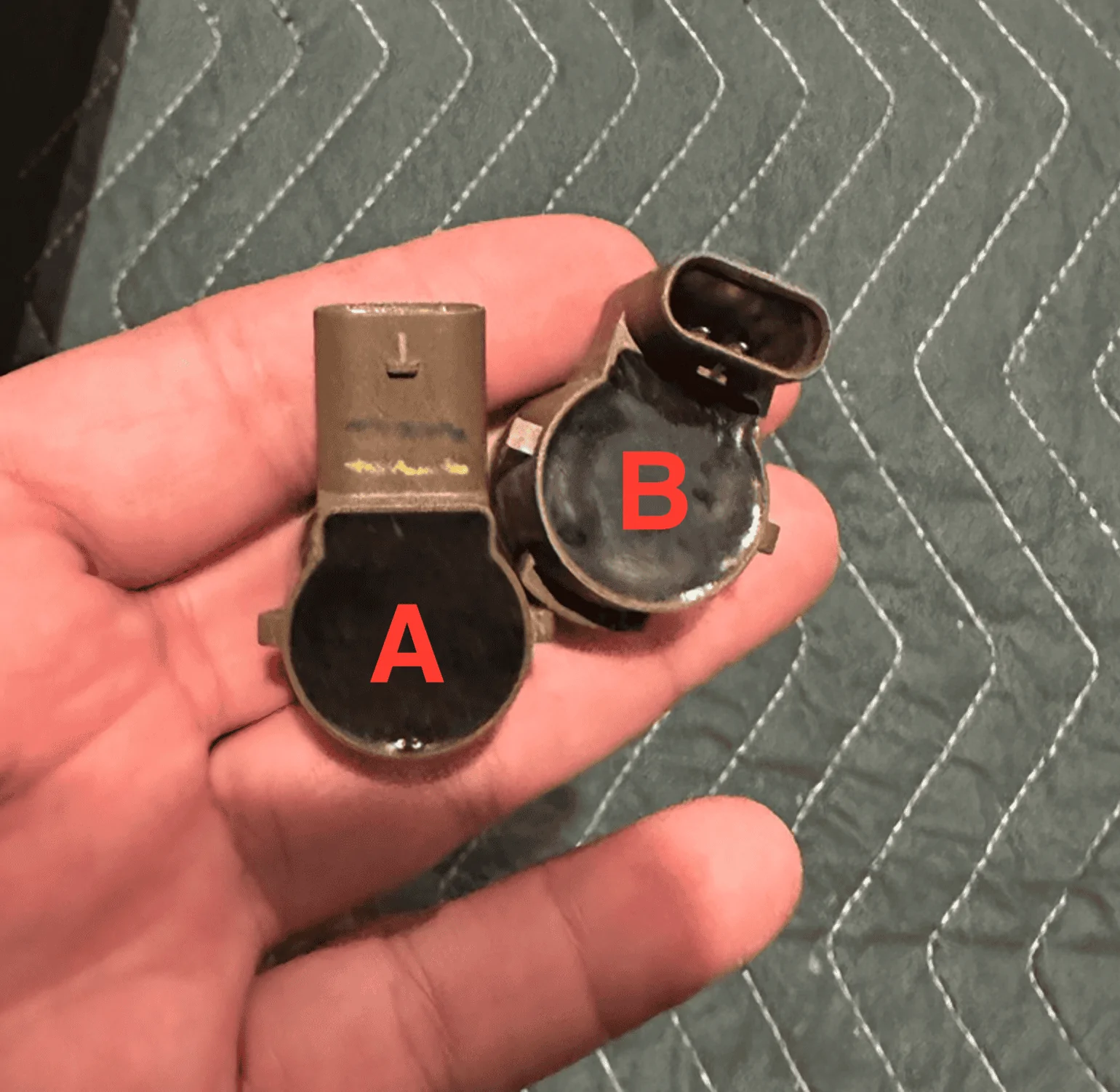

Just to clarify, were the sensors that came with your mod bumper variant A or B (in picture below)? The ones that cause issues on the mod bumper is sensor type B (which come installed in the capable) because the plug has to go straight back from the surface and it interferes with that metal bracket I described above. If you already have sensor type A, you're good to go.
Ford Bronco Conversion--Capable to Modular: Parking Sensors & Wiring Harness Screenshot 2024-04-24 at 12.48.20 PM
Type A - with 180° connectors. Despite the scratches and need to repaint, I scored a heck of a deal at $200 given the sensors and harness were still on the modular bumper.

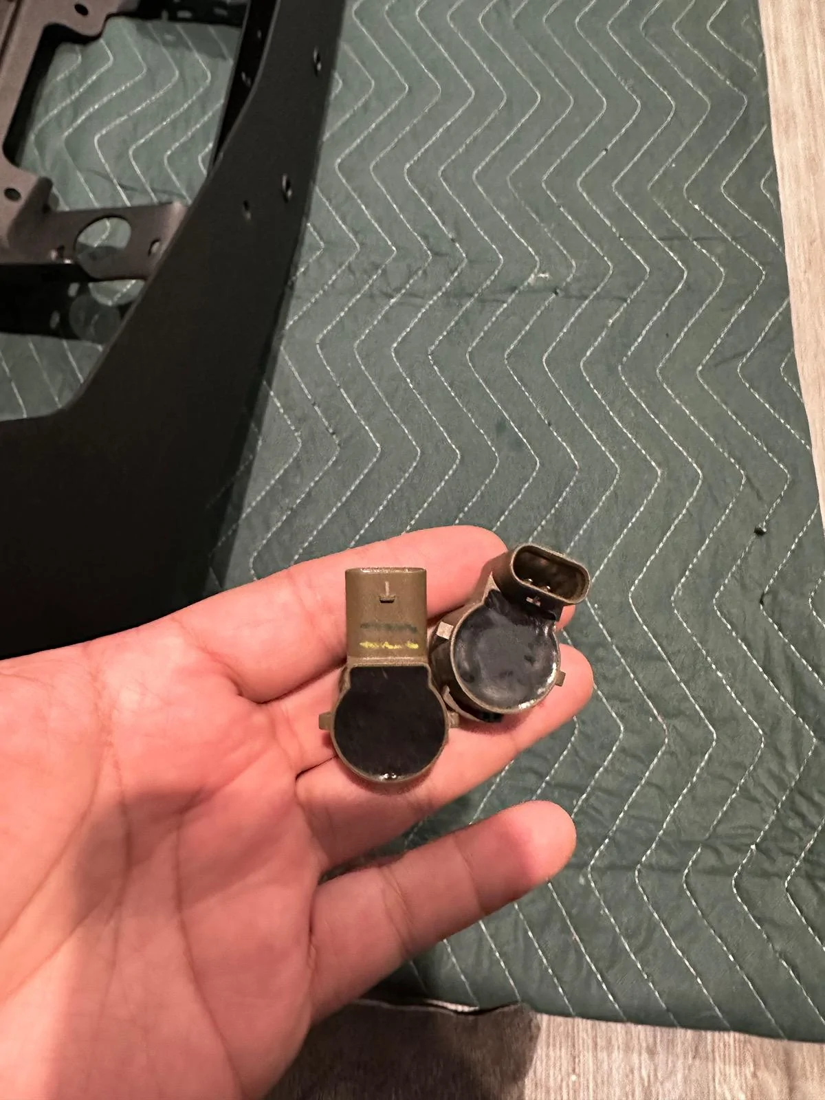

Type A came from my front capable bumper. Type B came from my rear steel bumper. I swapped them front to back when I went mod bumper.
Using Type B in the front outer mod bumper holes. Type A is now in my rear outer steel bumper holes. I only swapped the sensors themselves leaving all holders in the original locations. Hope that clears it up.
