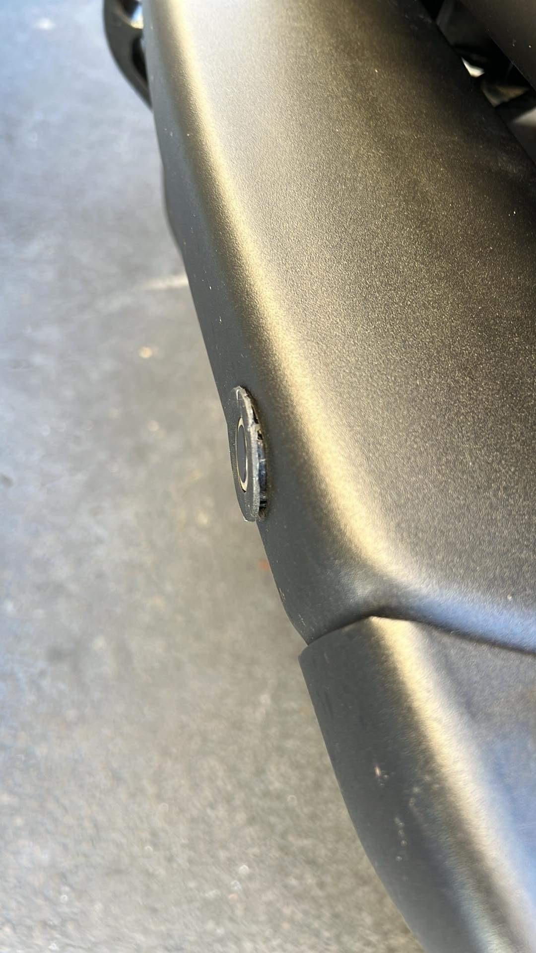

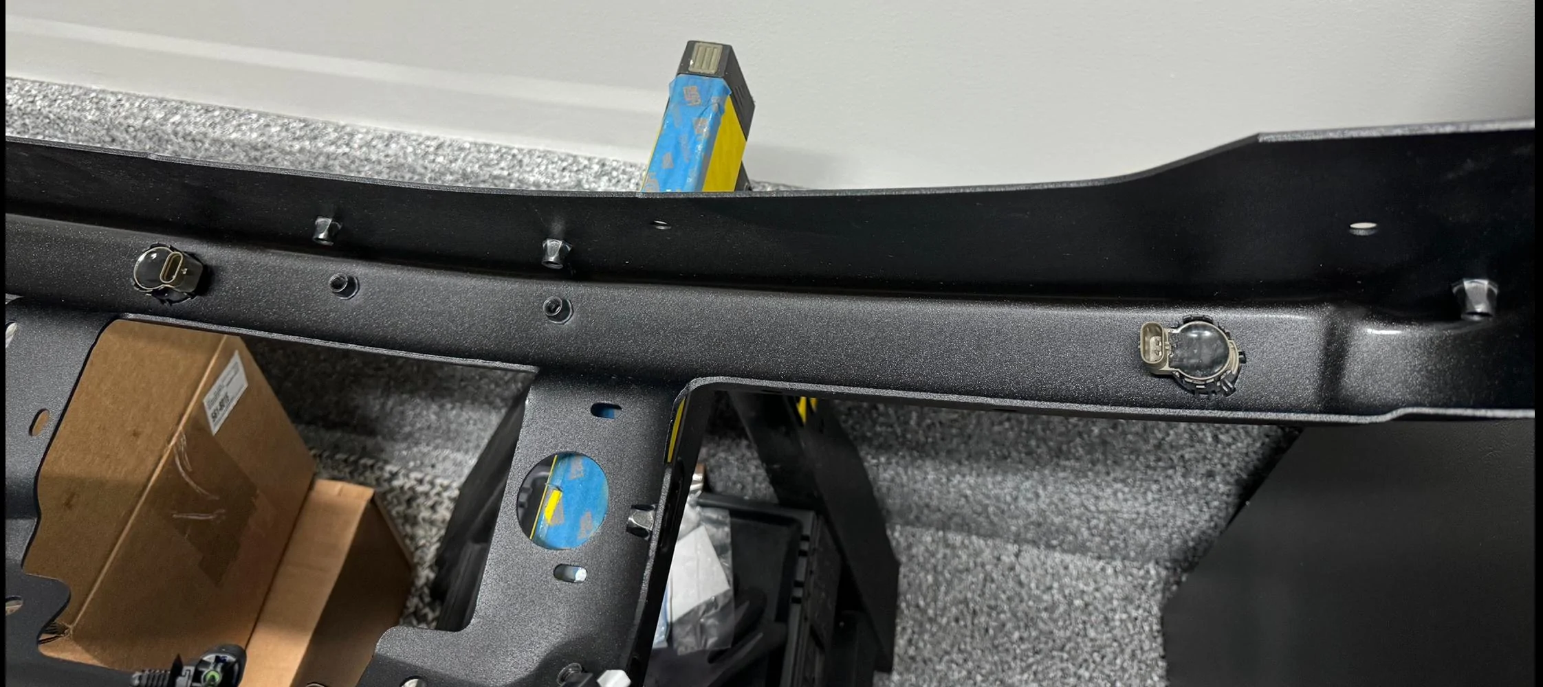

Hey All, I’m swapping my wildtrak from a capable to a Raptor front bumper and I’m having issues with the parking sensors on the outsides. I have ordered the correct sensor housings from Tasca Ford but when I go to put the brackets back on it’s pushing my sensor housings out of the bumper. I read several write ups and don’t see anyone having this issue.. am I doing something wrong?

The driver and passenger outter sensor from the capable bumper wont work bc the connector on sensor will interfer with the bracket behind the bumper which is the reason its pushing out the sensor retainer. Part # LU5Z-15K859-AAPTM for those outter sensors.

Thank you!! Looks like I’ll just be drilling to clear some space lol

I dont blame you. I ran into the exact same issue when swapping out my capable to the mod bumper. Those sensors aren't cheap and I had to paint the sensors to match the others since they don't come in black.

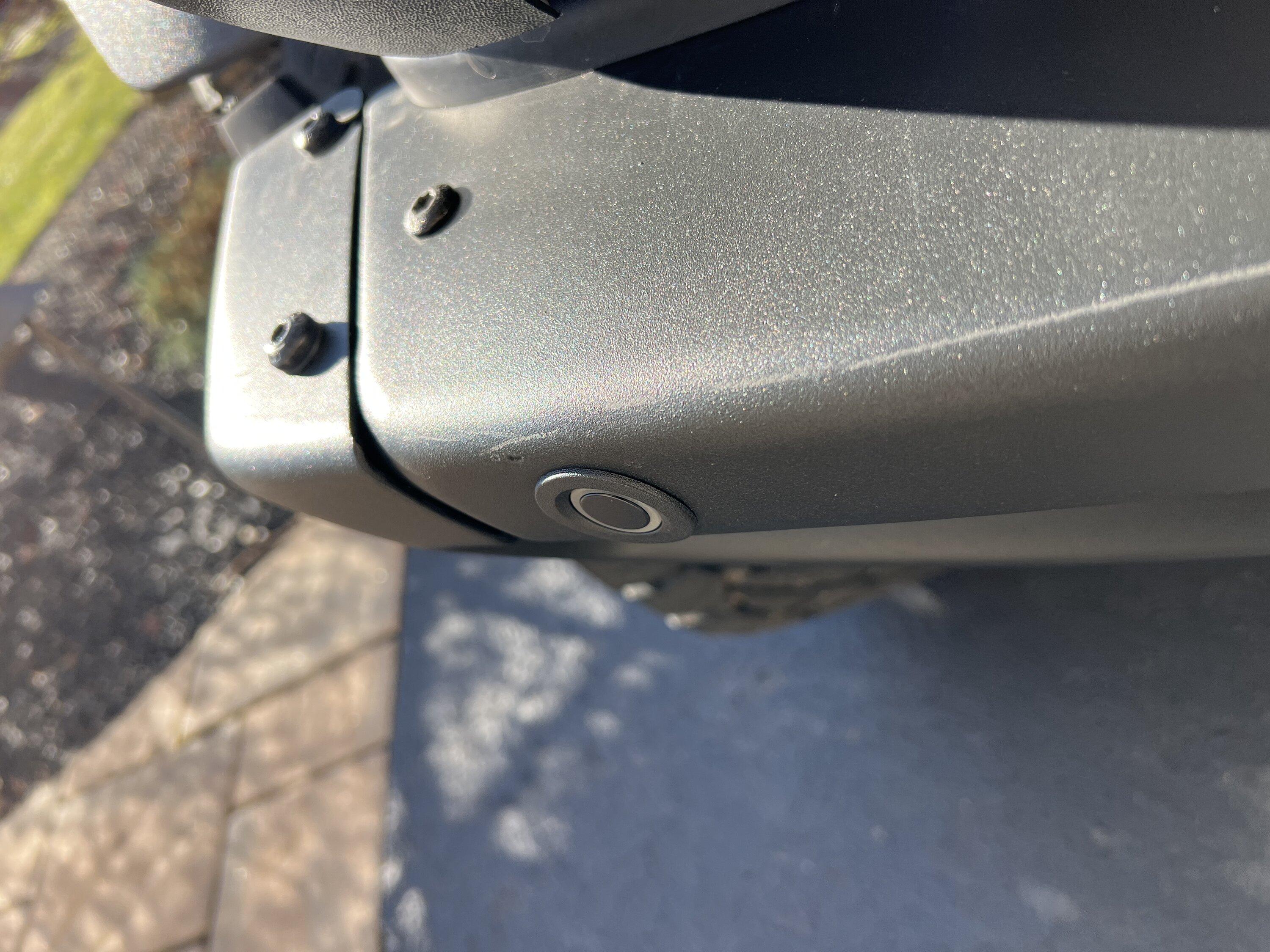

Thanks all, went to harbor freight bought a step up bit for $10, drilled and painted!

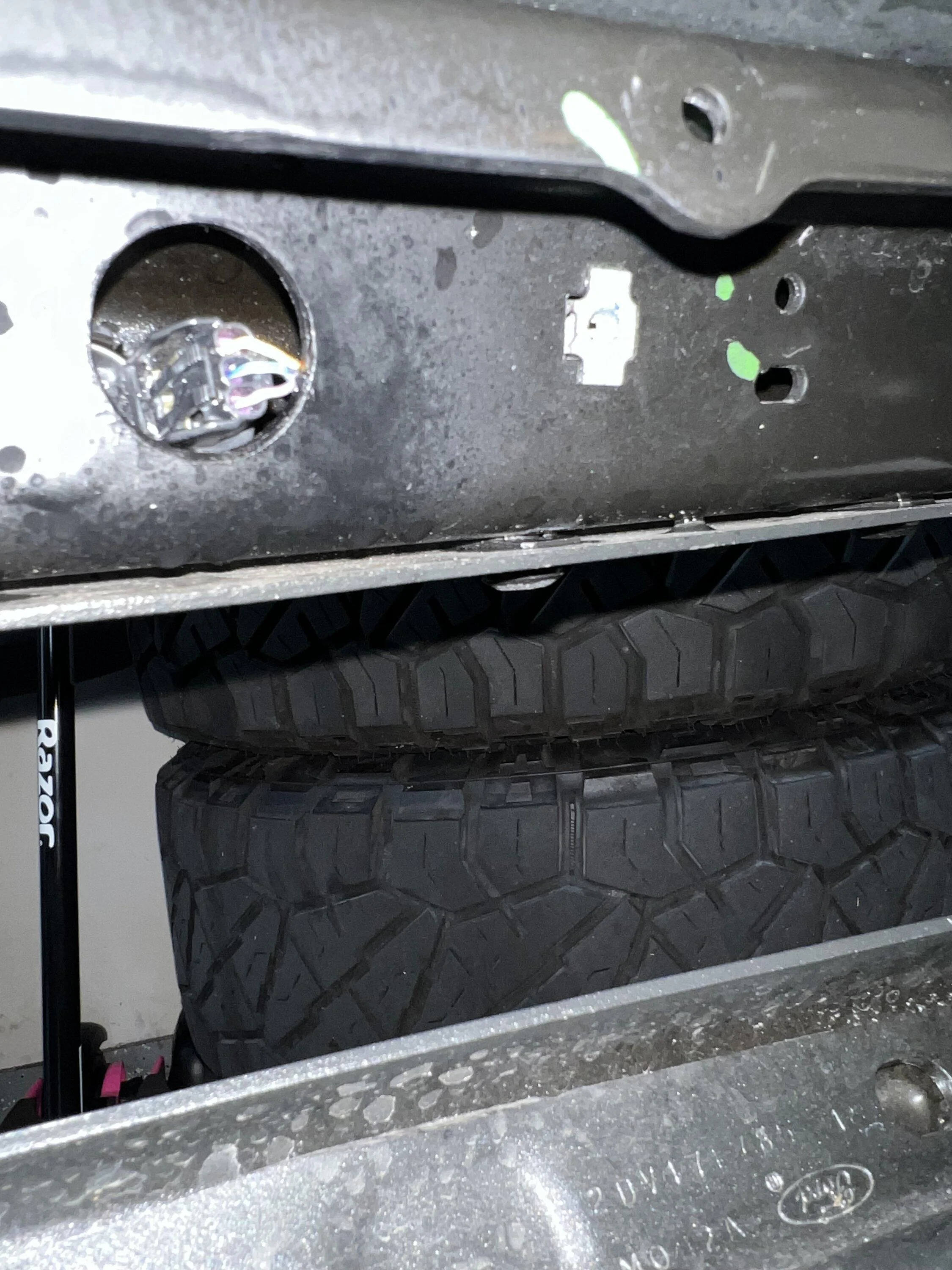

Correct I took the support brace off the bumper, marked a spot where it was rubbing on the sensor plug, then took a step up bit to the brace. I drilled down to about 1” to 1 1/8” and then the sensor was no longer getting pushed out.
Pic attached

Nice job! thank you for sharing that and the picture.

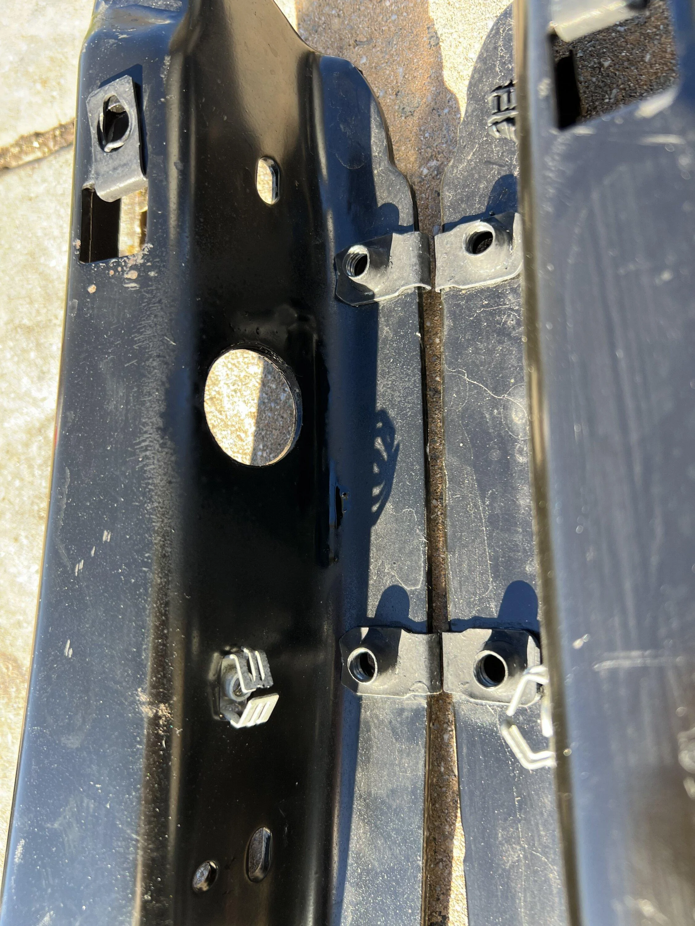

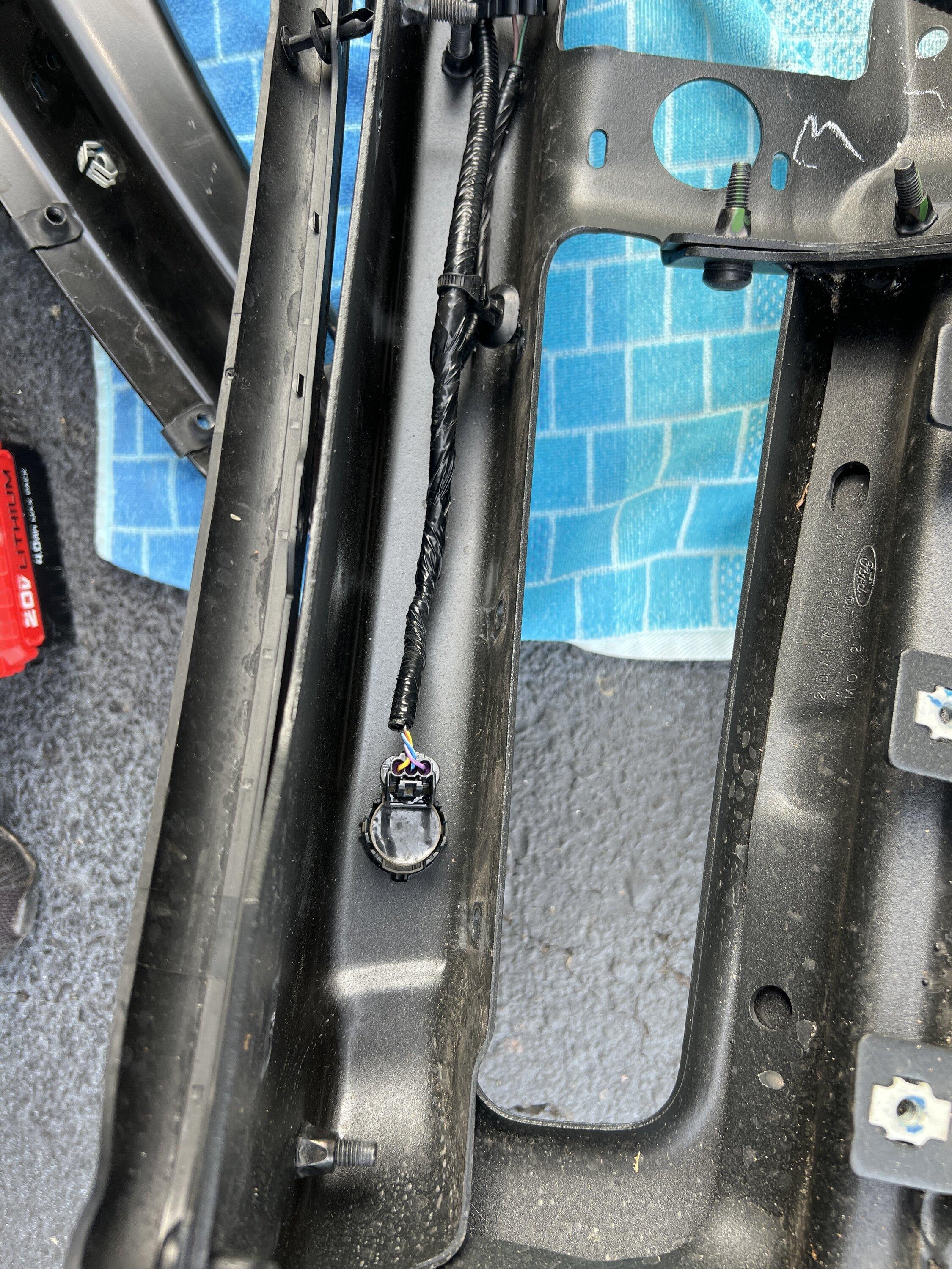

RepRyan I just started my wild track conversion. When you moved your sensors from the capable to the modular did the sensors have to be rotated 180 degree from the way they were in the modular? See my pic below.
Ford Bronco Capable to Modular bumper IMG_5132

I'm in the process of doing this now. Yes the sensors will rotate.
NOTE: Once you screw in the back piece you will push out the outer sensors. You can either buy the ones specific to the modular bumper or cut a hole. I opted to cut a hole.

Thank you for the response!!!! I am planning to make a clearance hole for the outer sensors. Phew was worried I put the new sensor holders in wrong locations.

Cutting holes will give you more slack. I cut my holes then laid out my wiring favoring the driving side heaven almost got it to the connect in the fender connection without disconnecting it from its tab. I was off by less than an inch.
