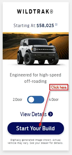

Oh, I saw the title and thought you needed this guidance.
I added Parking Sensors fairly easily:
Ford Bronco Adding parking sensors possible? 1680270572304
Then wait 2 years to get it. LOL
