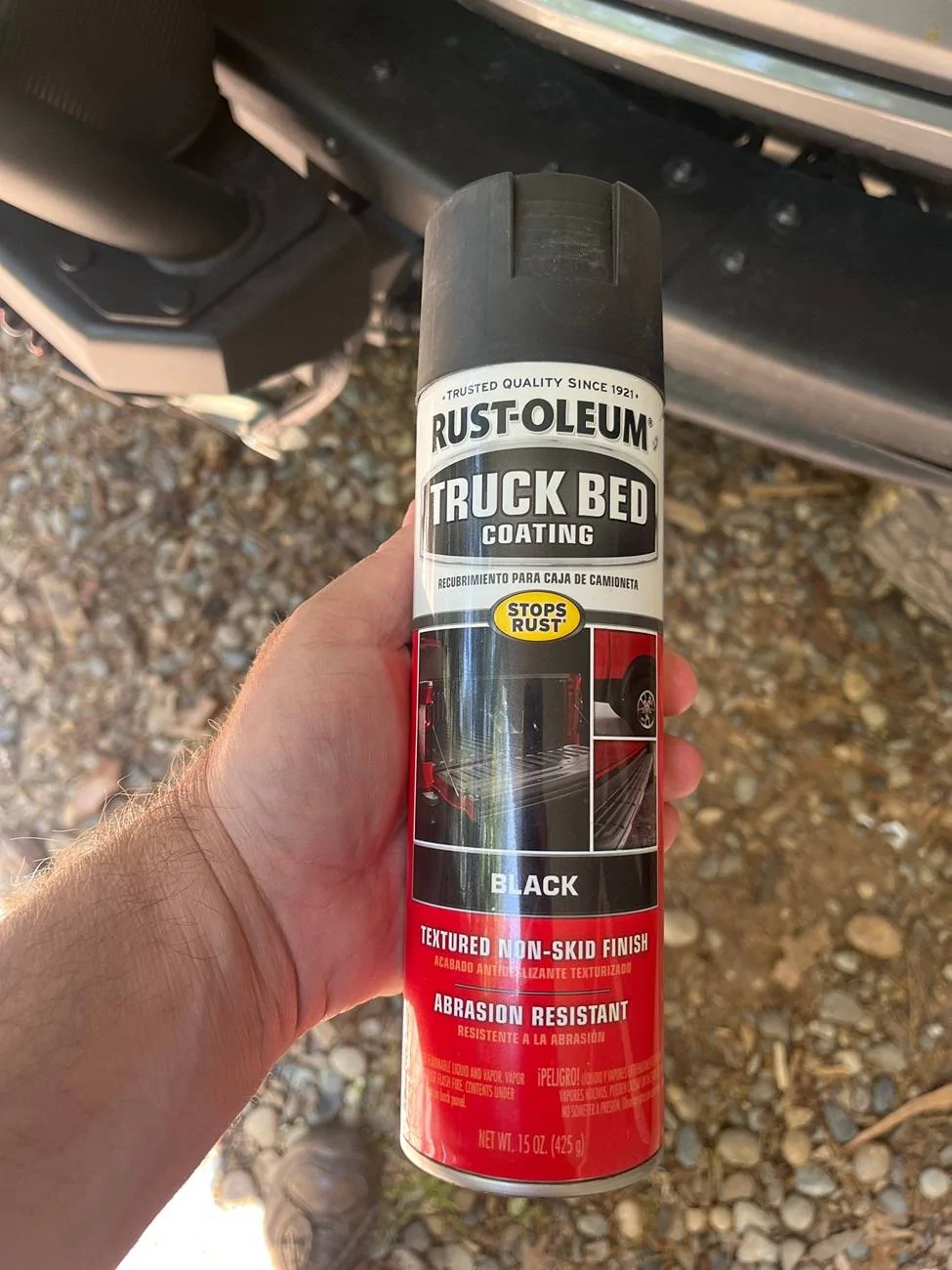

Did my entire Chinese mod clone in this stuff, inside and out. Itโ€™s help up amazingly well and matches the textured black powder coat that most aftermarket accessories came with - including the Ford Performace winch mount
Bonus is its on the shelf at almost every hardware store
Ford Bronco Bumper - Paint or Powder Coat? imag
That said - 100% agree powder coat will look amazingly better, but be more difficult to maintain if you want to actually use it
