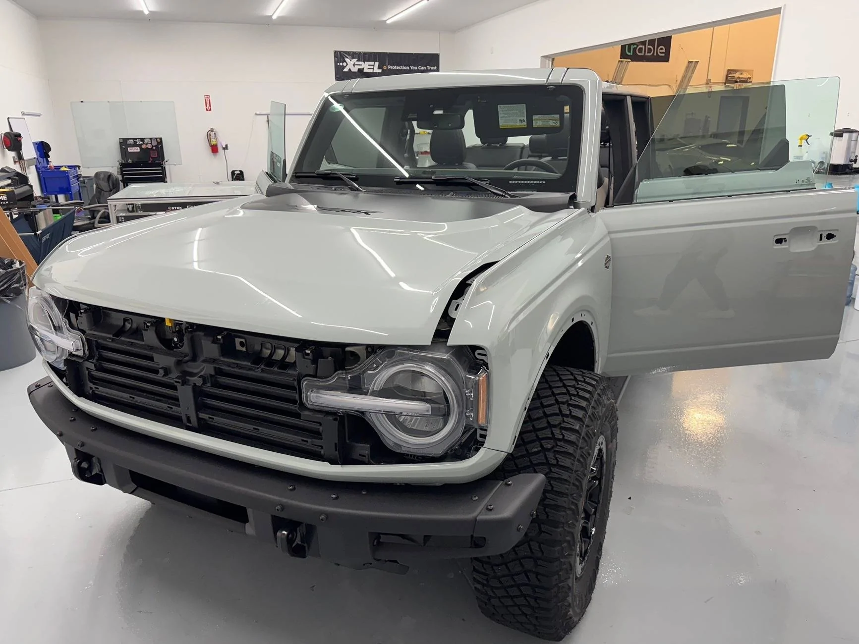

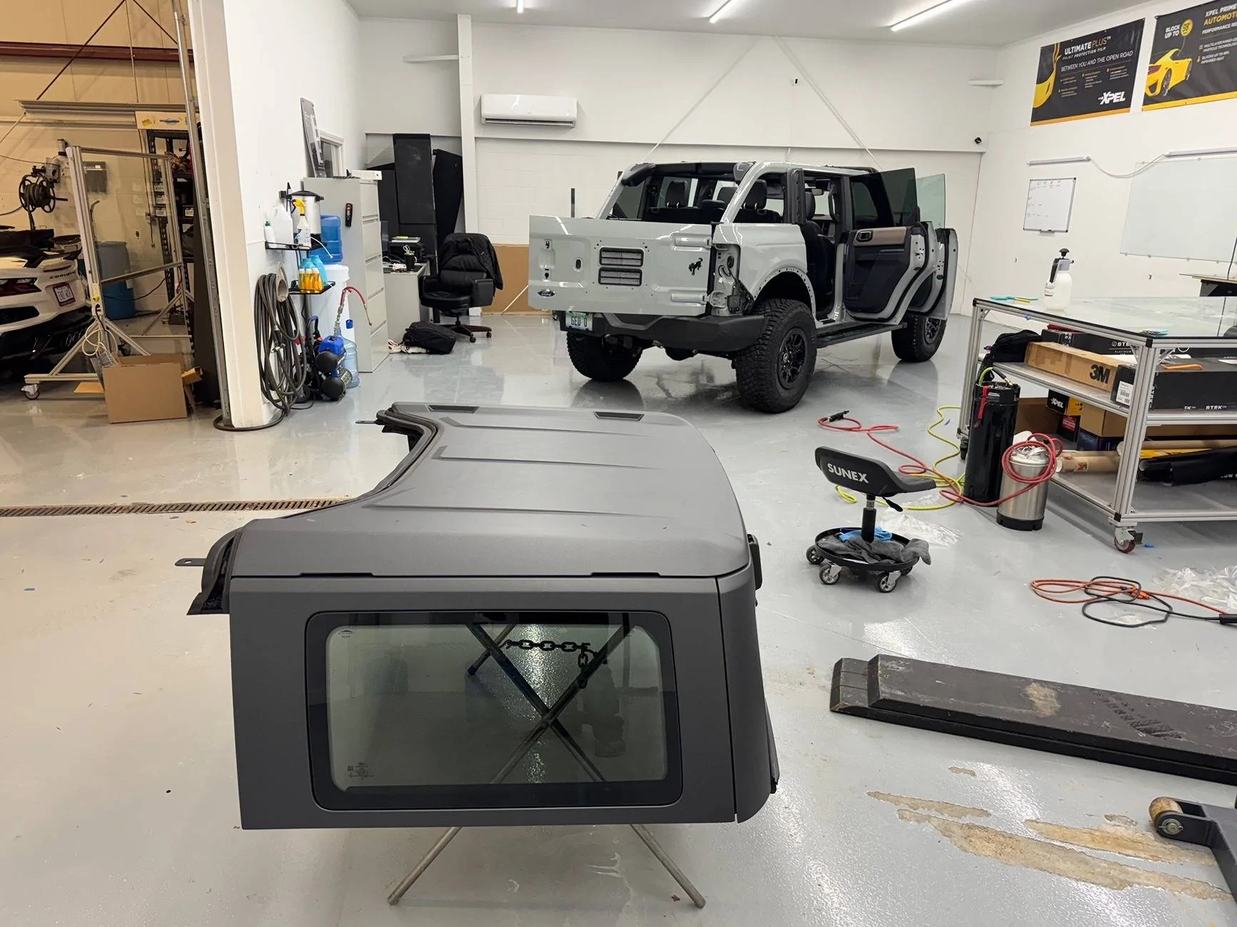

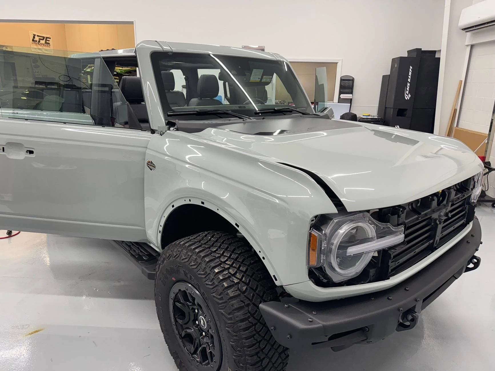

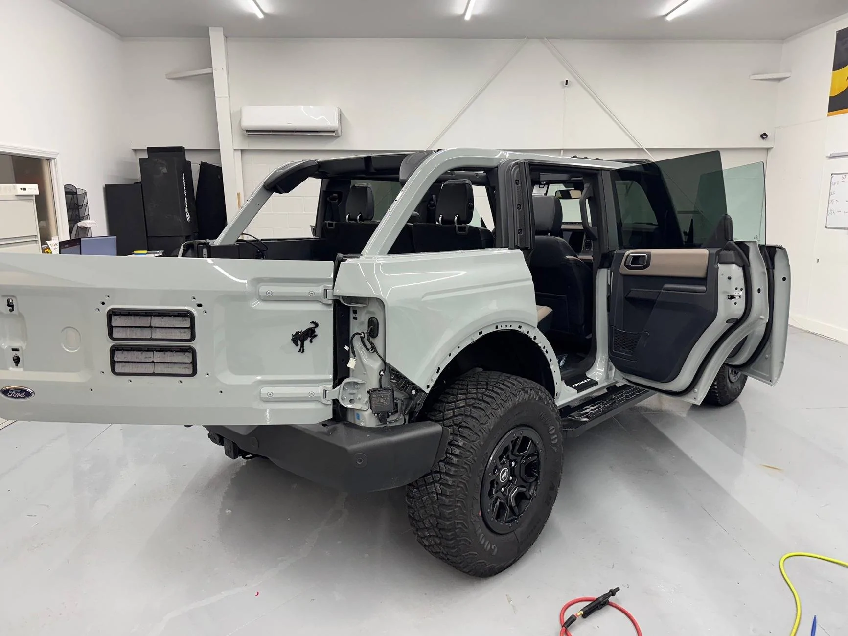

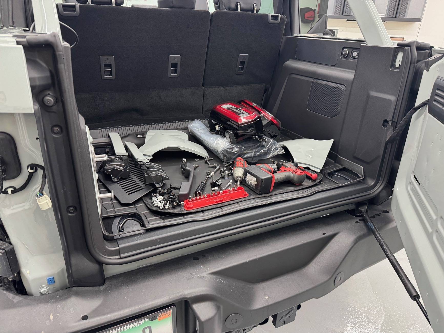

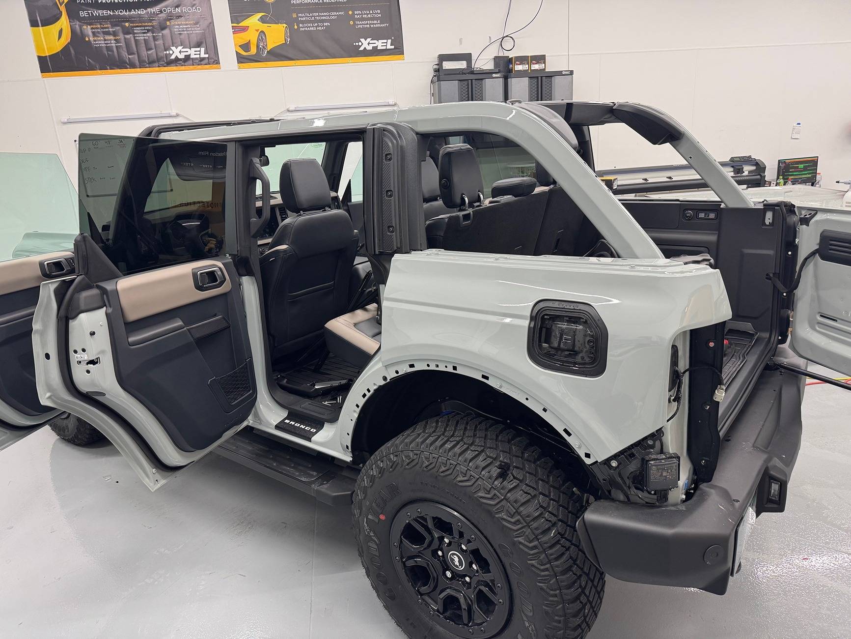

I recently had a full body (minus the MIC top) PPF applied to my new 2024 WildTrak, including the grille and headlights.
When applying the PPF, the key is to leave as few exposed edges as possible as the edges over time will collect dirt, become more visible and potentially lift . In my case they installers removed most of the trim pieces (top, taillights, door handles, grille, emblems, etc.) and wrapped the edges of the film around the openings and then re-installed the trim pieces so the edges are covered and protected. I attached some pictures of the install process of my WT.
In my situation the installer used a film that the manufacturer claims is ceramic infused (STEK DYNOshield).
Not sure if it's my imagination, a placebo effect, the color (Cactus Grey) or if it's actually resistant to dirt adhering to the car, but I swear that even after a rain, the body panels look pretty clean, especially when comparing them to the bumpers and wheel flares.
Maybe it's also because I am comparing the color to my other two cars which are black.
My installer said the film is guaranteed for ten years at which time it should be removed.
If you were quoted upwards of $5K, then that shop is doing it the right way.
