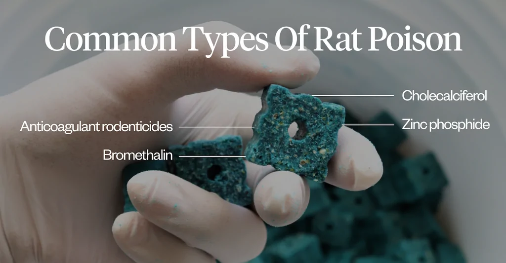

Zip tie (or other wire) some of these under the hood. They eat it and leave the area to get water and die. I use these in my attic and shed and you can see when/if you have critters by how much is eaten. I now have a fox family living on my property and have not had a mouse problem since - shed and attic.

How would this affect any predators that eat the rats? Don't want to harm foxes, raptors, snakes or anything else that eats rats.
Making the assumption it's under the hood and foxes, and other large critters, are not getting under the hood. You could seal it in a Tupperware bowl with a small mouse sized hole - zip tie the lid shut.

Just be sure not to use something like this:
Ford Bronco Broncos and MICE. q=tbn:ANd9GcR7FreczsURGJD_51osSVyAg3i1mwSqYatgUQ&s
