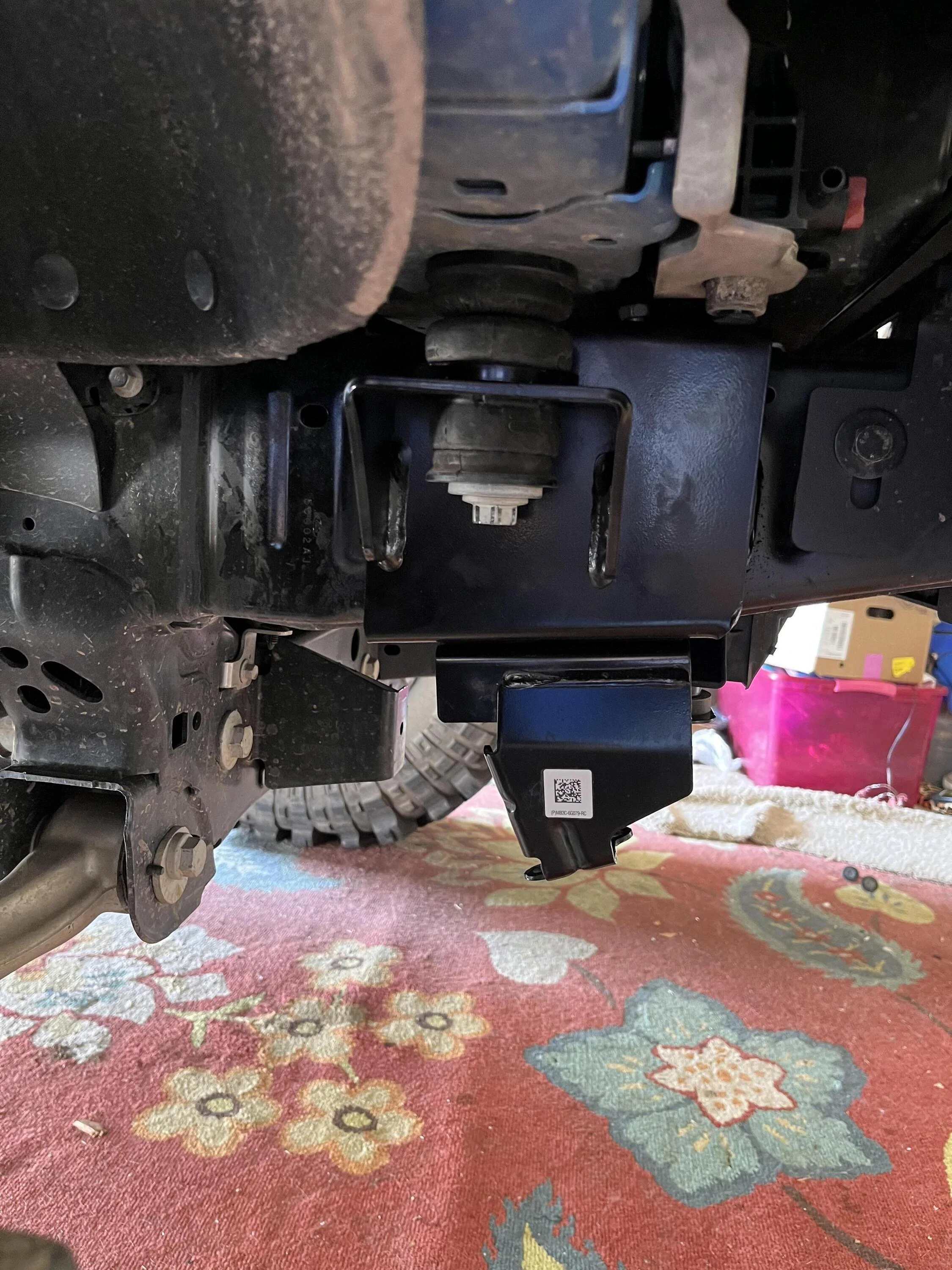

Perch collars allowed me to run 37x13.5”Cooper’s on my non-Sas Badlands.
What collar did you use? Any trimming required?

RPG 2.25" front with 1.25" rear. JKS Max Clearance kit was also required.

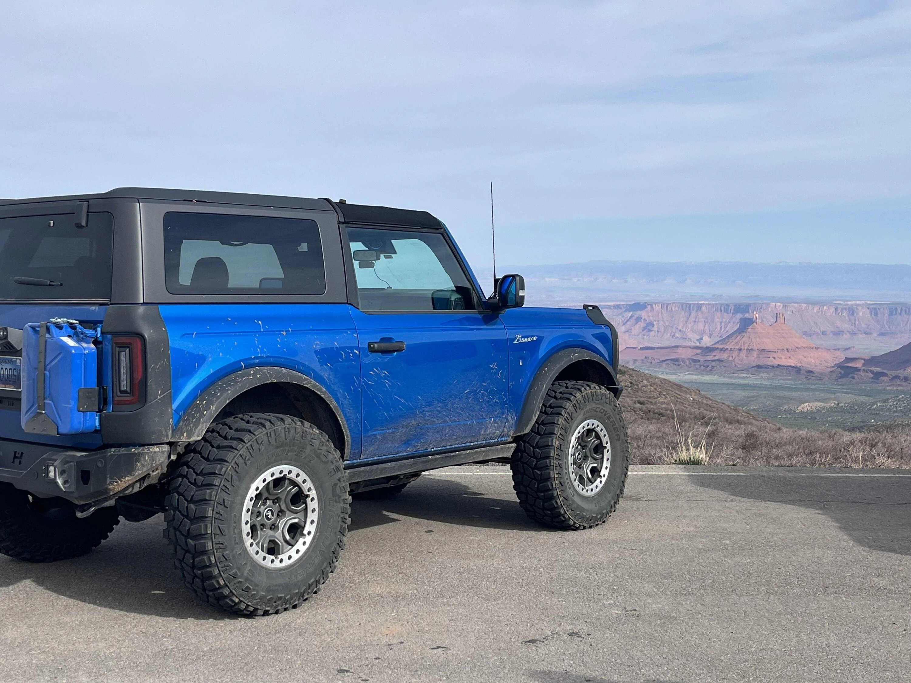

On a Raptor Yes, but any other trim will rub in off-road situations, unless you also add a Body Lift........🤔
Many have tried 37's, but none that I know of have got it done without cutting something. The Team at Carli Suspension couldn't run 37's with King shocks without removing the inner fenders and making different flares. They found 0 offset made clearance issues worse for themselves so they use Sas wheels with +30 offset. 🤷‍♂️

I still rub the flares myself, so I am looking at going to 6112's with heavier springs up front (or a 3/4" body lift).

I never did a build thread cause I just plain didn't think about it, but it was pretty simple...2" of body lift+2" of eibach springs on stock squatch suspension. Gradually doing the same w/the non-squatch, but even on a BL the squatch factor is there...the non-squatch always looks like "little brother". It was always the same w/Jeeps for me too..."hey, I could get another inch by doing X" and so on it goes!
