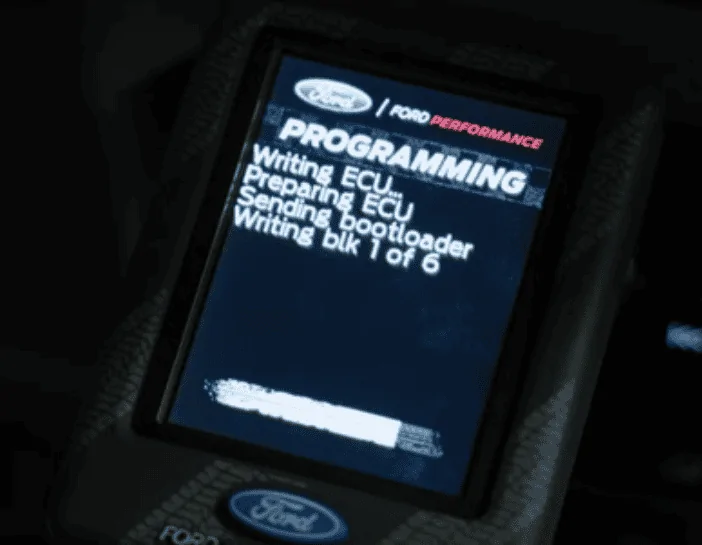

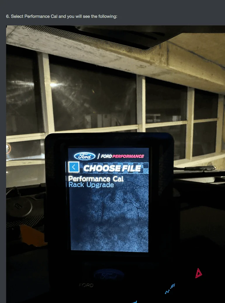

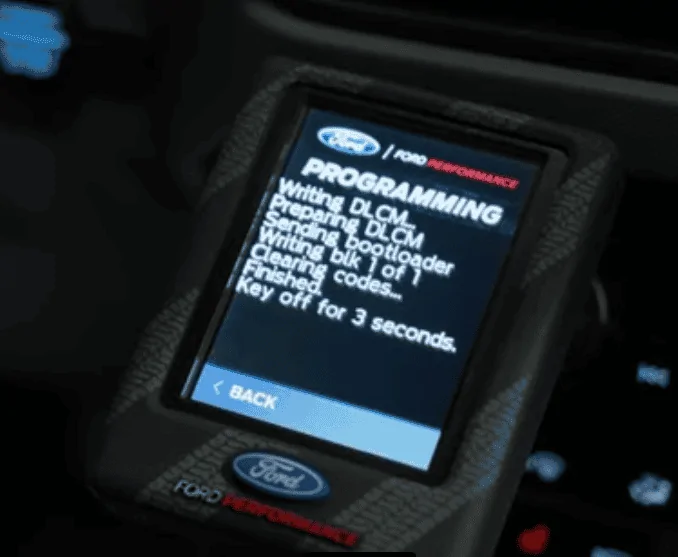

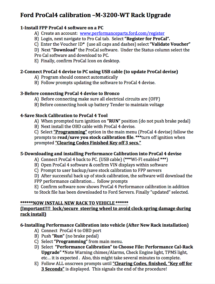

I just finished up installing my new M-3200-WT rack with ProCal4.
Note: The yellow "voucher" is located underneath the foam of the M-3200-Wt box.
(without the voucher you can't proceed)
NOTE:
THE PROCEDURE BETWEEN #5 AND #6... THIS IS PARAMOUNT TO THE SUCCESS OF YOUR DOWNLOAD. (do not go out of the procedure sequence)
Here is my procedure (that worked for me):
Notes:
These videos are great for the mechanical swap:
PoPo Patty and Mitch Creel.
https://www.google.com/search?clien...ate=ive&vld=cid:9c325b3f,vid:SGwrlaNaOlo,st:0
PoPoPatty Snacktime
BroncoBusters
74 Weld
This video for the ProCal4 procedures: (even though this is the TUNE it is basically the same for the rack. Just different files.
Any questions hit me back
-Tahotrvlr
