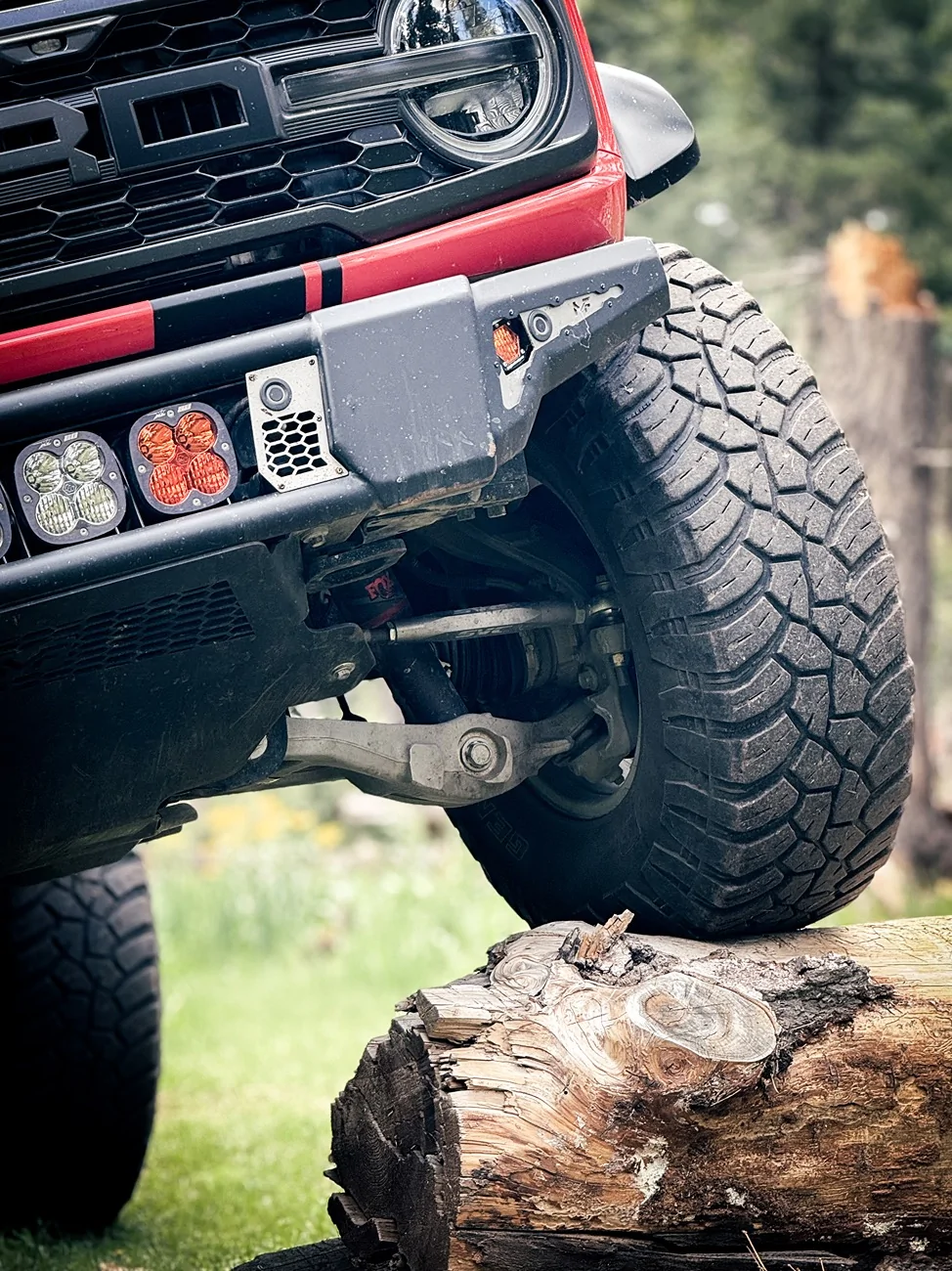

SVC Billet Components Review:
TLDR; Adds durability. Tie rods tightened up steering and links tightened up the rear suspension. Aesthetically very appealing, but will only pay off performance wise for people who really plan to “push it” in their broncos.
I’ve always been a big fan of SVC products and their builds so when I saw them start making components for the bronco I eagerly jumped in. As the first adopter of all their products I was able to make a special request for raw aluminum color to match my wheels which they now offer as an option!
Tie Rods: this was the most noticeable change right away. There’s a lot of “slop” I didn’t notice in the OEM tie rods until I swapped them over. It makes the steering immediately seem a little more responsive. In the case of full tie rods vs half tie rods, personally I am a fan of half tie rods. In the case of a failure I’d rather the tie rod break than the knuckle. I still carry my OEM ones with me in case but have heard very little issues of people breaking tie rods on the Braptor.
Upper Control Arms: upgraded when I got my Hyperco lift, these helped maintain a controlled suspension geometry. These are harder to tell an immediate difference while driving, but the added durability it adds pays off in the long run. The only issue I had is if you look at the OEM/ Foutz UCA they have a “dip” in them to clear the body. Without that dip you need to trim a little of the unnecessary aluminum above the UCA so it can clear when fully compressed. If you don’t, it will certainly self trim…
Rear Links/ Panhard Bar: Drivng around town this may be harder to notice the difference. Once you hit a series of whoops or some bigger drops, it becomes more apparent how these help. They all
Work in combination to tighten up the rear end and “grab” the terrain below it. I can’t say I noticed much until I went back out on the trail, and could immediately feel the reduction in body sway and suspension benifits.
Overall great products that look as good as they perform. Other than the tie rods I wouldn’t expect to see a gain from daily driving (aside from the appealing look). If you plan to really push your bronco, I’d highly reccomend SVC!
