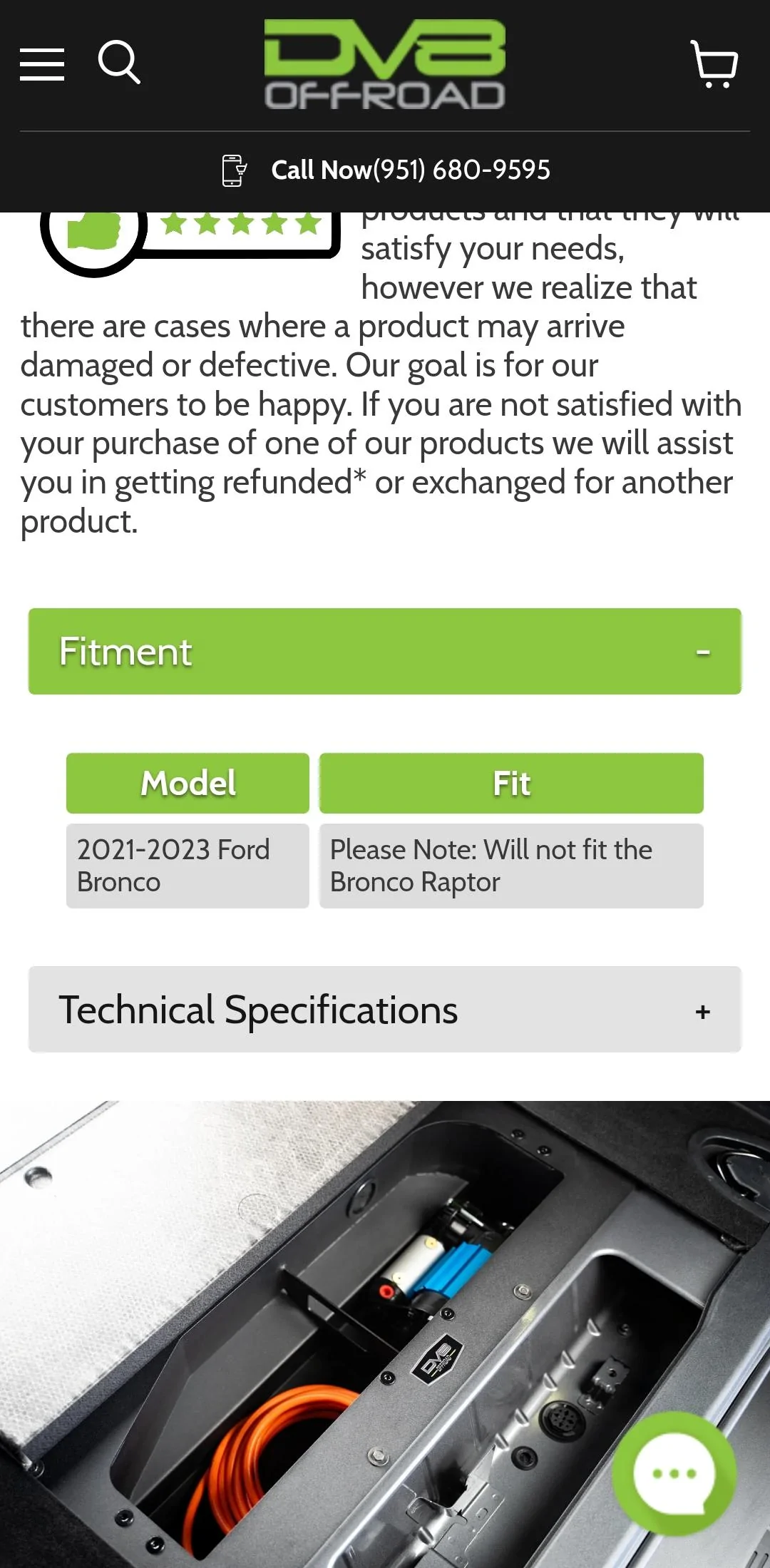

This is what i want to do as well but with DV8 saying it wont fit the raptor was not going to pull the trigger. I so want this to work!!
Keep us posted.
How does it not fit? The only difference is the exhaust - that could be a problem since I didnt even ask.

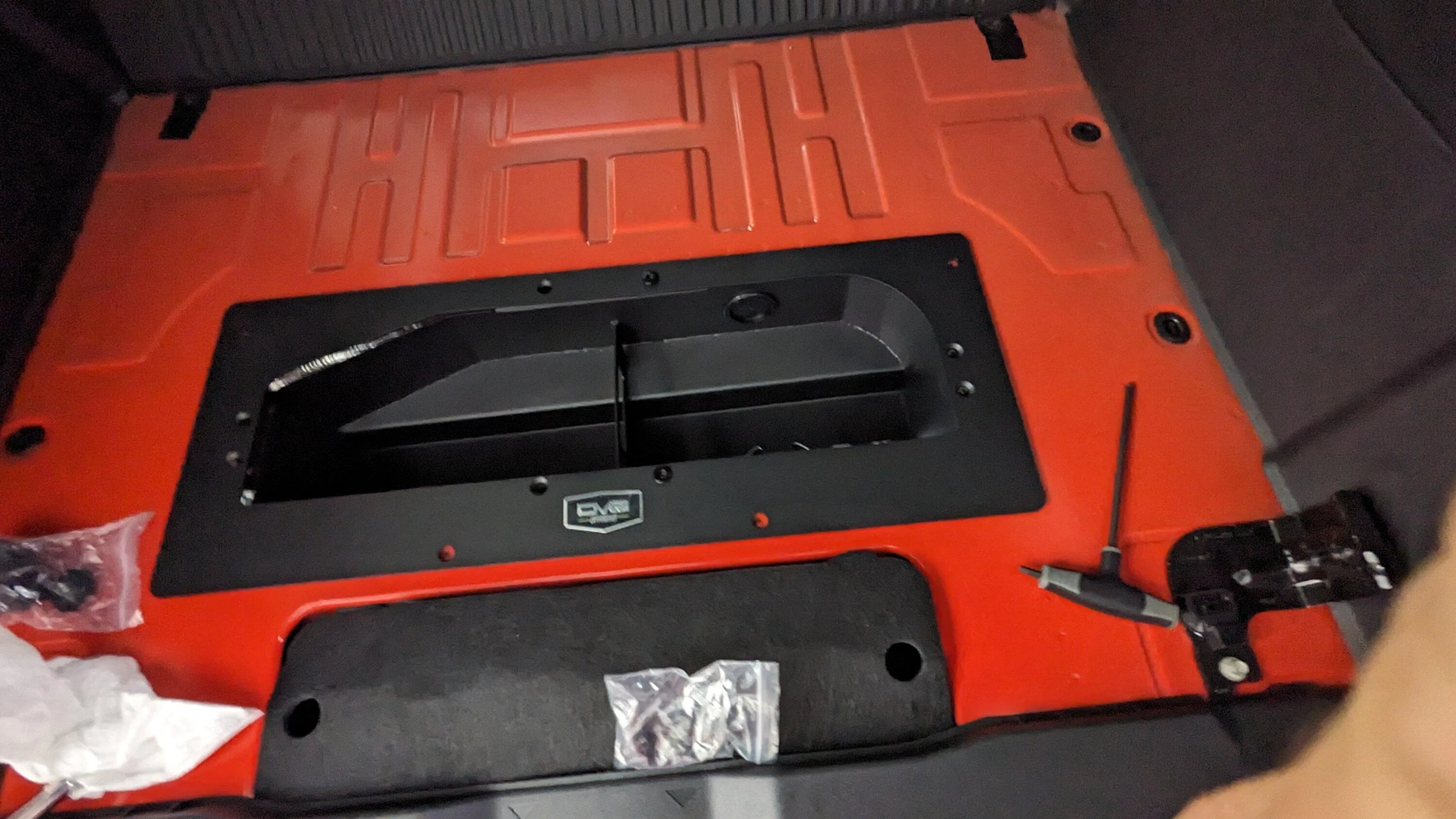

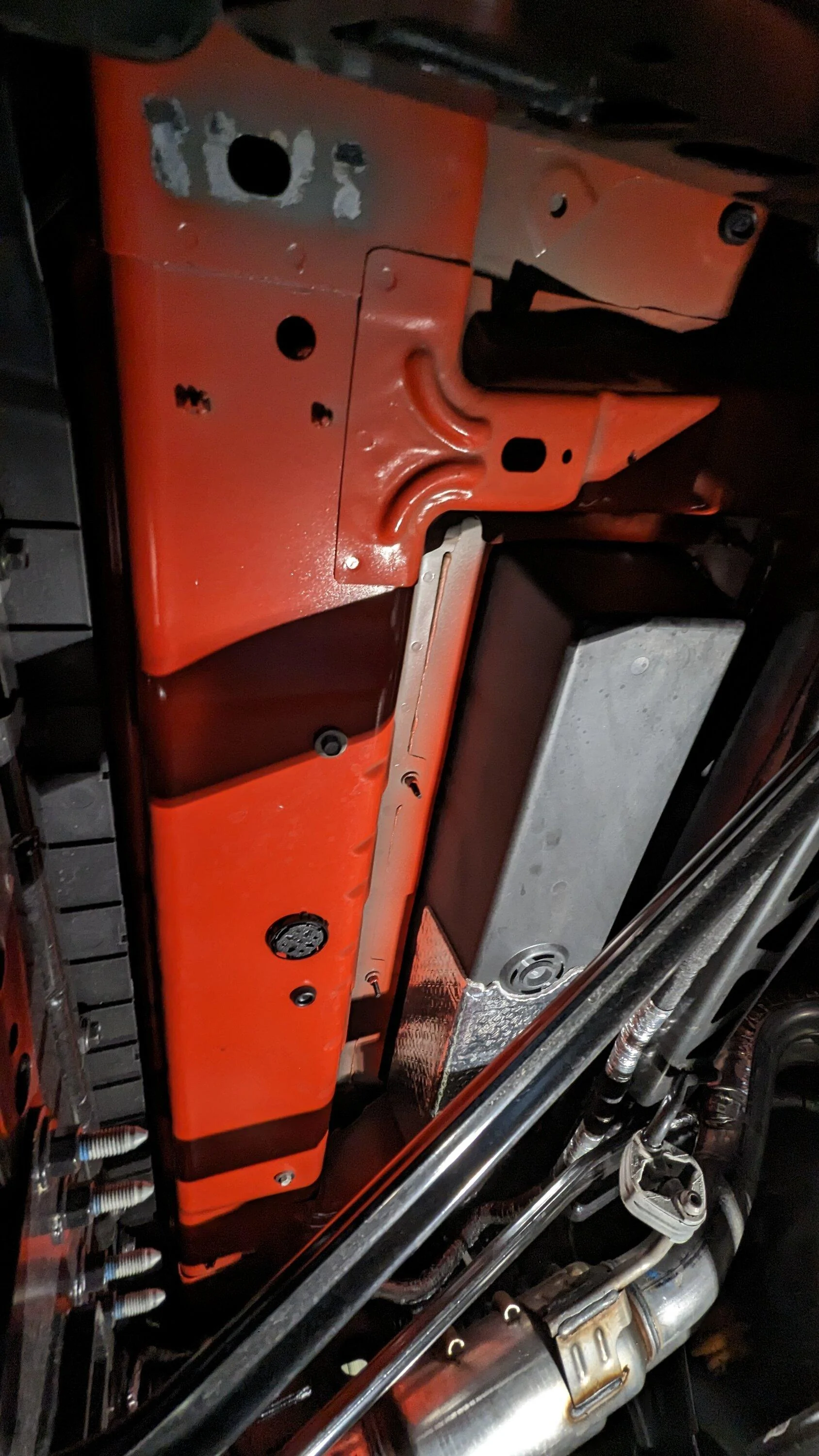

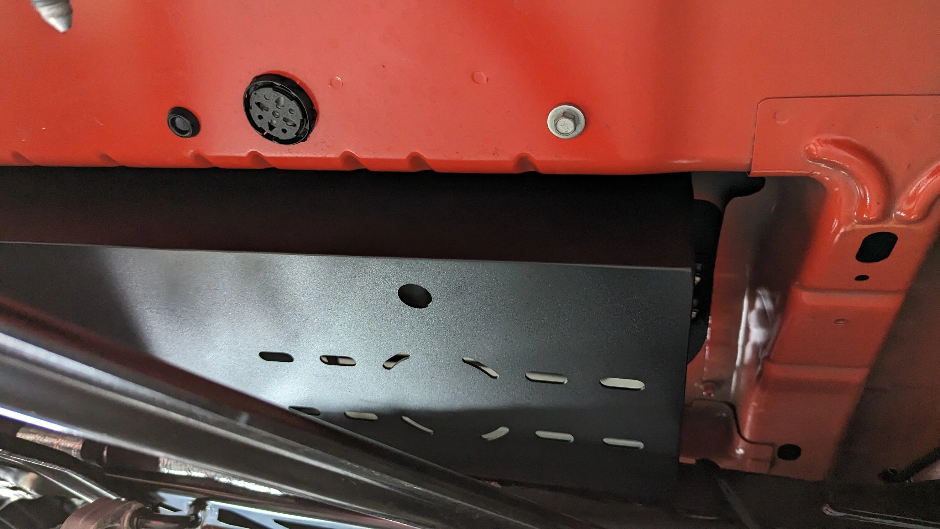

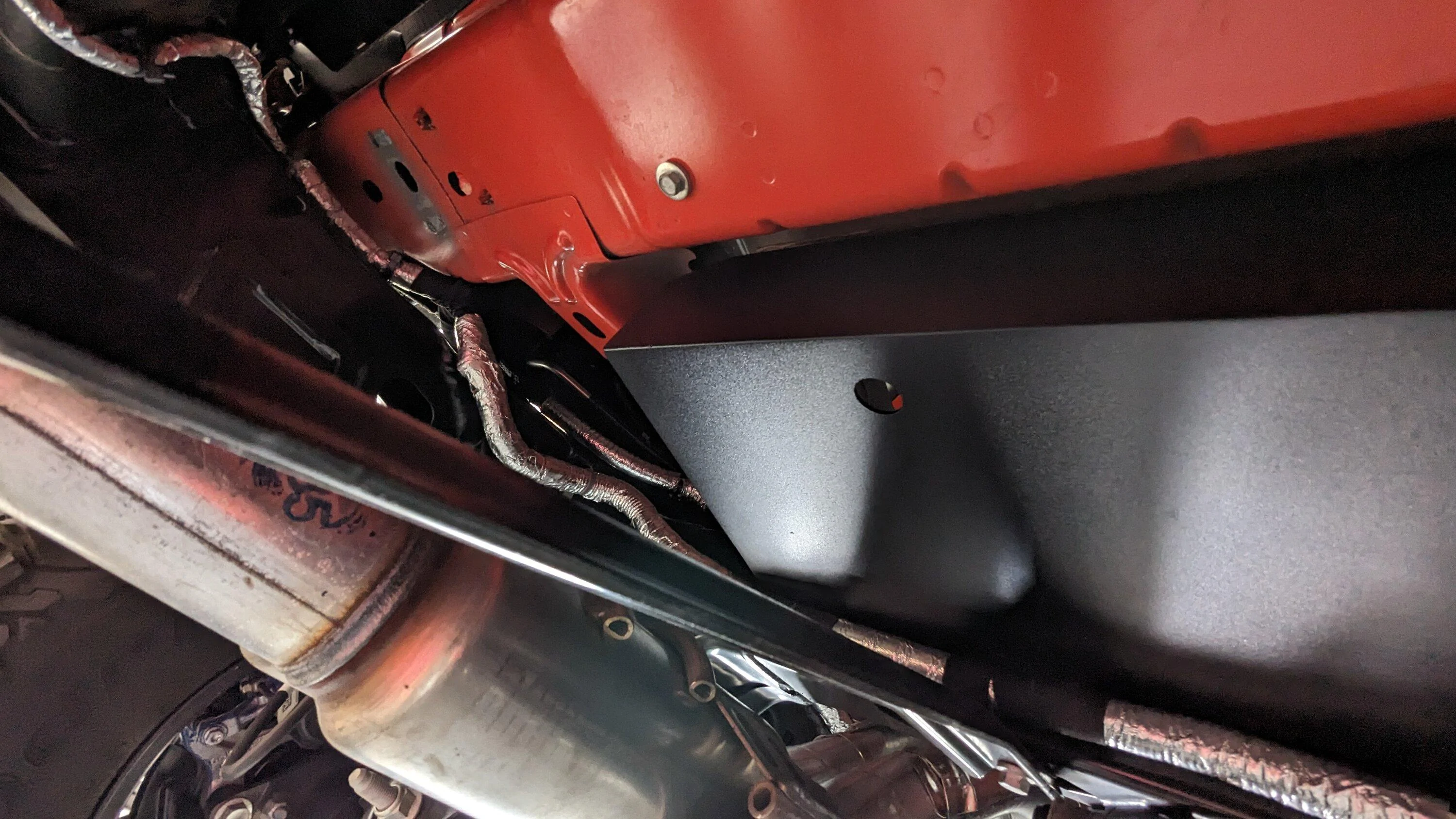

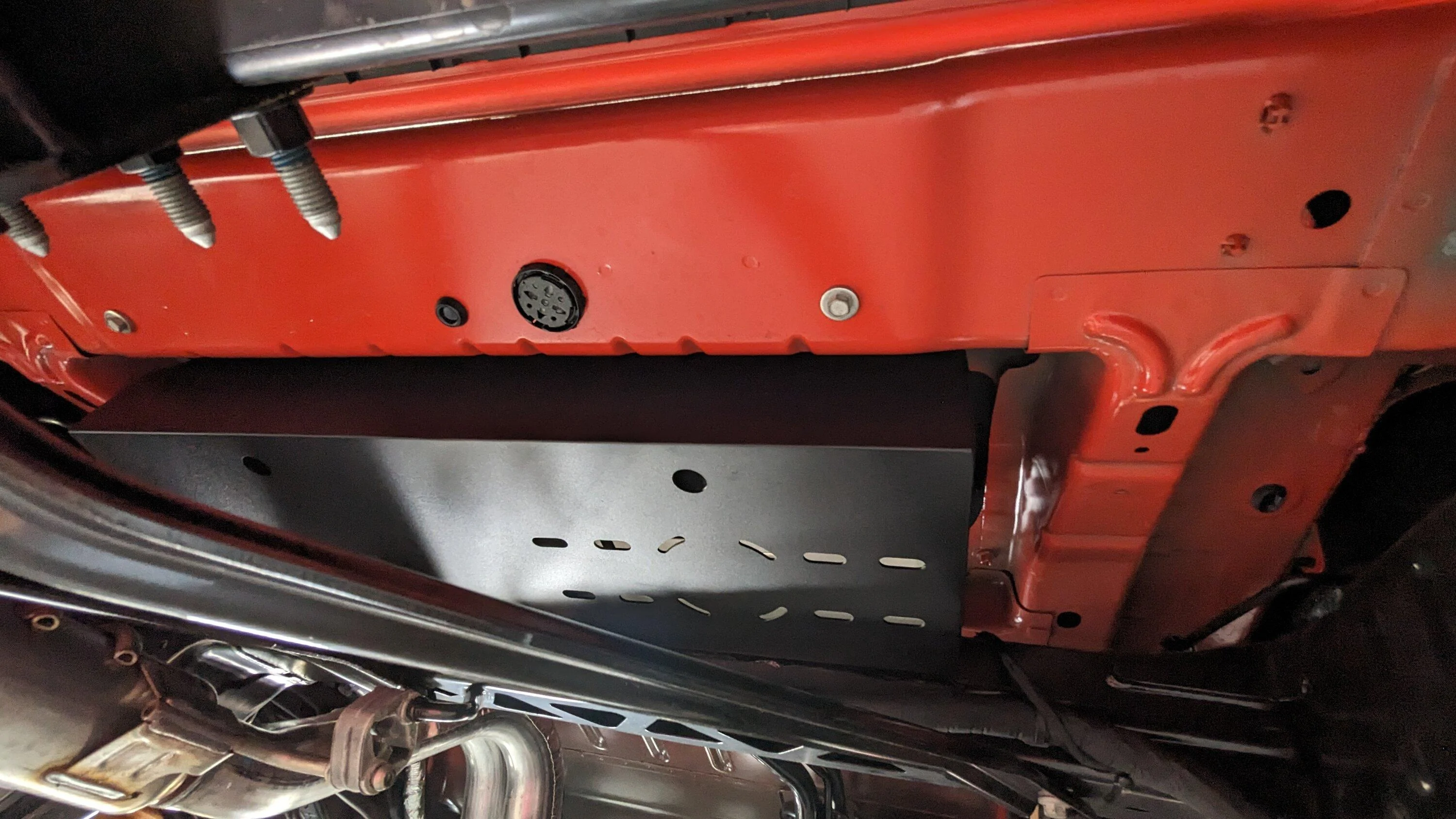

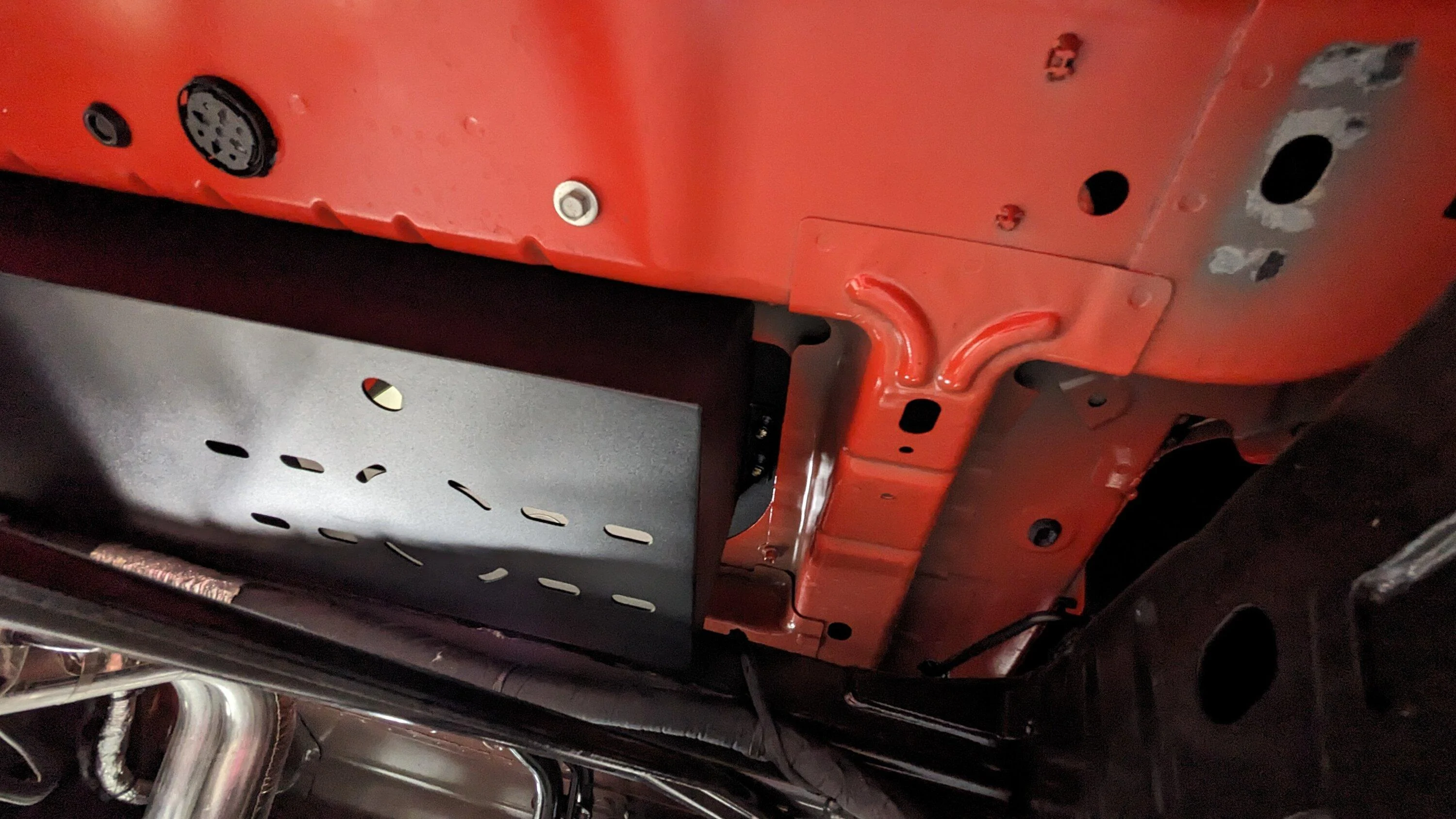

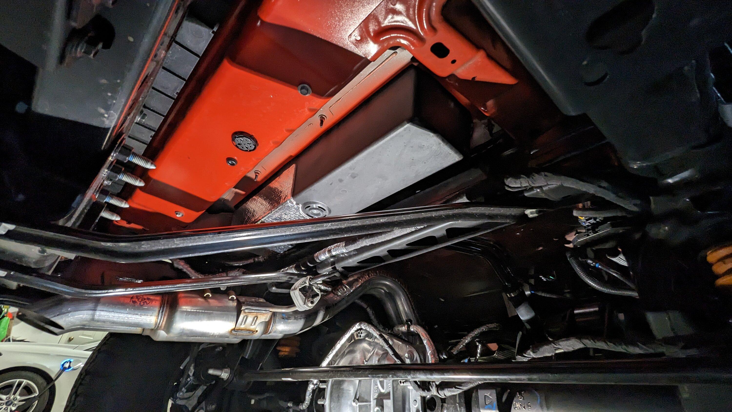

I just installed the DV8 air compressor storage compartment and it fits the Bronco Raptor perfectly fine. I do not see any clearance issues. The only thing that probably needs to be adjusted is the insulation tape above the exhaust to wrap up around the side as well. And by the way, you do not even need to remove the tow hitch brackets. You can insert the storage tray from the inside, wiggle it into place, pull it up and screw it into place.
Honestly - if I didn't have the slide out tailgate and had to remove it - I would've been done in 10 minutes. This is a must do if you are looking for a compressor mount.
@DV8offroad let me know if you need any help with test fitting other Raptor goodies!
Now to find an air storage tank that fits up there
That is awesome!
Although now I have to buy that and the arb twin compressor and everything that goes with it!!!
Ohh well, another project to do!
Are you going to try and put a tank in the storage compartment or some where else?
Looks like there would be room underneath in front of the pocket for a tank out of the way.

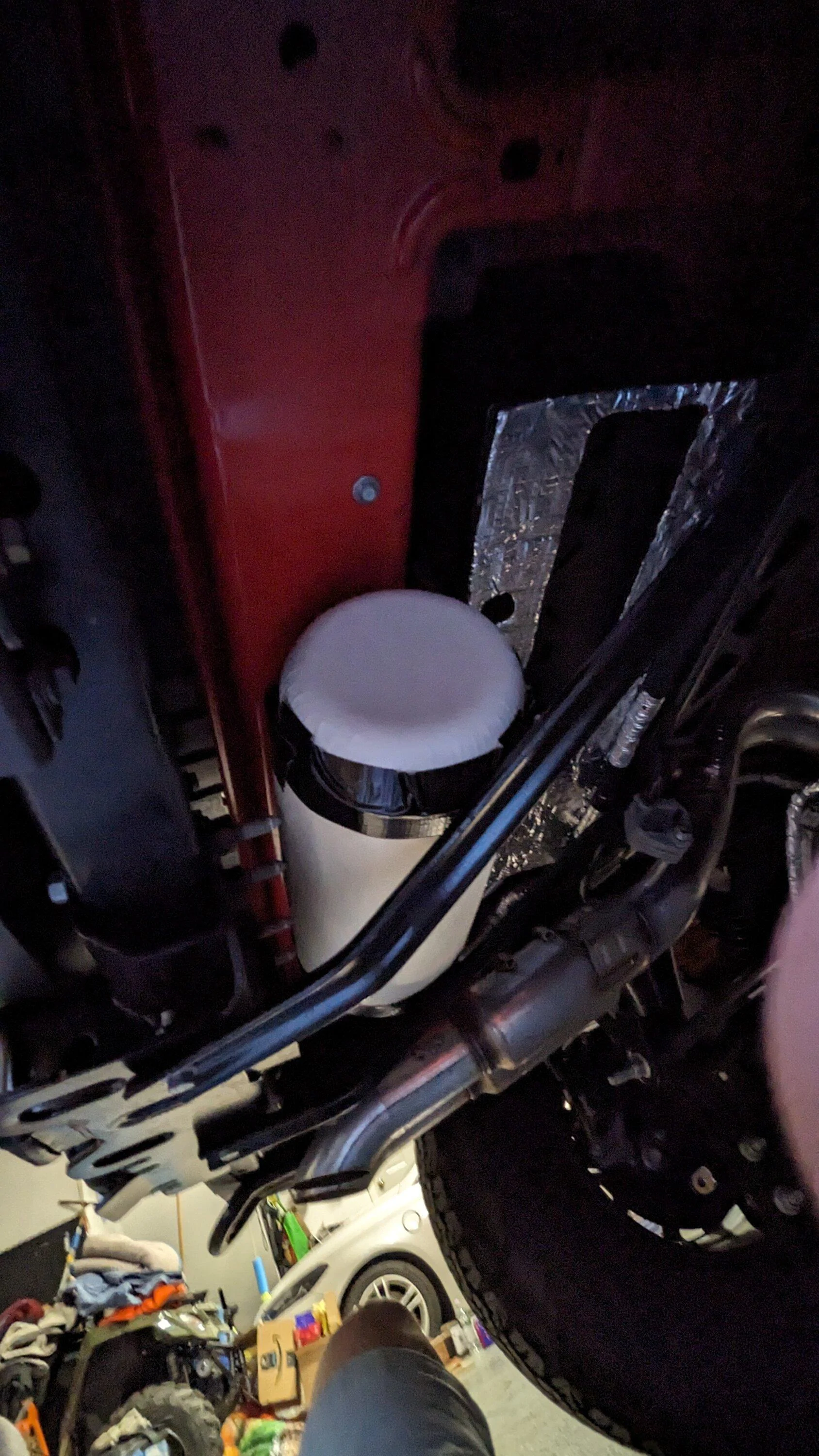

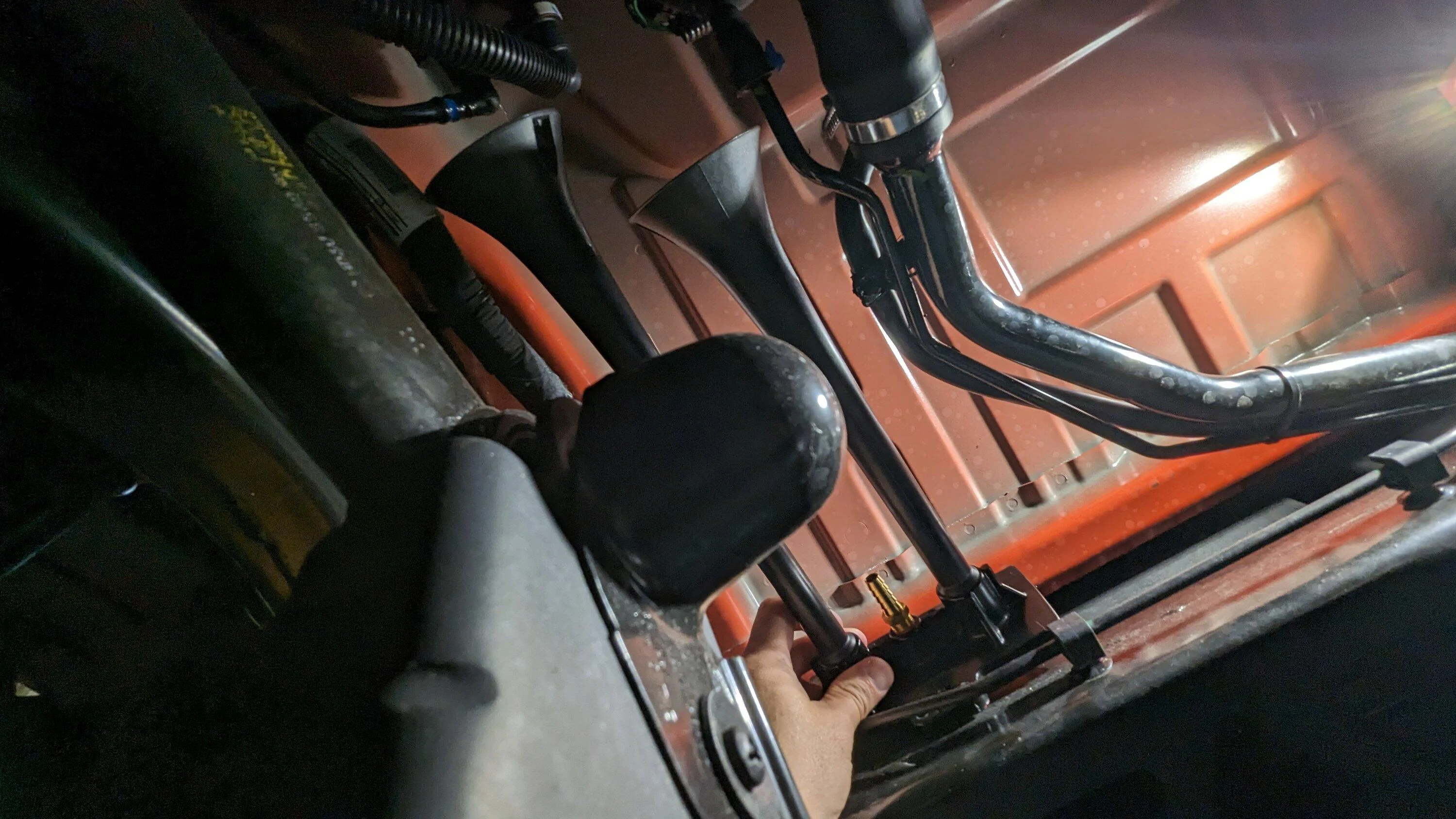

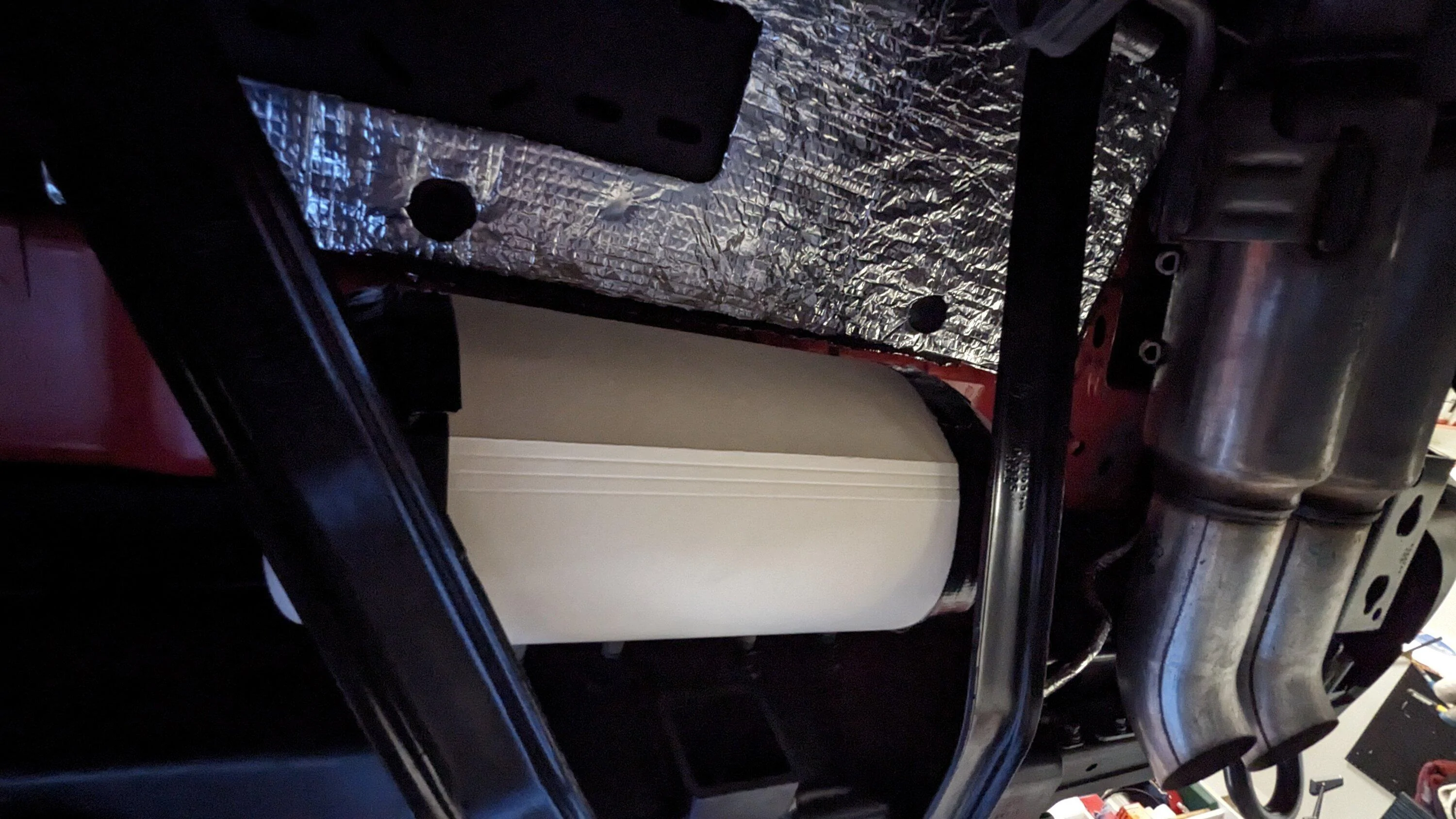

I think I can get a 6" diameter tank right behind it. Otherwise there's lots of room up under / along passenger frame rail. Yep 6-7" tank will fit right behind the tow hitch area - now to figure out bracketry so that my tank has a low port for drain. Then once the big parts come in - where to put pressure regulator/water filter, horns and air chuck.

Haven't gotten around to installing yet just doing some mockups - BUT I am definitely leaning towards turning the compressor around so that the air filters are easier to reach. I don't know what that's going to mean from a wiring perspective, but that is my thought initially based on my first test fit according to the DV8 instructions.
I am also thinking about installing a set of soft or medium soft rubber feet in between the storage compartment floor and the compressor mounting bracket to hopefully absorb some of the vibration and or noise.
As far as other accessibility goes, I'm planning on having a remote air truck anyway so I really won't need to get at the compressor. I also have the slightly raised floor as a result of having the slide out tailgate.
I have a lot of things to consider because I'm also incorporating my air horns and I want to make sure that I have my factory horn as a backup. I will be running a 1/0 gauge battery cable all the way to the back with a power distribution block to power the compressor, but also having the storage tank and my air horns so quite a bit to sort out.
I will keep you guys posted though.
