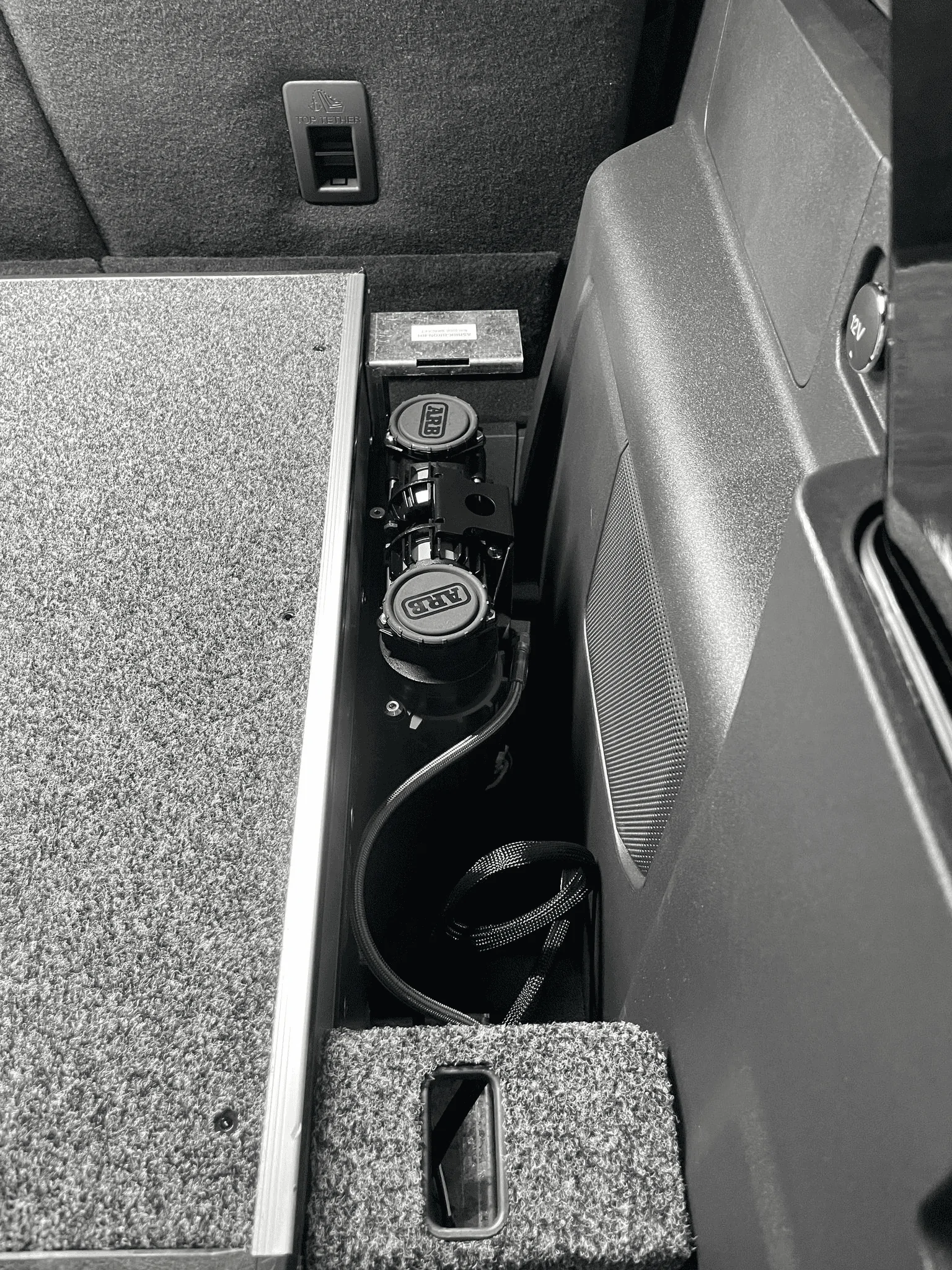

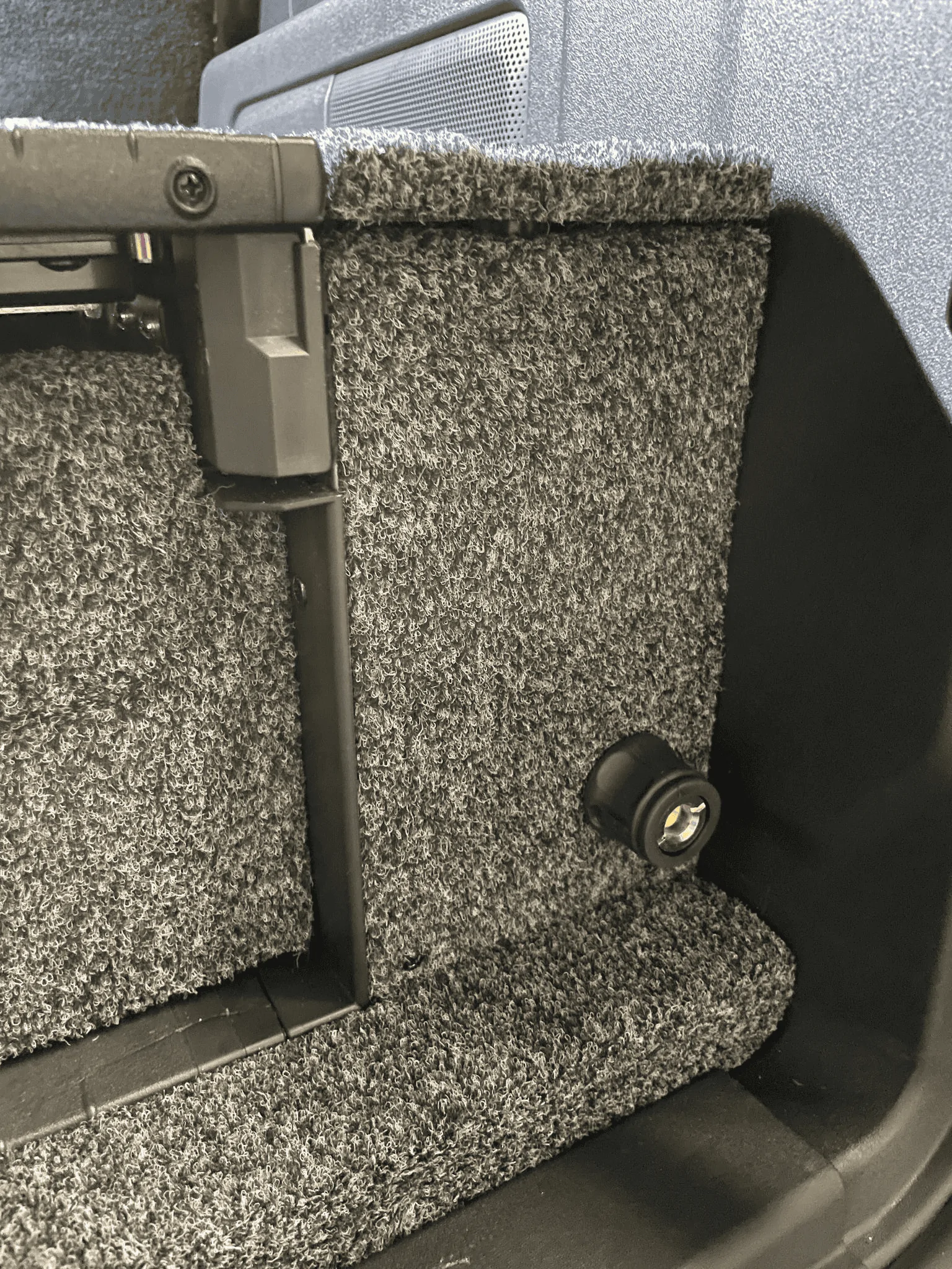

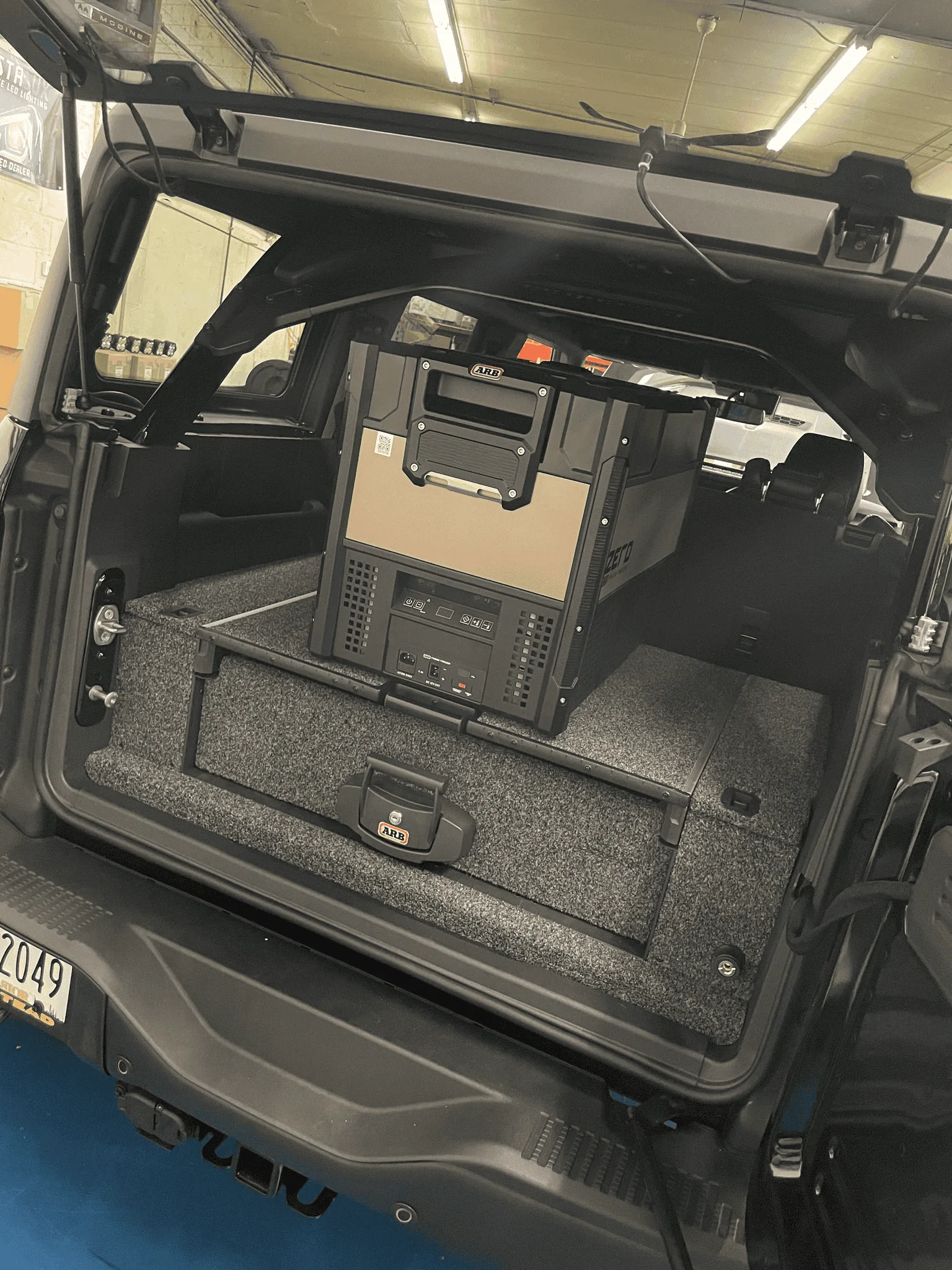

Anyway we started to do some mods to it of course. First up was the ARB Drawer System, an ARB Twin Compressor and an ARB Zero fridge.
We mounted the ARB Compressor to the side of the drawer system and ran a custom power harness up to the engine bay.

How high can you lift the lid on the fridge before it hits the roof?
I have the exact same fridge it looks like it will be hard to look down into it the way it’s configured

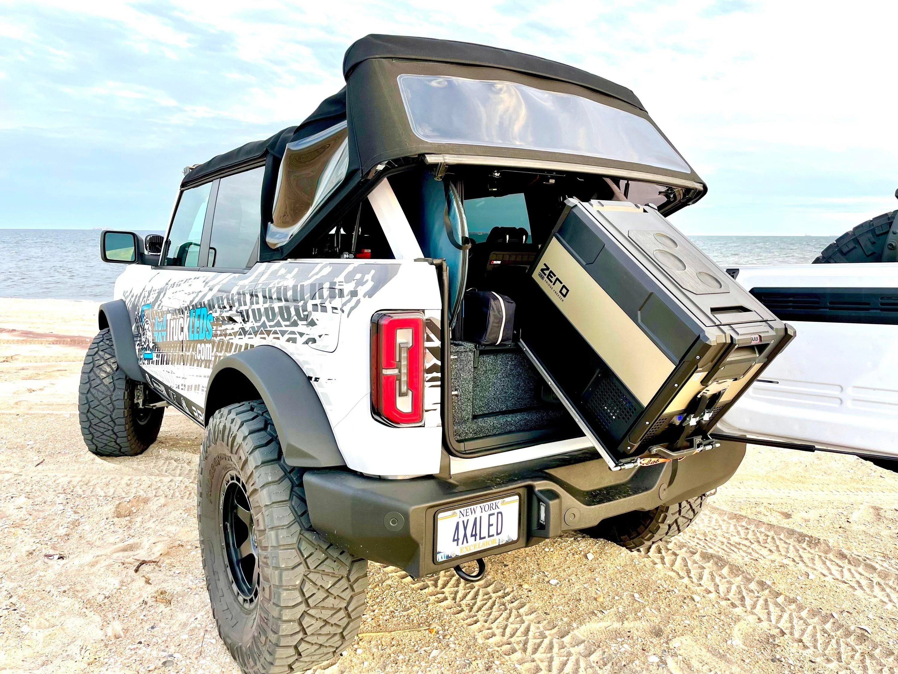

A few inches. Enough to get in and out of there. On my own truck I used an articulating mount so I can have complete access to the fridge. You can also put a smaller fridge in. We put the biggest fridge in this supports

If you get a smaller fridge sure. This is a big fridge. The biggest the system supports. Obviously the bigger you go the harder it will be to access. We sell a tilt out system which pivots the Fridge though. OR you can do a smaller fridge and have access.
Do you guys sell this tilting mount now?
