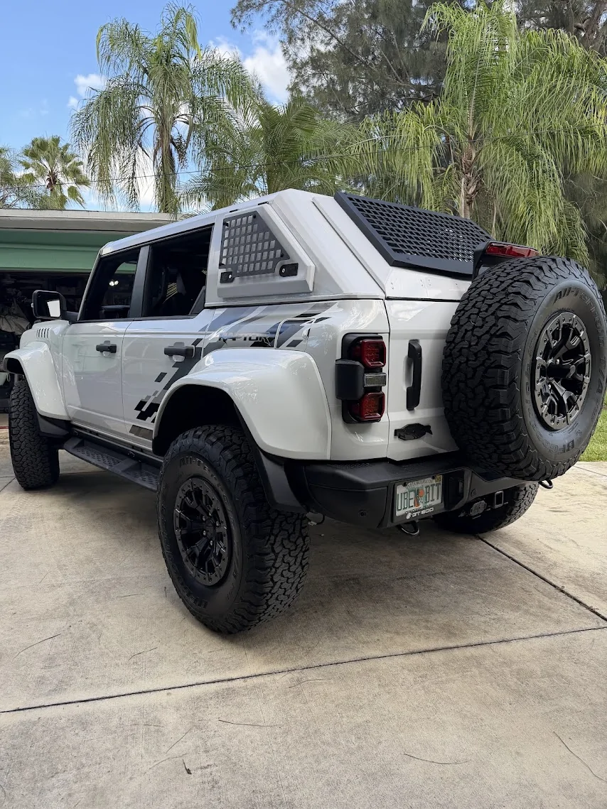

@TheLawnDart : Very nice review. I will agree with what you said here, though the point of taking the top off was never a concern. I had the soft top and never really took it back. In Miami, even our "winter" months, it's just too hot and sunny to have the top down like that, well, at least for me.
Now that I have the Braptor, I thought there may be an issue with using my top because, like you, I was early on to receive. So I did not get the tops that have the Raptor cut out, but Fabion informed me that using my DV8 overhead moiolle and cross would solve any issue, and I would still have the cross brace.
Loving my top and the unique look it gives.. The sturdiness of it, and how quiet the ride is are pluses. Like you, I lose a little space, but I have adapted to this and have resolved what this challenge brings.
It may cost more, but this top will outlast the Bronco. I am happy with my decision. It was well worth the wait.

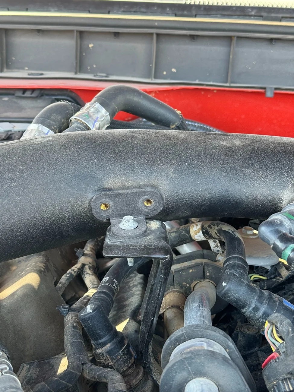

First thing to go wrong was 2 bolts holding the piping in place came completely out. I tightened them during install, but didn't use any thread lock since it was not mentioned or recommended in their install instructions. Once they shipped me new ones (which was very kind of them) I used thread lock and have had no issues since.
Next was the lid. Holy smokes the stupid lid. Supposedly they made the first batch of air boxes 1/16th of an inch (or something like that) too thin. So with moderate offroading the lid would get SLUNG around the engine bay. It caused superficial damage across the engine bay and caused the filter to get ruined after only a month or so of ownership. When I told them, they said they would send me a new lid, but not replace the air filter ($69 gone). After asking them again a few weeks later (they forgot) they sent me a new lid that was for a Ram truck. They then sent me the correct one after asking again. The lid came off again shortly after and got ruined again, I didn't bother asking for a new one. Eventually they fixed the thickness of the airbox, but of course didn't announce this to anyone. So once I found out I requested they send me a new airbox so I could secure the lid. At this point, about 5 months had gone by and I went through another filter ($69 seeya), because the lid liked to travel around frequently. Albeit, without the lid the intake sounds amazing. The new airbox they sent was, again, not for my car so they had to send a new one. Now I finally had a lid that would stay on! After the 4th filter I bought a filter cover because I don't trust the lid anymore.
Next was the bracket on the top that holds the turbo intake to the engine bay. This was the same one that the bolts came unthreaded. After some moderate off-roading the entire bracket sheared. I told them this and they (again, very kindly) sait they would sent a new bracket. The new one had an opening way to wide for the bolt that is meant to hold it in place (as seen in the pictures), so I asked them for the correct bracket that fits the OEM bolt. They sent me another bracket that was, yet again, for a completely different car. I ended up just buying a new bolt with a wider washer plate on it to make it work.
The last bit of annoyance, other than scraping the absolute piss out of your hands whenever you change the filter out, is the actual rubber intake portion. Luckily you only have to change the filter out every 6 months or so if you have a functioning lid. The rubber flap in the front is secured with 3 clips that come out frequently. 2 of the ones in the picture below are missing the bottom portion because they were ejected into my engine bay and into the oblivion. They might have changed this design since, but I'm not positive.
Overall very poor experience with the product, but at least their inept customer service is willing to help out, it looks good, and with a proper tune will add some gains.

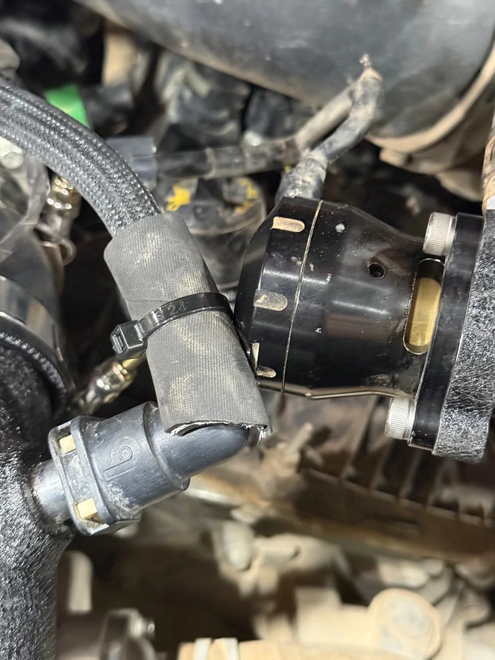

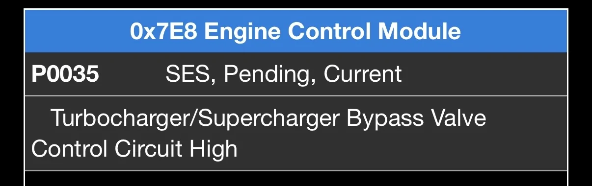

Not a long one, but yes! I bought this Turbosmart Blow Off Valve (BOV) almost exactly 2 years ago. Install takes 10 minutes, feels solid, and works (well, worked) as advertised. Many people have commented on loving the agressive sound it makes. After about a year it started popping a code shown in the picture below. I’m not the only one that was experiencing this, around the same time a few others were getting the same code. I was able to get it to clear a few times by removing the BOV, cleaning the wiring harness, and reinstalling. Sadly it kept coming back and would throw check engine lights at inopportune times (always in the middle of off-roading).
Debating on buying a new one, I decided to ditch that sweet pshh sound and keep my factory recirculating valve. Theoretically it provides more performance anyway since it’s putting that same boost pressure back into the turbo cold side, but I’m willing to bet it’s negligible. It also provides more space for the CVF charge pipes, a future review.
