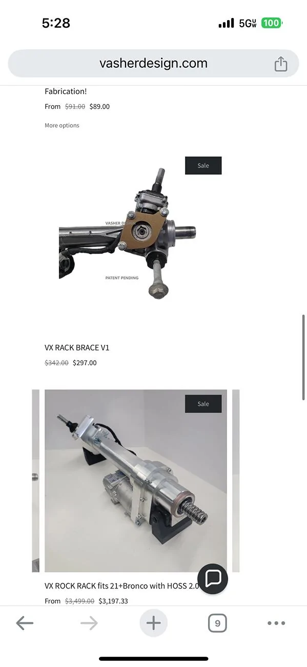

Its unfortunate the RC and VX Off-road versions appear to have gone the way of the dodo… oh well.

Indeed… but the bushing is MIA. And repeated attempts to contact have been ignored, so… yeah. I can read between the lines regarding possible external pressures being applied. Like I said, unfortunate.
It's a bummer. No way I'm spending $300 on a bushing. :(
