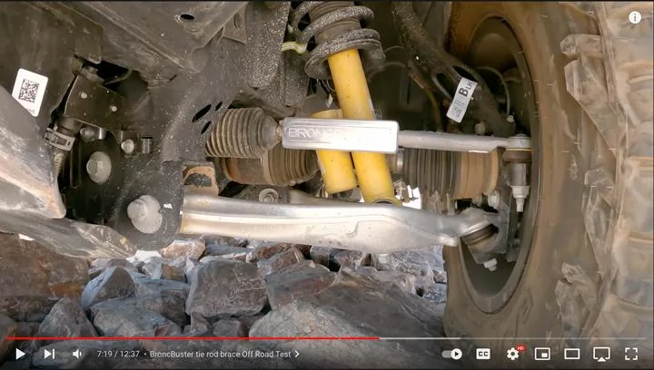

In today’s video, we highlight the BroncBuster bushing and tie-rod brace and how it can help keep your new Bronco tie-rods from snapping under trail pressure. We highlight some of the install then go into some trail reviews of the product. We hope you enjoy!

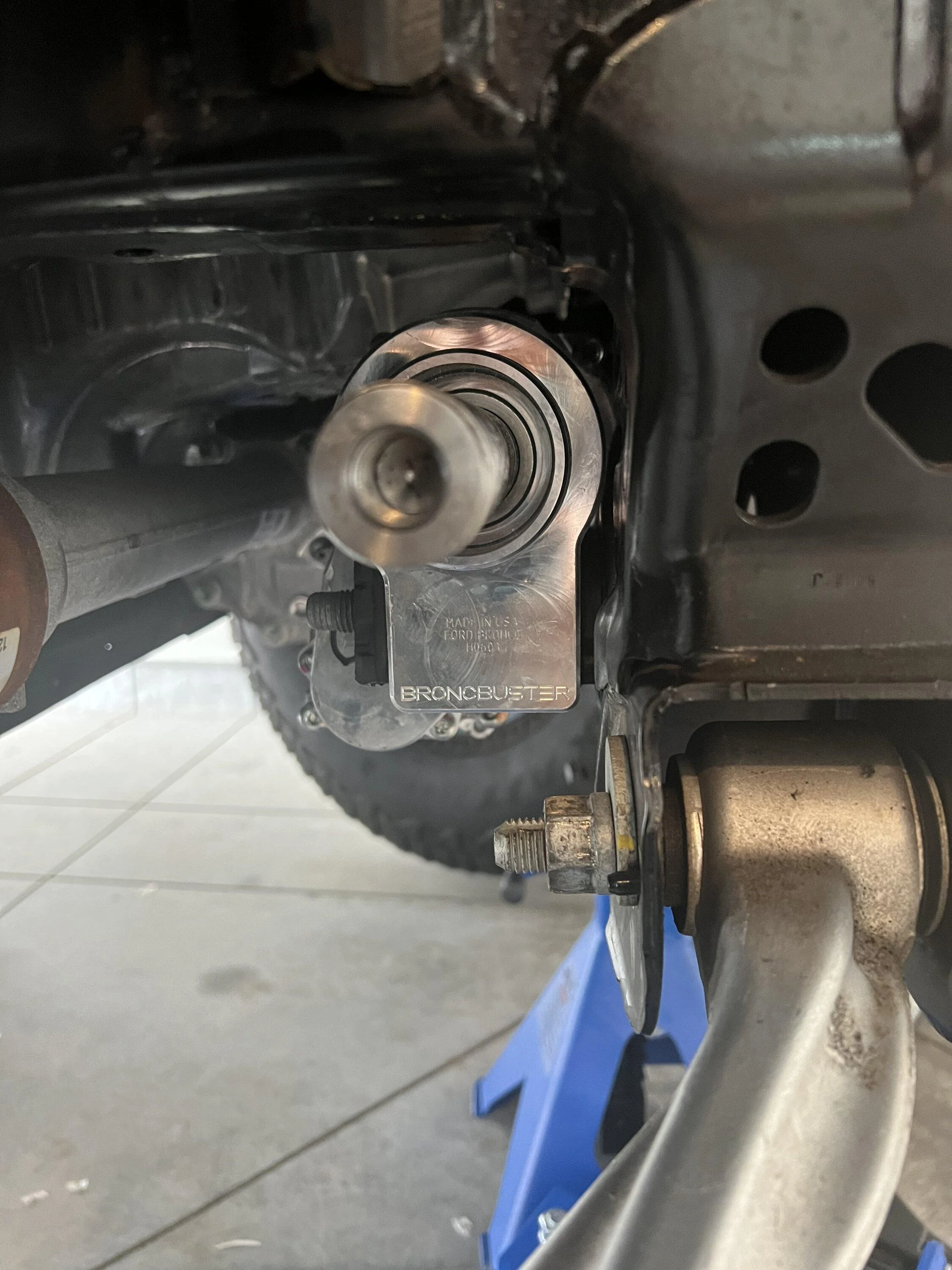

Here it is installed.
Ford Bronco BroncBrace & BroncBushing OFF ROAD TEST 2A303AD4-B0D8-4C9D-9407-3CE48C775E27
I was going to make a thread on the install as there’s a few bits not covered in the video that can be tricky, but figure most people doing this themselves will be more mechanically inclined than me anyways. That, and for some reason, Tyler seems controversial on here to say the least.

Looks good, did you find any metal shavings or wear when you swapped it out. Reason I am asking is after watching the video I tore mine down and seen no sign of wear. So I haven’t bought the housing yet.

Noticed a couple shiny bits of shavings, but nothing after that 1 clean out cycle. Housing didn’t show any cracks or obvious rubbing parts either. Chances are, we won’t be seeing this type of wear anytime soon unless you’re really hammering it. Remember, BroncBuster is running 40s likely on an ungodly amount of suspension lift, and wheel spacers thrashing in the place where broken everything is common on even on the most built rigs. While 100% of us will not be showing our rigs that level of abuse, his accelerated wear does give us a glimpse of what we *may* see a few years down the road if wheeling a lot.
another thing to keep in mind is that he’s had his rig with the bushing for months, and never had this issue, while most of us only just got our broncos.
I Installed at 3k miles running 3” of lift, 37s, and I’m easy on it when I go offroading (not trying to be the Guinea pig on a first year vehicle). The steering never binded up on me before, but I still bought it because while I won’t be keeping this particular bronco for awhile, it’s likely I’ll be having one for a long time to come. The part is expensive but im looking at it as long term insurance I can always transfer to another rack later. One thing I will say is the steering did get slightly tighter after the install. Not first batch bushing tight, but it is noticeable.
my theory is given enough time (talking years so don’t get alarmed reading this), anyone who does anything more than service roads with anything that changes the tie rod angle will experience this as it’s a fundamental issue with the rack not keeping the ballscrew in place on hits/flex while turned. If you’re not gonna be keeping your Bronco more than a few years, and you’re not a skinny pedal user, I don’t think this is anything to worry about.
