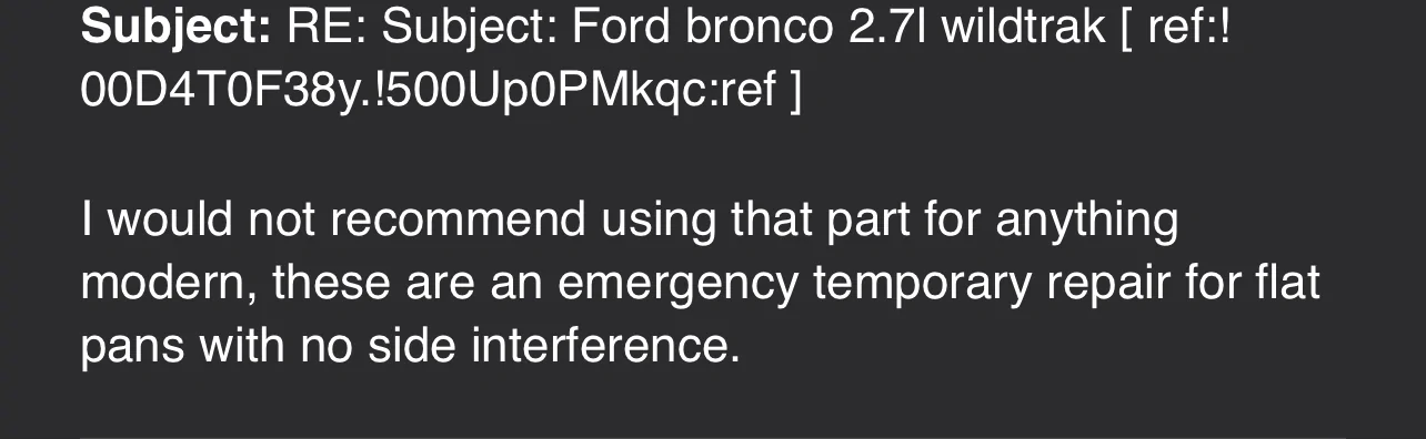

Small update, just got this email from Dorman technician
Ford Bronco Broken thread on my oil pan IMG_0263
