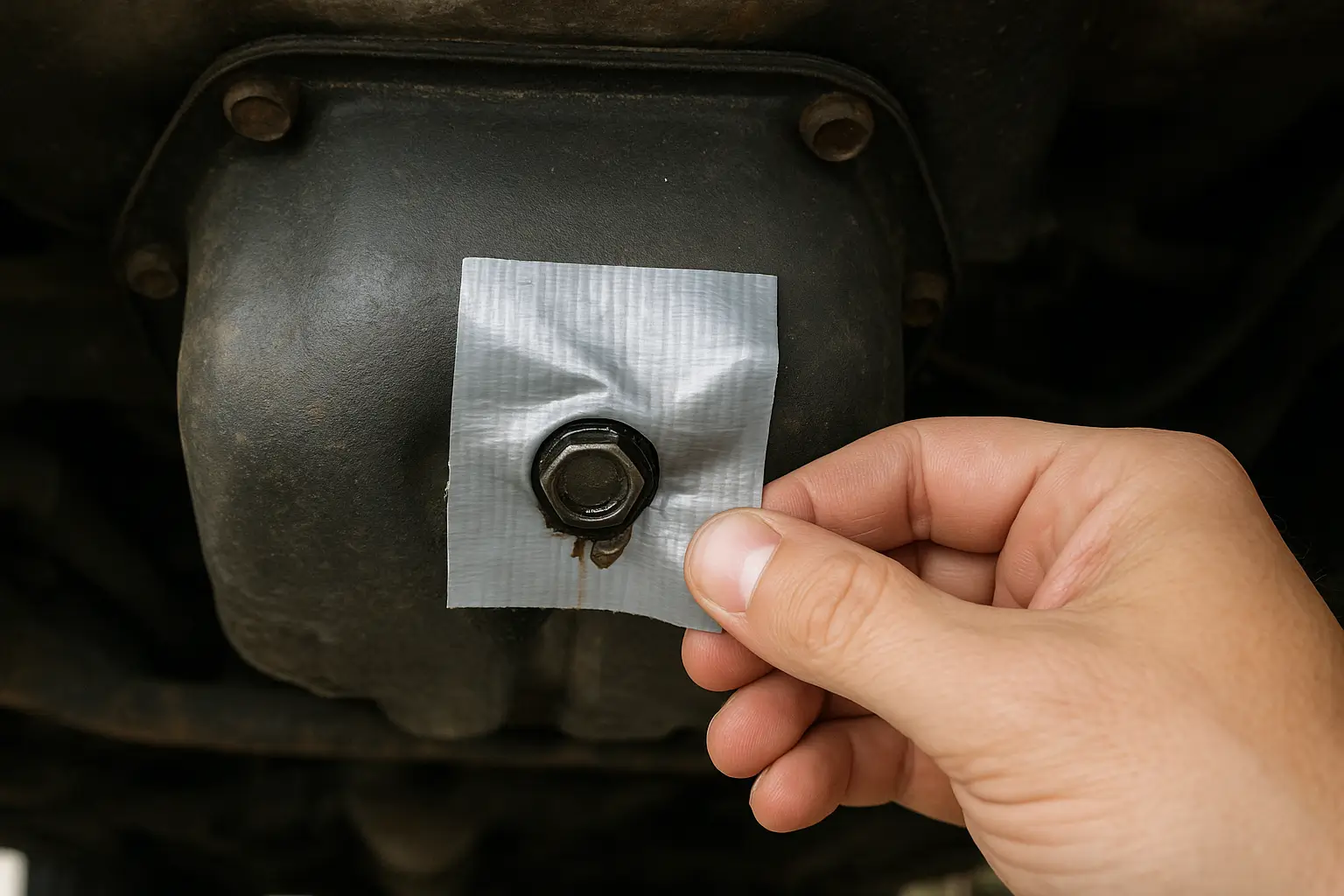

Ford Bronco Broken thread on my oil pan 1757704638661-lc
Duct tape.
