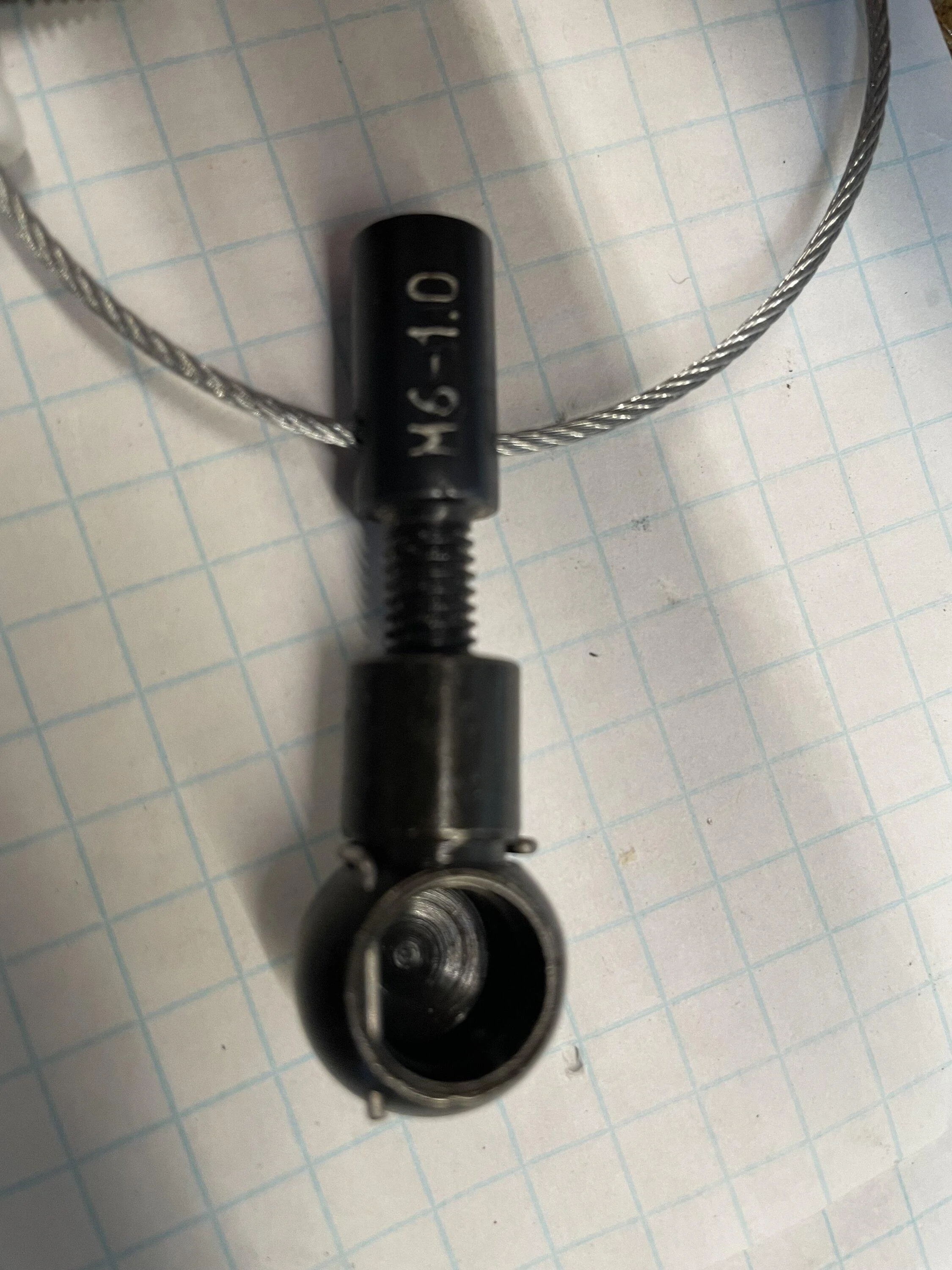

I just received my order of these replacements, they are NOT the same thread as the struts. The replacements from this company have a M6-1.0 thread.

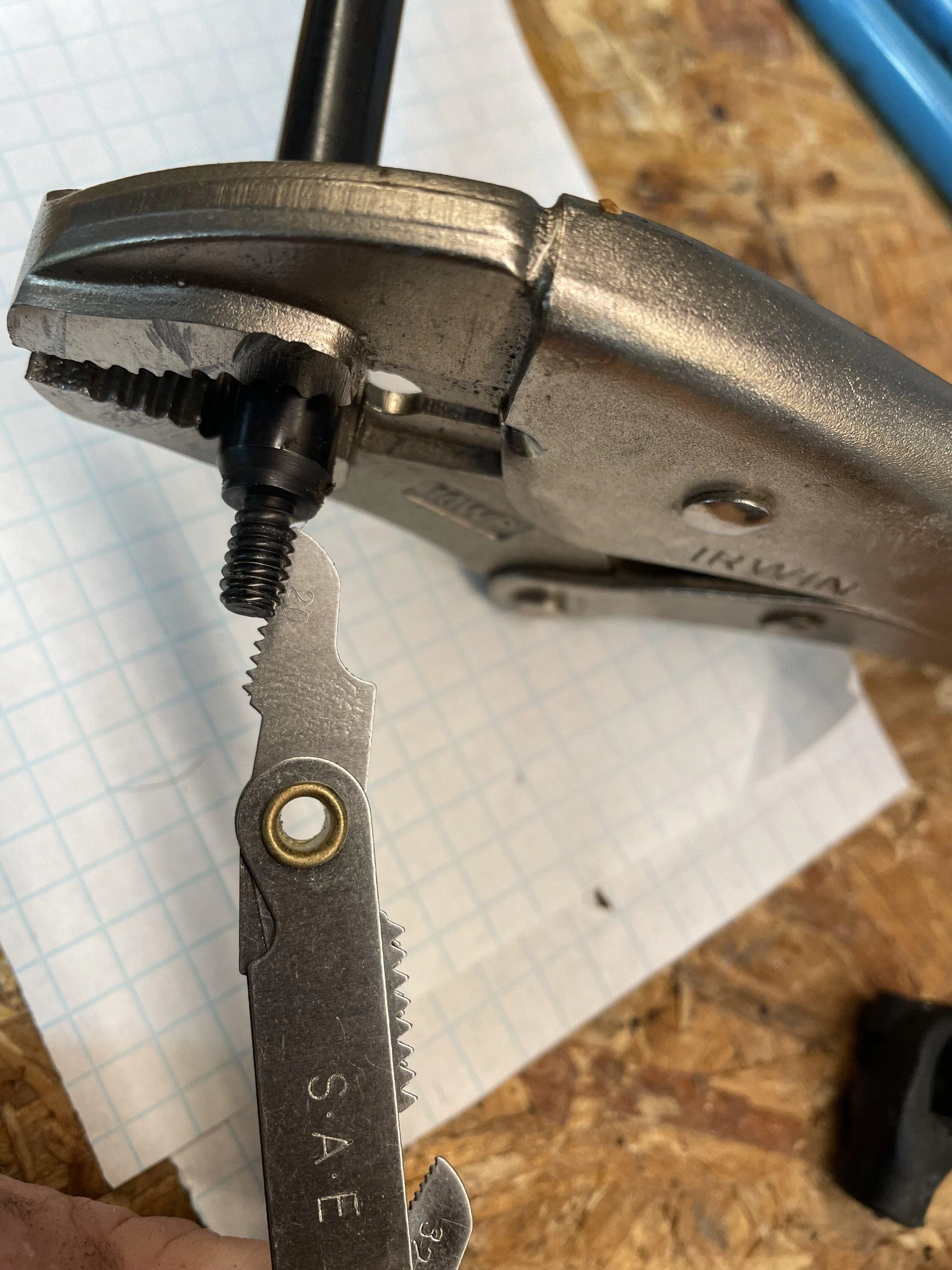

I checked the OEM strut thread is a SAE 20 count #10.
my FORD OEM clips haven’t broke yet, but would rather have a set of steel ones.

It looks like one end utilizes a 1/4-20 and the other end uses a 5/16-16 end. (note I don't have calipers to measure, but am not familiar with a SAE 20 count #10 size fitting. Did you ever find steel ones to replace the factory plastic?

Nope, I used the metric metal and forced them on
