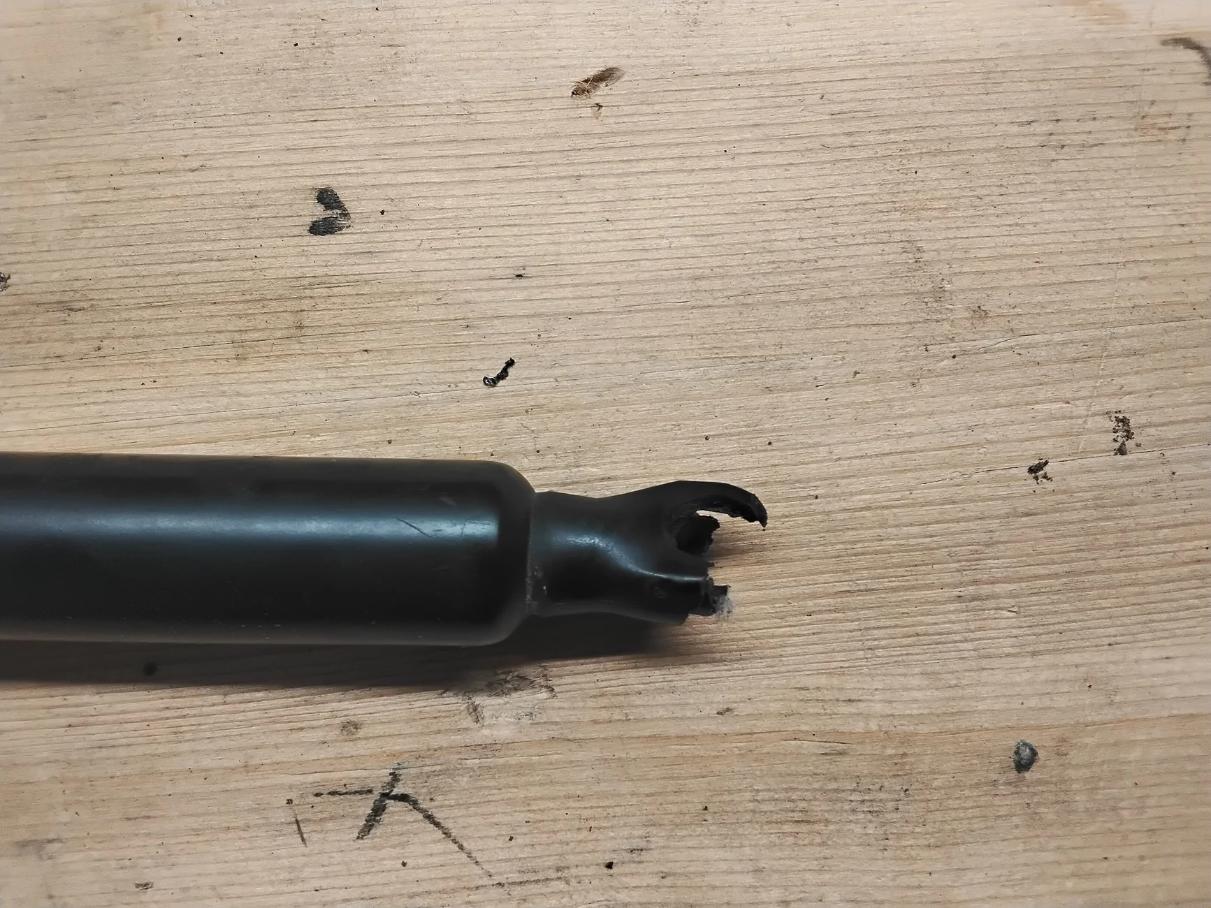

I went snow wheeling this weekend and had a ton of ice build up on top of my rear bumper. Yesterday when opening my tailgate, the end that attaches to the ball above the bumper came off and will not stay attached anymore. I believe that the excessive ice build up caused the strut to lift as it was being opened and closed, which caused movement in the end piece, rounding it out, thus preventing it from latching anymore
Mine has been doing the same for a while now. I ordered a new strut to see if that fixes it but it hasn’t arrived yet.
I was able to bend the clip inward a bit and it held “better” but would still pop out if you let the door swing open too fast and hit the stop

Ford Bronco Broken strut for rear tailgate (terrible design!) 20251005_111717
Mine just completely blew out... I brought the redlines ones and can confirm they don't fit, difference threads. (23 base, built in Dec 22)

I’m on my third OEM one. The ends aren’t breaking off, but they wear enough that they just start popping off the post.
I need to figure out a good way to do a safety strap. Having that thing go while parked at an angle is scary.
