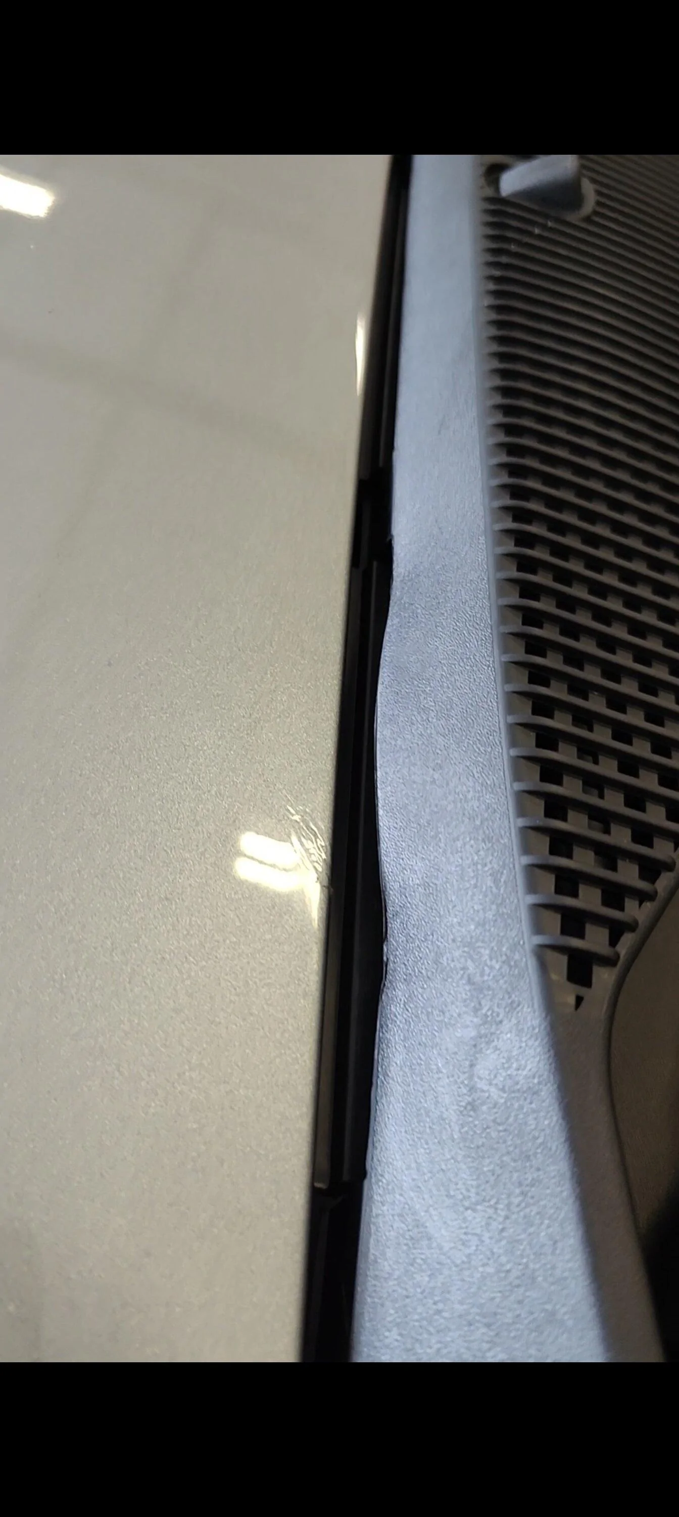

Blinker switch was ordered. Service advisor/Tech didn't listen to me when I said the cowl needs held down before raising the hood. The hood grabbed the cowl, mangled it further, and tore+wrinkled the clear bra. Tech blamed the issue on the hood being out of adjustment, being too close to the cowl and adjusted the hood forward, unnecessarily. Gaps between the hood and tie downs on the hood are now really close and the gap between the cowl is now large. The issue is that the cowl isn't properly clipping into the cowl housing, not that the hood is too close. SMH. Another cowl was ordered and I have little confidence they're troubleshooting the right issue. I left the dealer with more headaches to deal with.

Dealer replaced entire cowl assembly. It appears I was right. The housing that the cowl clips to was the culprit. Blinker stem replaced and now sounds normal.
I had quite the debate with the service manager regarding the damage to my hoods PPF. Everything was to blame, except the neglegence of their advisor and/or tech for ignoring my advice to hold the cowl down when opening the hood. It doesnt matter what events lead up to the point of the tech forcing the hood open, that single event caused this problem. In the end, it'll be fixed and handled, and the manager still thinks they're "taking one on the chin" for me by covering the repair.

My wiper cowl also ripped off earlier today when opening my hood. This is what prompted me to see the service department today. I was able to get the cowl back down and safely drive to the dealer. They also could not get the clips to seat correctly and scheduled an appointment next Saturday to disassemble my cowl and try to determine the problem. This cowl was just replaced by another dealer on Tuesday that had the same issues clipping down.

Asked my service advisor to inform the tech to hold the cowl down before opening the hood when they go to troubleshoot. Didn't listen. Opened the hood, hood caught the cowl, further mangling the cowl and messing up my clear bra. Their solution was to adjust my hood forward, claiming it was out of adjustment from the factory, causing the cowl to get grabbed. In reality, the only reason the hood snagged the cowl is because the clips aren't getting secured and the cowl is lifting up.
So I came out of the dealership with a messed up clear bra and my hood being adjusted forward unnecessarily. Swell. I had the advisor write on my paperwork about the clear bra damage and had it signed. It's claimed they have someone who will replace the clear bra, but I can't say I trust the previous clear bra to be removed (without further damage) and replaced with the same type. I am thankful the bra was there, or else I'd likely have messed up paint. Why is it so hard for people to listen? I told them how to prevent this headache before it ever happened. I have no confidence the next cowl will snap down and be secured properly, as I believe the piece it secures to is the problem. Queue the circus music.

Warranty work completely today. Final update above. For those that have issues with their cowl failing to remain secure, make the suggestion to check the box the cowl secures to.
