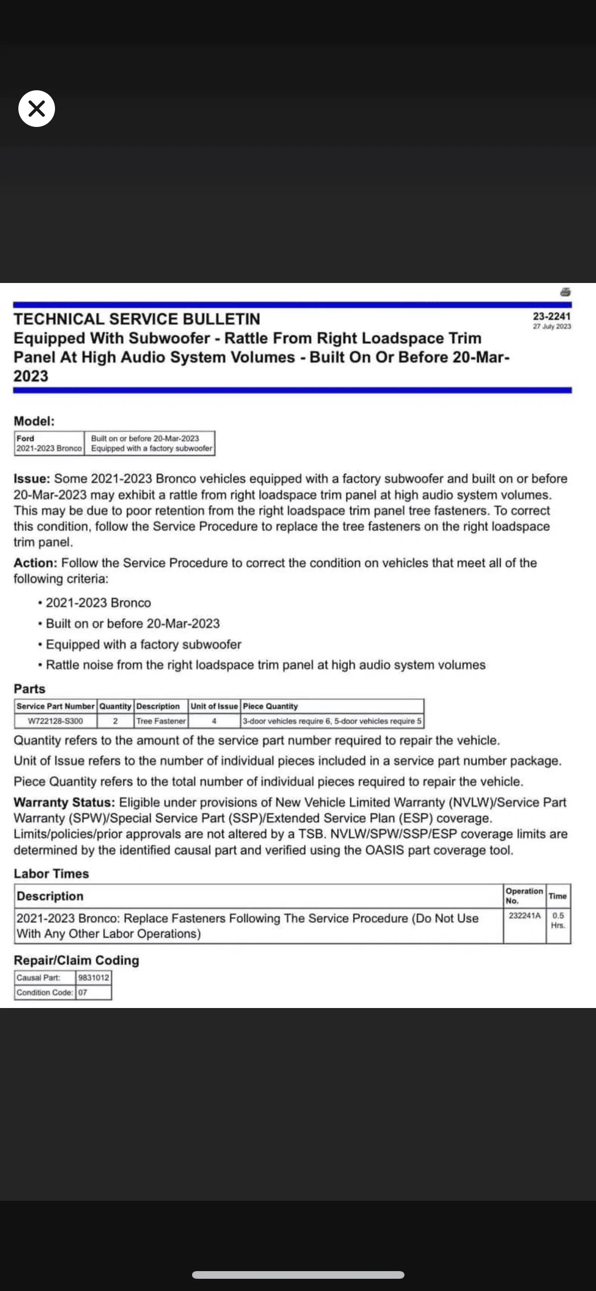

cmbyrd77
cmbyrd77
Cory
Apr 21, 2023
58
Orlando, FL
Thank you! Appreciate it! The TSB says it’s just a matter of replacing the hardware for the sub. May see what the dealer can do.
Boostedblues
Joe
Oct 26, 2021
211
322
Kentucky
2016 Focus RS, 2011 F-250, 2004 Ranger 2016 Fusion
I believe there is a TSB about the sub rattle. If so a dealer should fix it for free.
