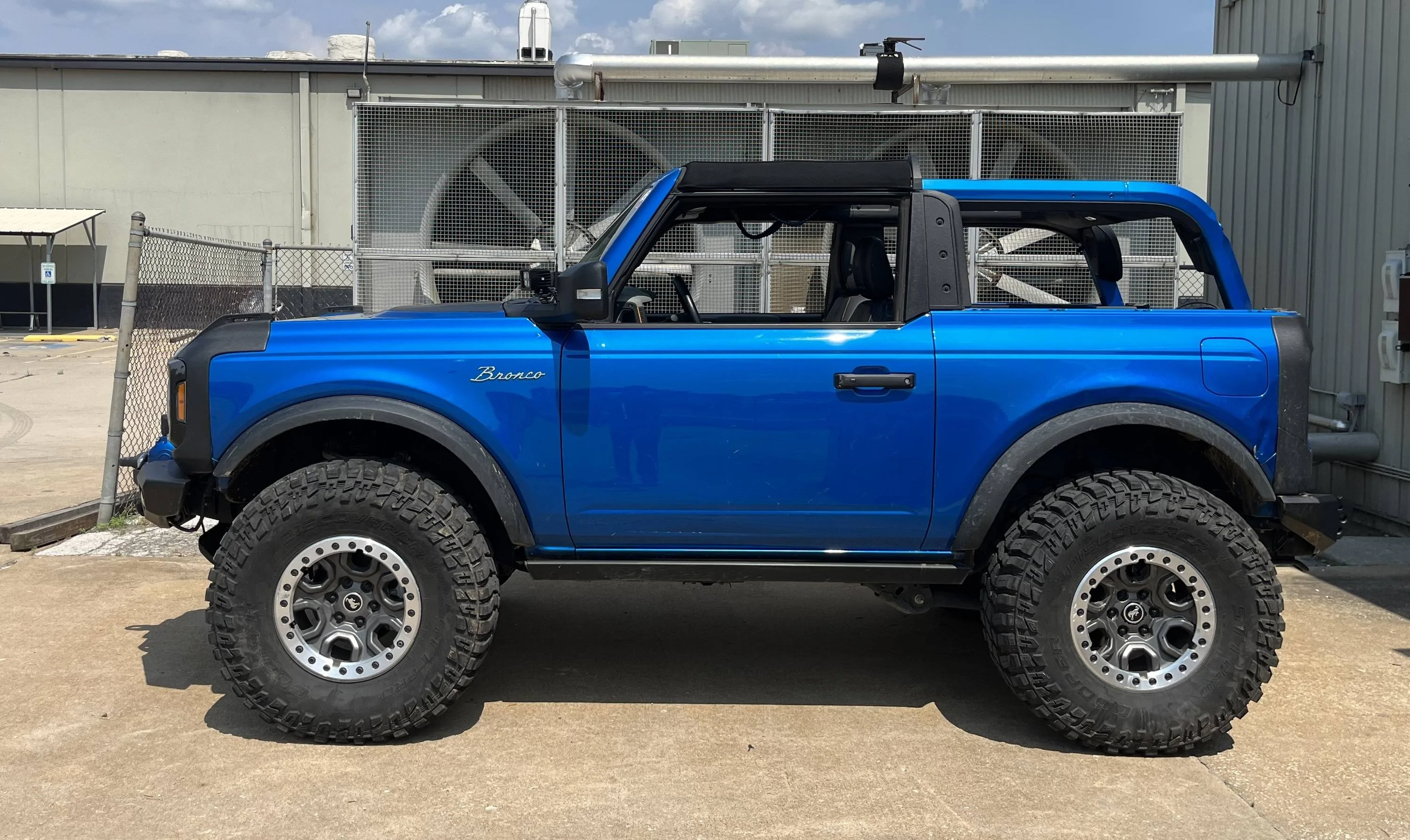

OP, judging from your Avatar you have the beadlock capable wheels with factory "beauty rings". Any tire shop in America can handle them.
I paid for the extra Ford Performance beadlock rings and I would only trust 1 tire store in town with mine.
Welcome to the Bronco club!!
