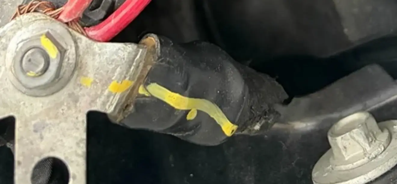

You can’t see in any of the pictures - are you certain the main battery line was cut? That would be … very very unusual

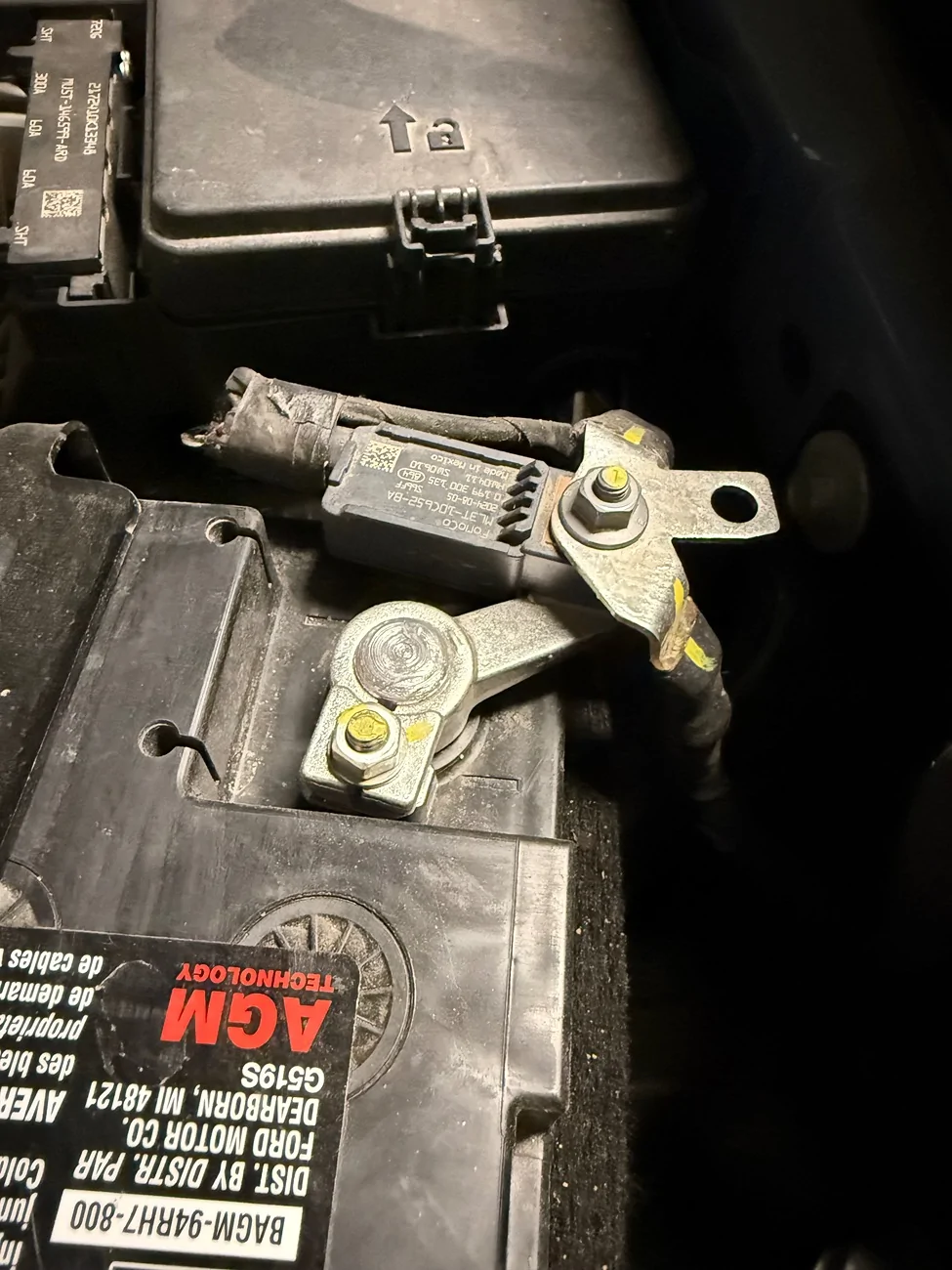

It’s very hard to see, but it is cut:

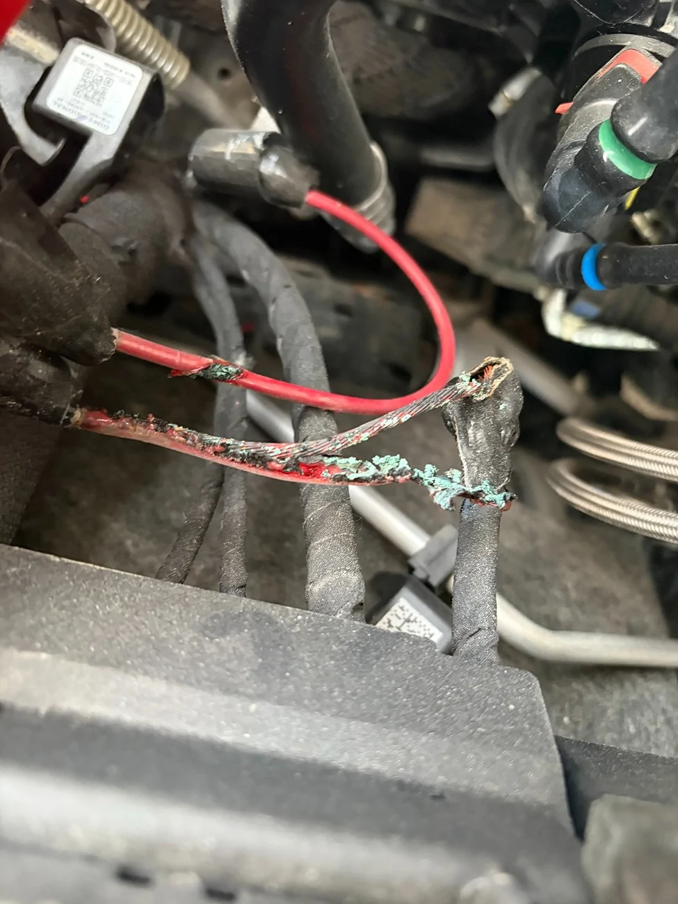

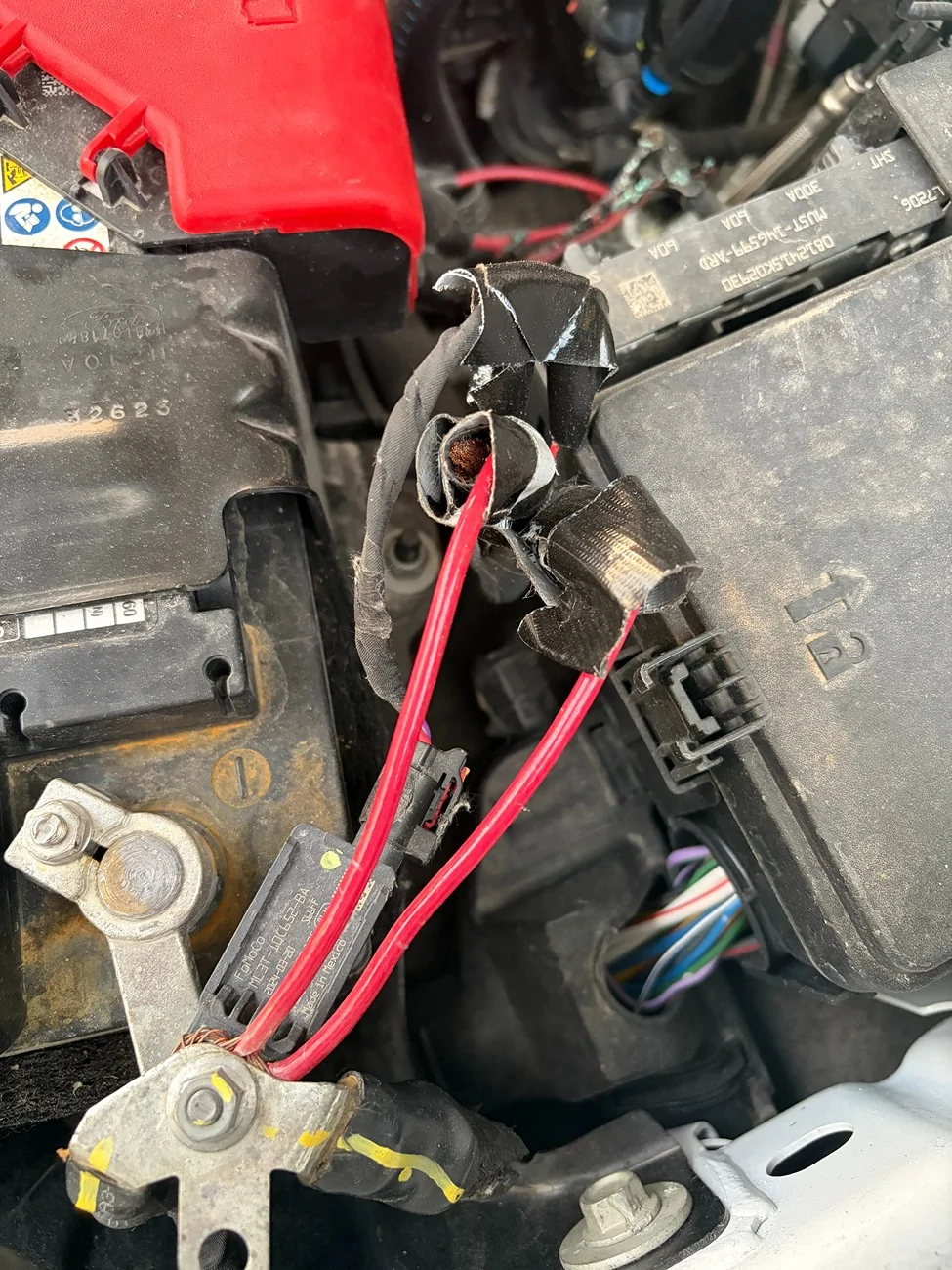

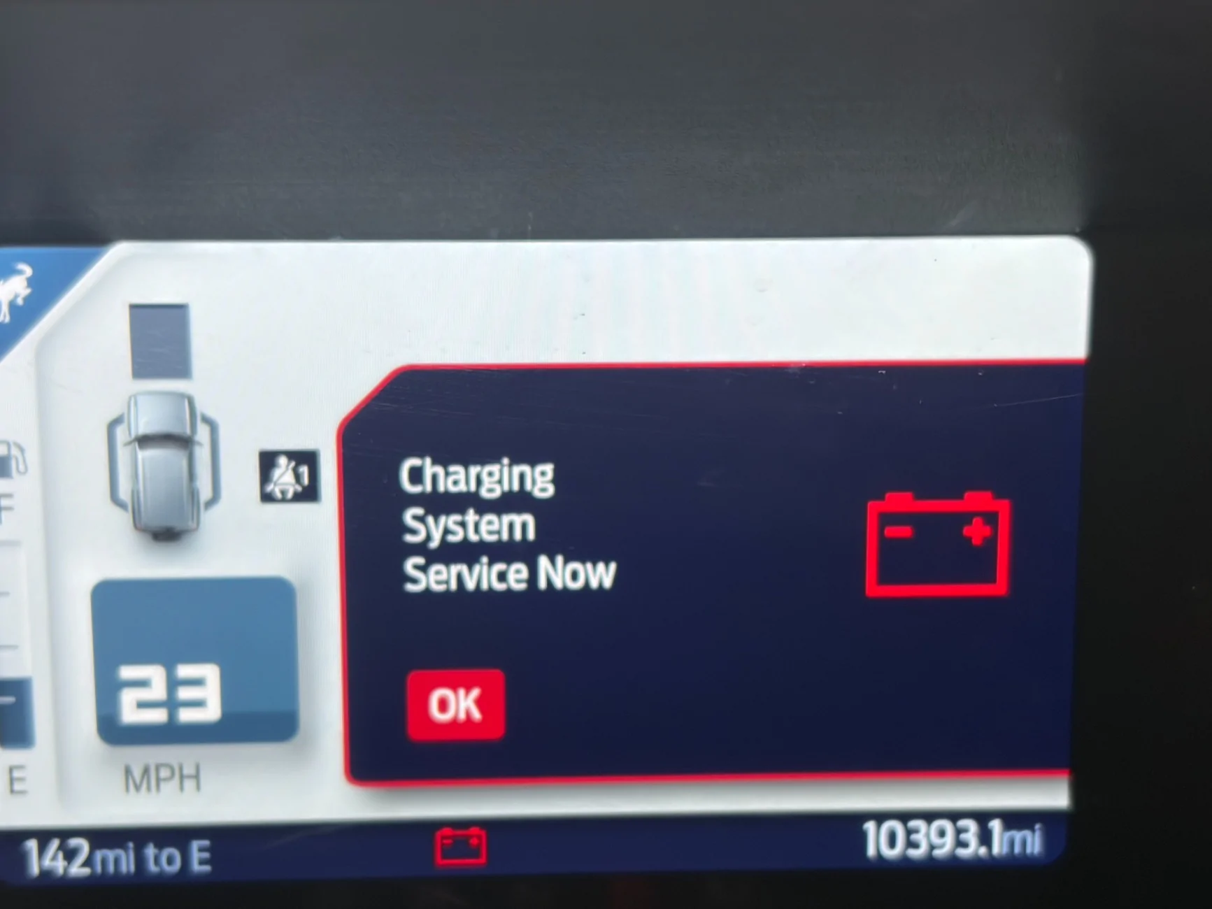

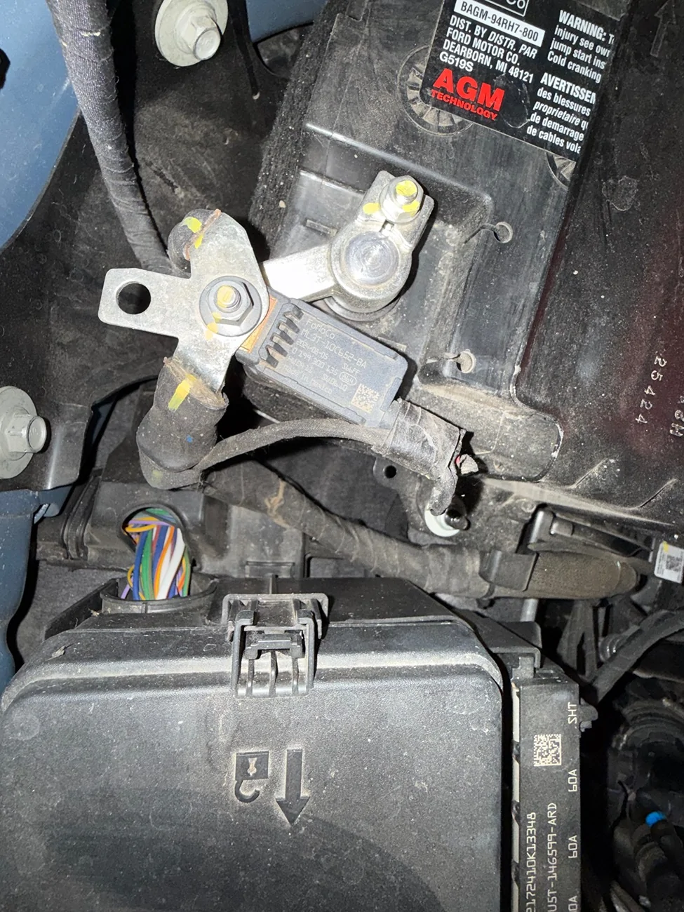

I bought a 2024 Bronco last month, and yesterday I got a “Charging System Service Now” message. After I opened the hood to check the battery, I found that the battery cable had been cut and the battery was connected with small wires, and those wires had melted. I was wondering if you have any idea how to fix it

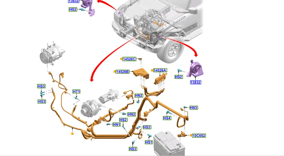

Honestly looking at that, thise red wires aren't supposed to be there at all. Is this a 2.7? There should only be 2 big wires coming off the negative terminal plus the BMS wires. Like Ducati said it does appear the cable has been cut. That wire is part of a big harness. I would take it to an audio shop if you don't feel comfortable repairing that yourself.

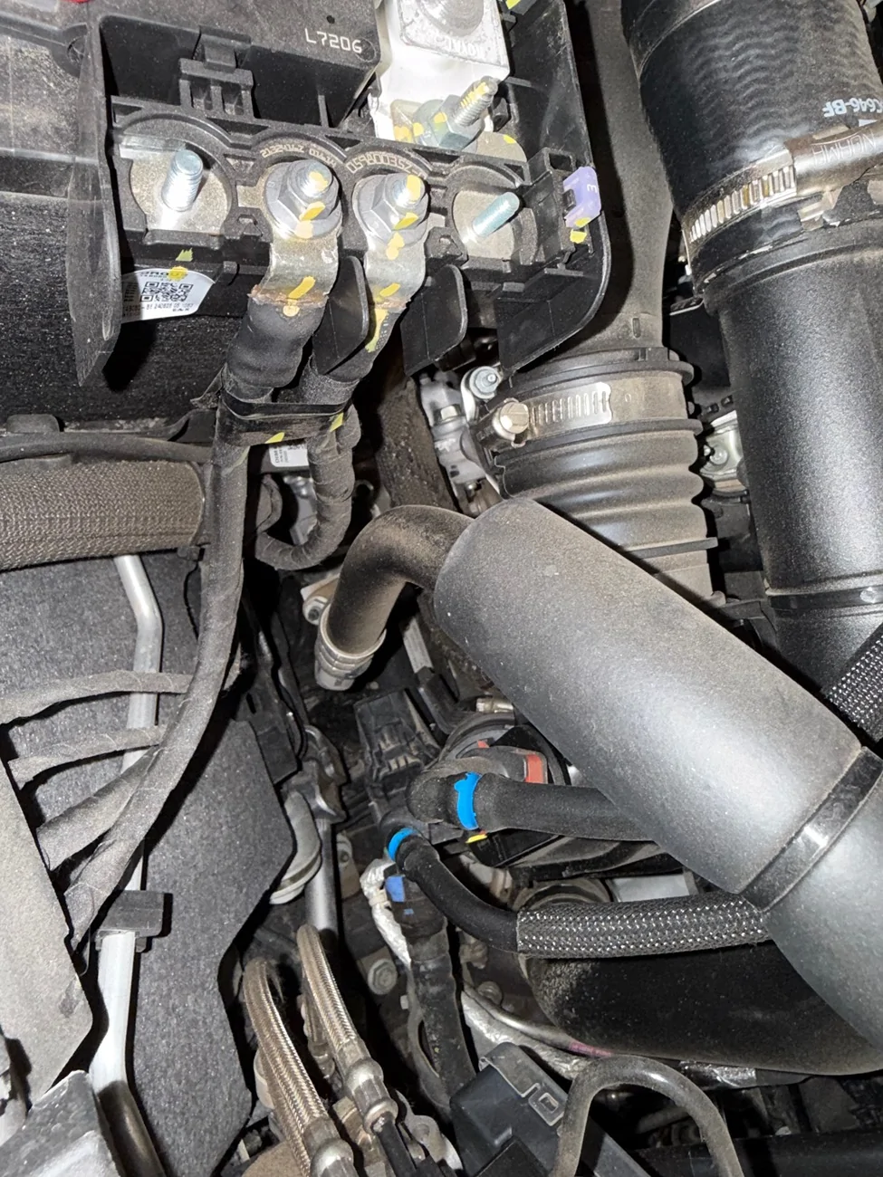

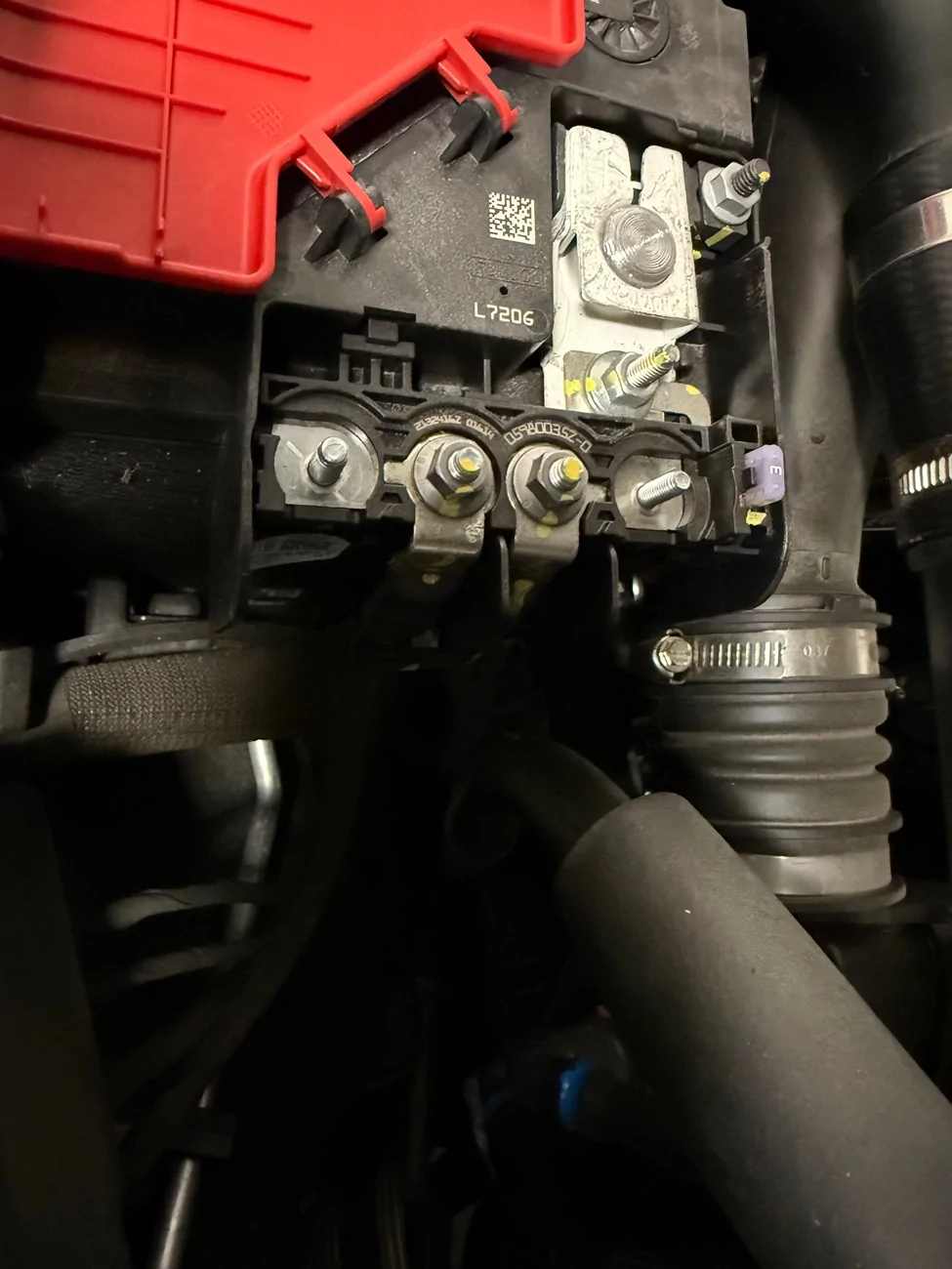

can any one post pic of the their bronco better cables
