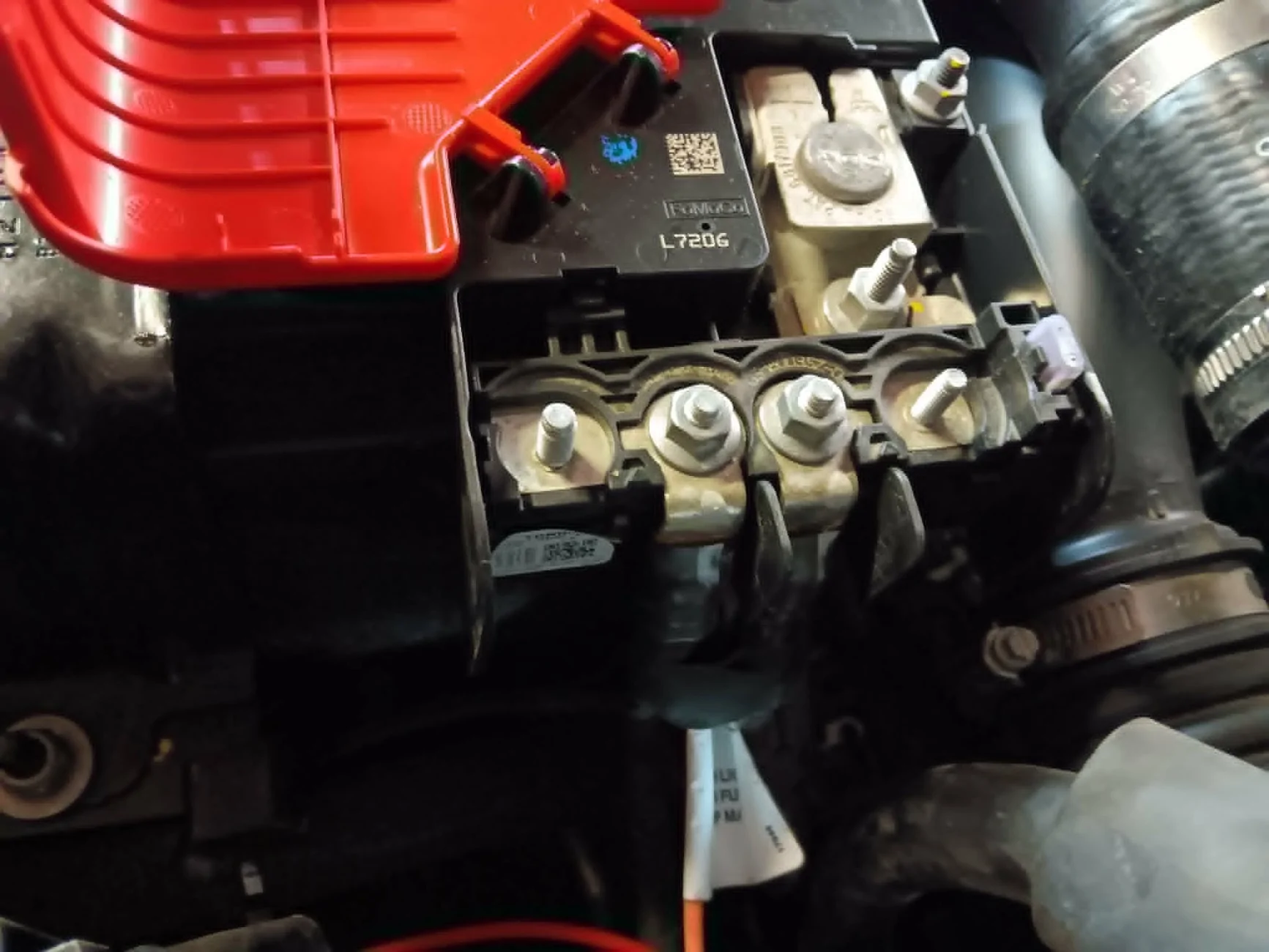

im the proud owner of a 23 outer banks and im running a trailer towing harness and was looking at the battery and the added posts for auxillary add-ons and wasnt sure if all 4 are hot since only 2 have nuts on them and i cant tell if the other 2 on the ends are hot... im not finding any good info in the online manual... can someone guide me... thank, steve

thank you... but i guess i can assume they all didnt come with nuts ?
Apparently not. Approximately 50% of Broncos are born without nuts after all.
If i recall the larger one is m6 and the smaller m5

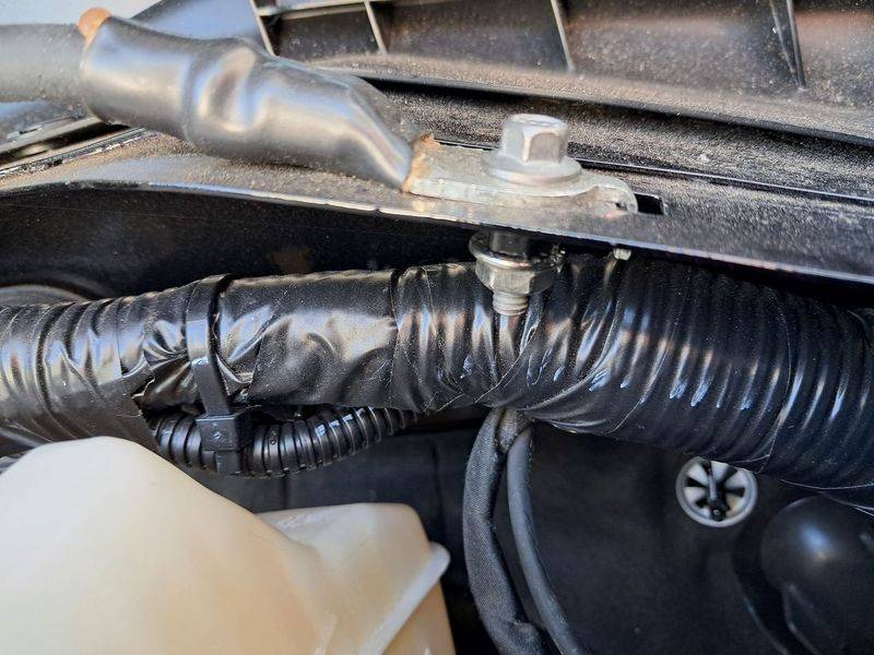

Use a 5m or 6m bolt on the factory ground bolts. Use them like a stud for your negative / chassis ground points. No modification to the factory connections whatsoever!
