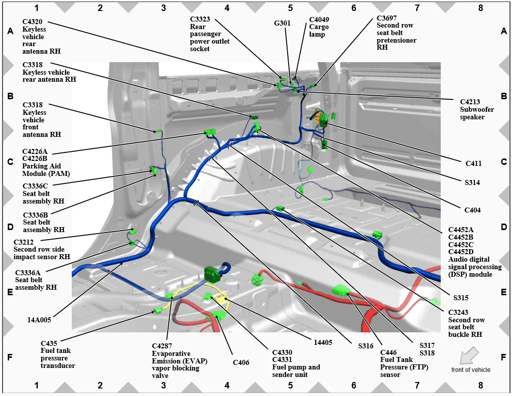

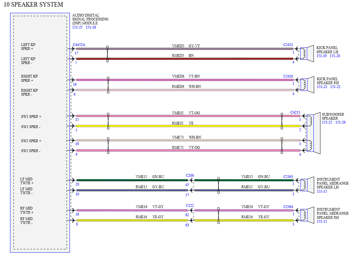

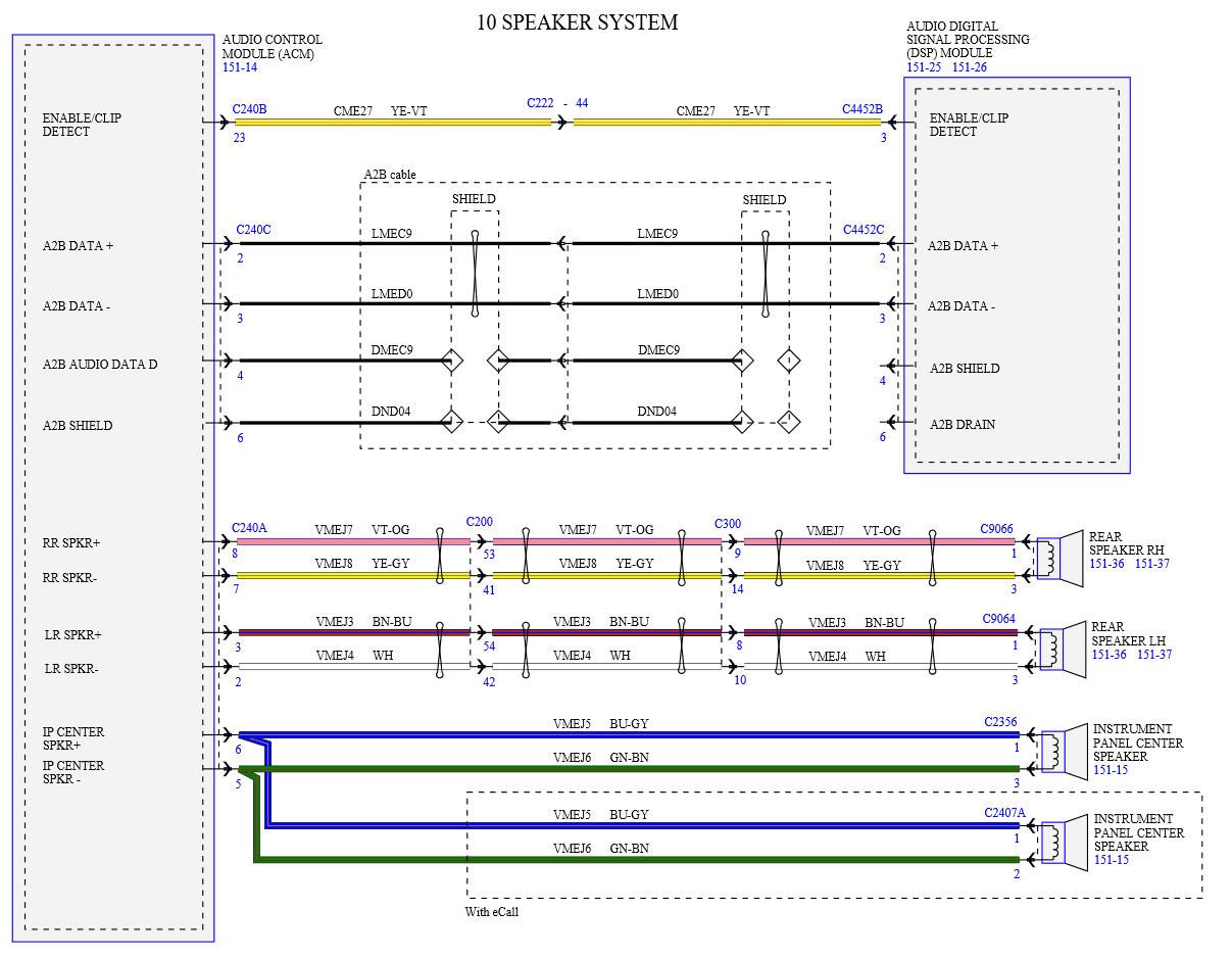

It gets a little more complicated for the 10 speaker system with the DSP in the mix. It's located back on the sub box as seen in the attached workshop manual! Also it's a little more labor intensive to get to!any chance you can find the info on the B&O system as well .... I 'm curious about the Amp, its power and placement
