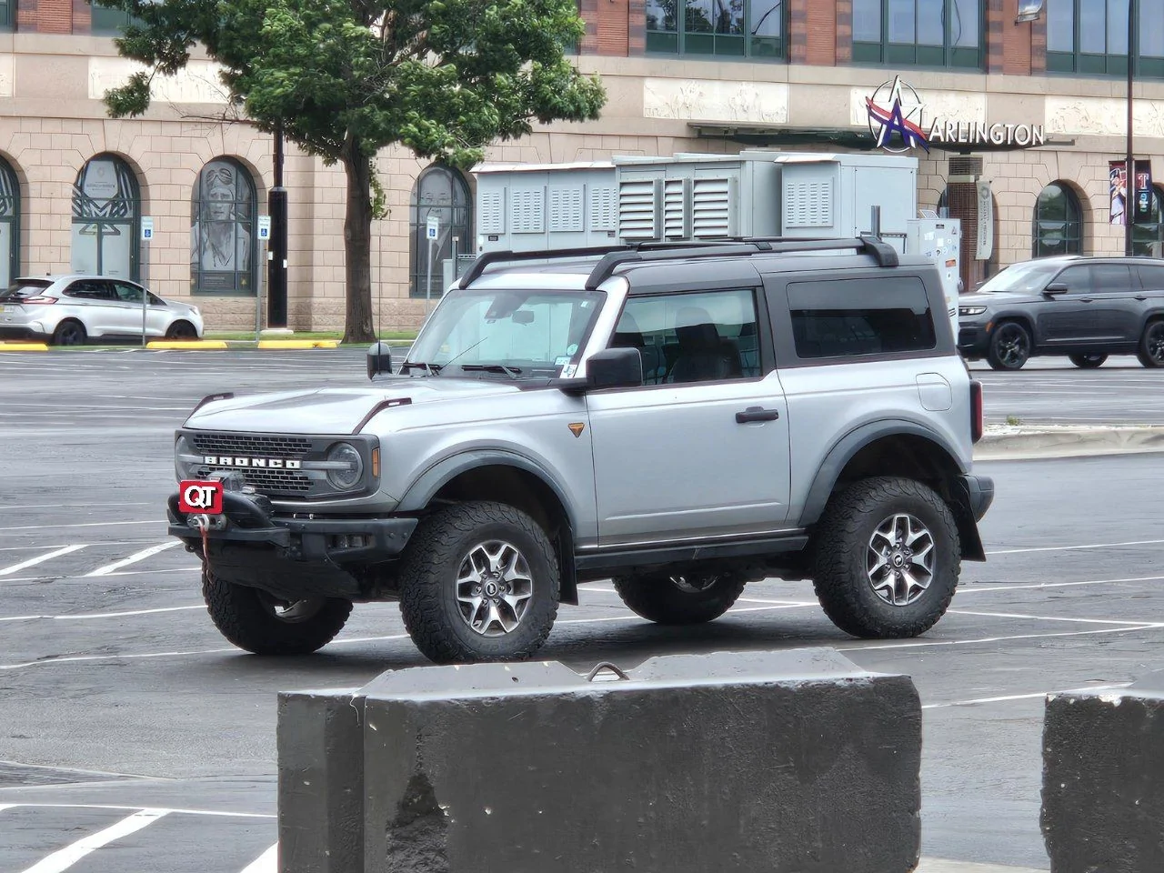

Pro-Truck 2.0 coilovers set at something approaching minimum rear lift, on a 2.3L Badlands (33" tires):
Ford Bronco Base Bronco with Eibach stage 2 coilovers IMG_20260707_193645_144
Minimum lift is still a fair bit. Tire height will affect overall height - with smaller tires you will be lower but may get some "skipped leg day" effect. Depending on your personal mobility (and height) it may leave you wanting steps.
My preload is dialed up a bit to accomodate the winch, minimum height on fronts is much lower so any amount of rake you choose is possible.
I really like the ride of the Eibachs but some forum users have been having quality issues lately.

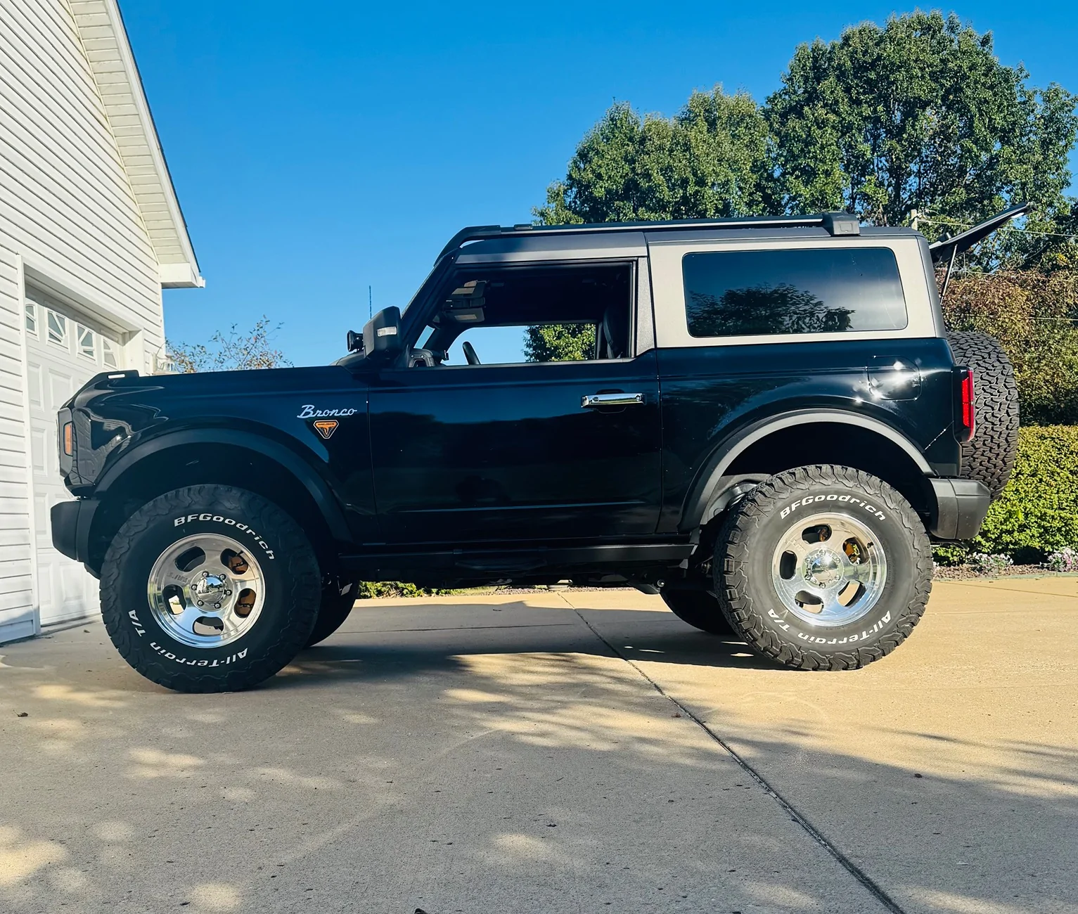

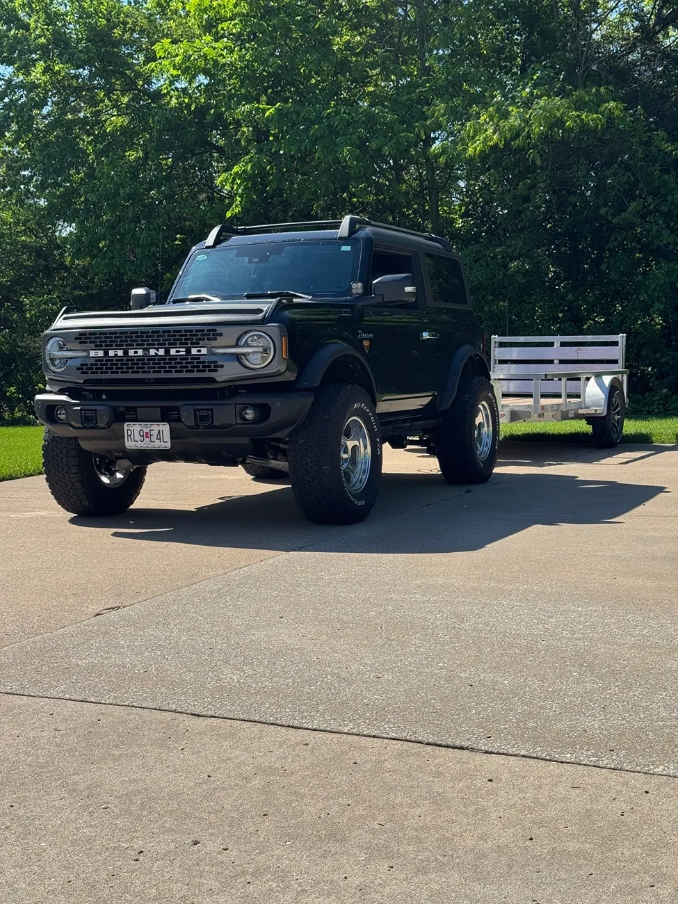

I installed it on my Badlands with the light duty rear springs and I have them set to approximately 1 inch higher than my other two door which is a Badlands with Sasquatch. The ride is great.
Looks good. Was this with the Eibach Stage 1 or 2 kit? Thanks.
2.0. Originally I was gonna have it the same height as my badlands with the sas, but it was a little rough at that height, so I ended up raising it up about an inch all the way around and it rode much softer. I like the soft ride.
