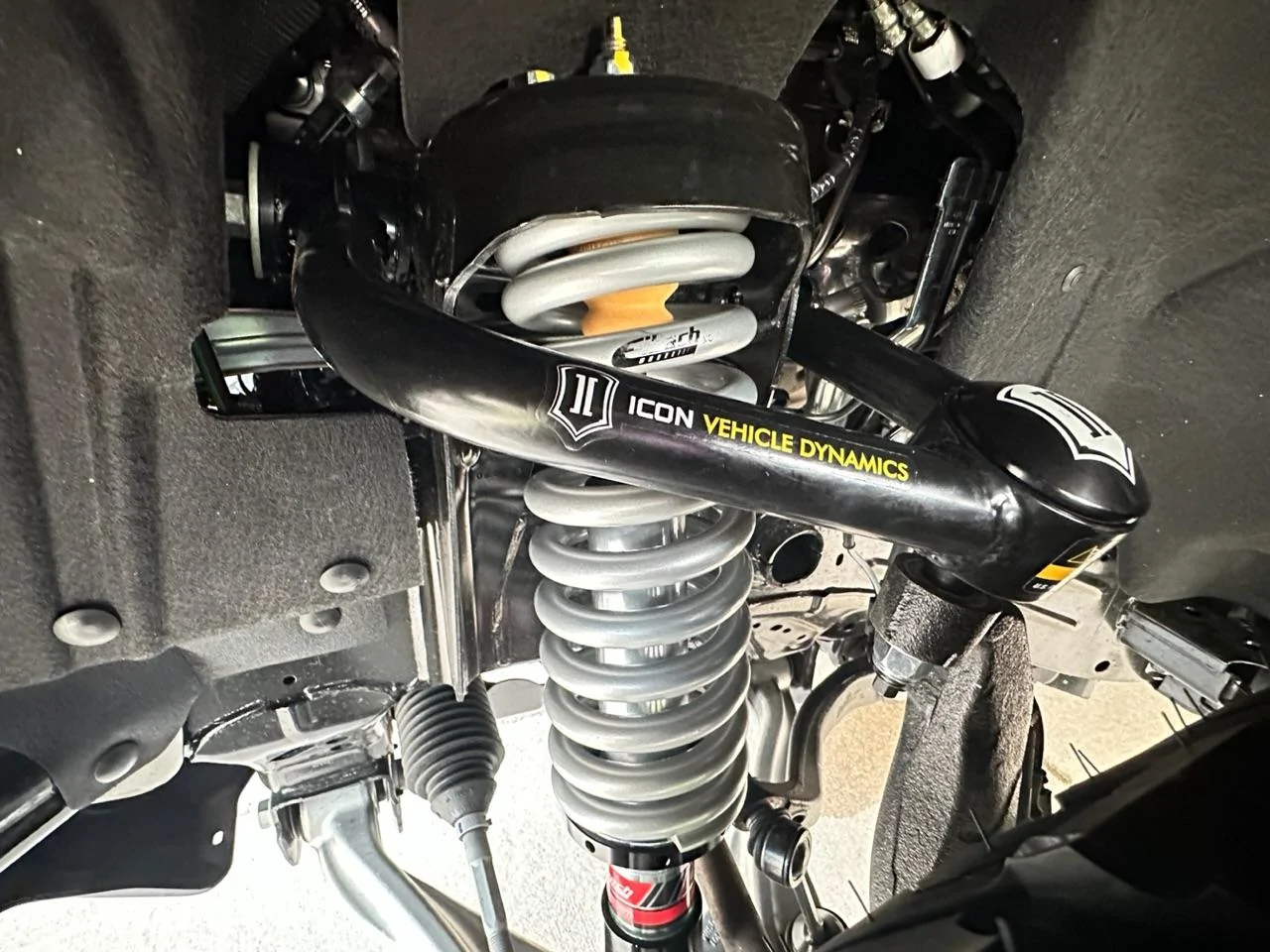

I have mine set with 2" of thread showing below the collar at each corner - I think I got more than 2" of lift and have enough adjustment for at least another inch. I'm considering dropping it some, but need to install the 37s and clearance everything before I do. I am using the heavier rated springs in the front and Icon UCAs.
