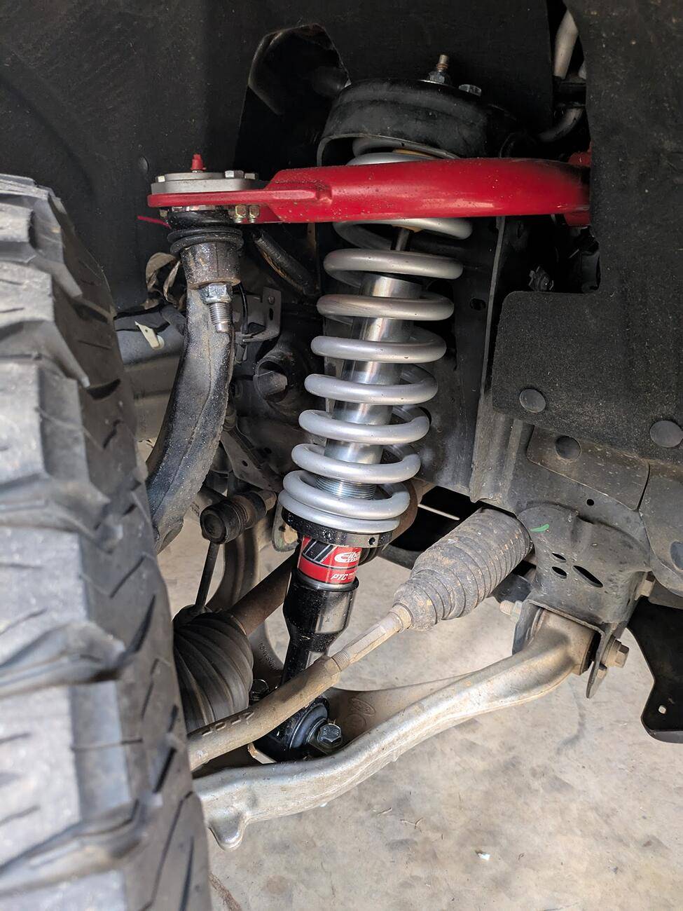

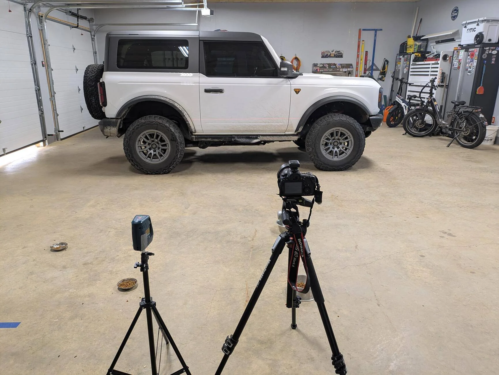

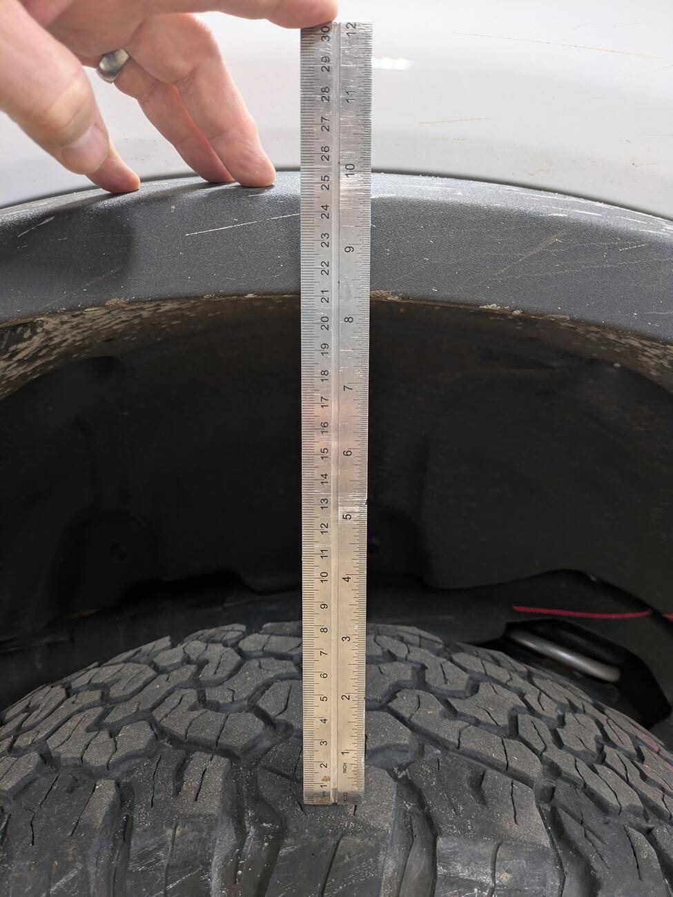

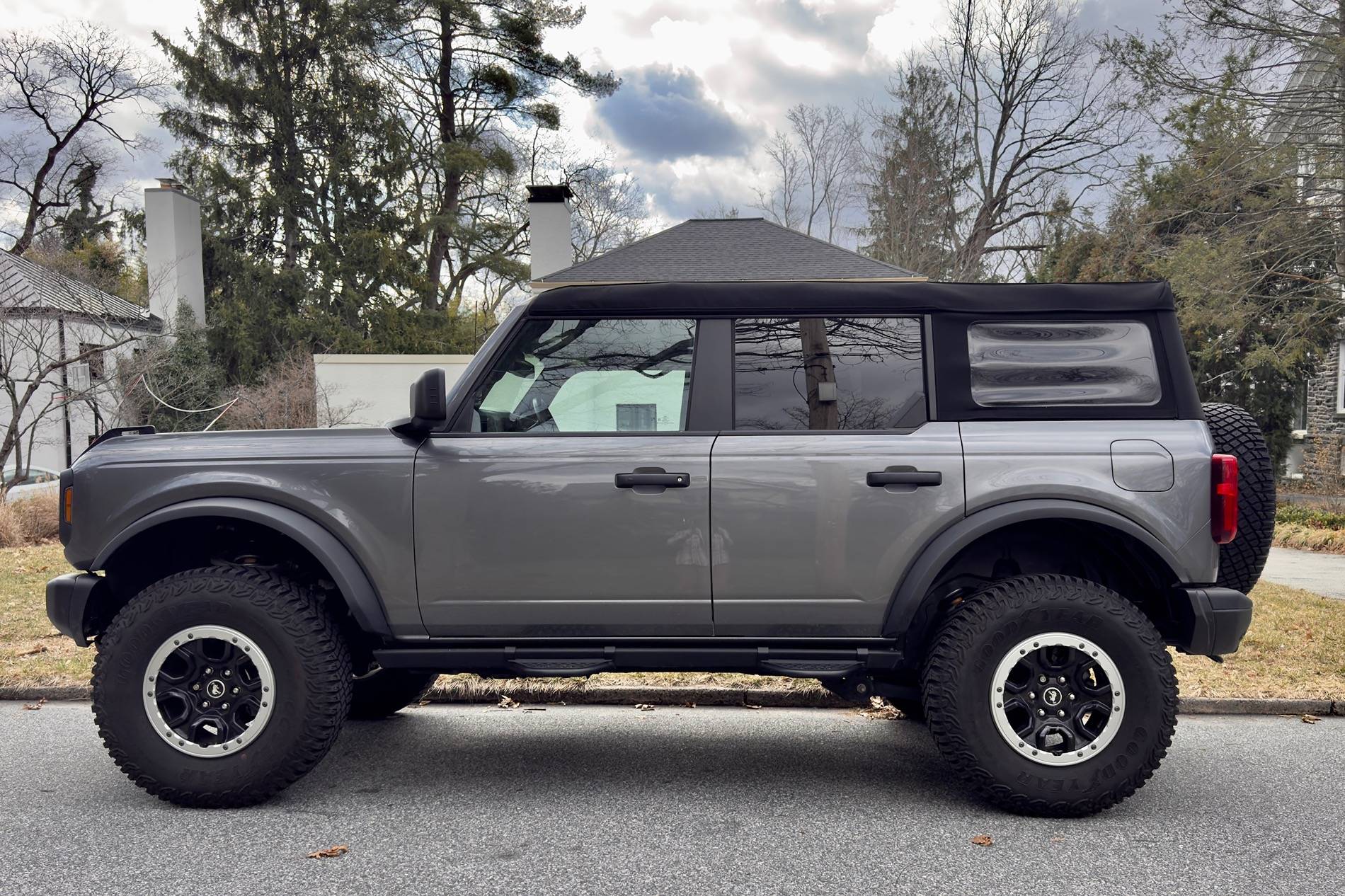

Back before Christmas I noticed the Bronco seemed to be riding a lot rougher, especially noticeable in the rear. Considering the debacle with the reservoir falling off the rear shocks, I figured it was time to just go ahead and get new shocks. Prior to this I had narrowed down my choices to Eibach and Bilstein 6112's as they are both affordable and have great reviews. When Eibach discounted the 2.0 by over $300 during black Friday I jumped. My worry with new coilovers is I didn't want to lift the thing and there are no coilovers available that are direct replacement that don't lift it a little. I was %100 pleased with the stock stance/ride height. My son came down to help me install everything. It took us all afternoon to install one. He had to leave so I decided to get someone else to install everything else. Here are the before and after pics. I used a laser level to mark the before and after. The only thing that is not stock are the wheels. Original tires with 30K miles. Tire Pressure - 36lbs The Bronco is empty. All four coilovers are set to their lowest setting.
Before
Ford Bronco Eibach Coilovers (Lowest Setting) & JBA UCA's 1741382123618-xy

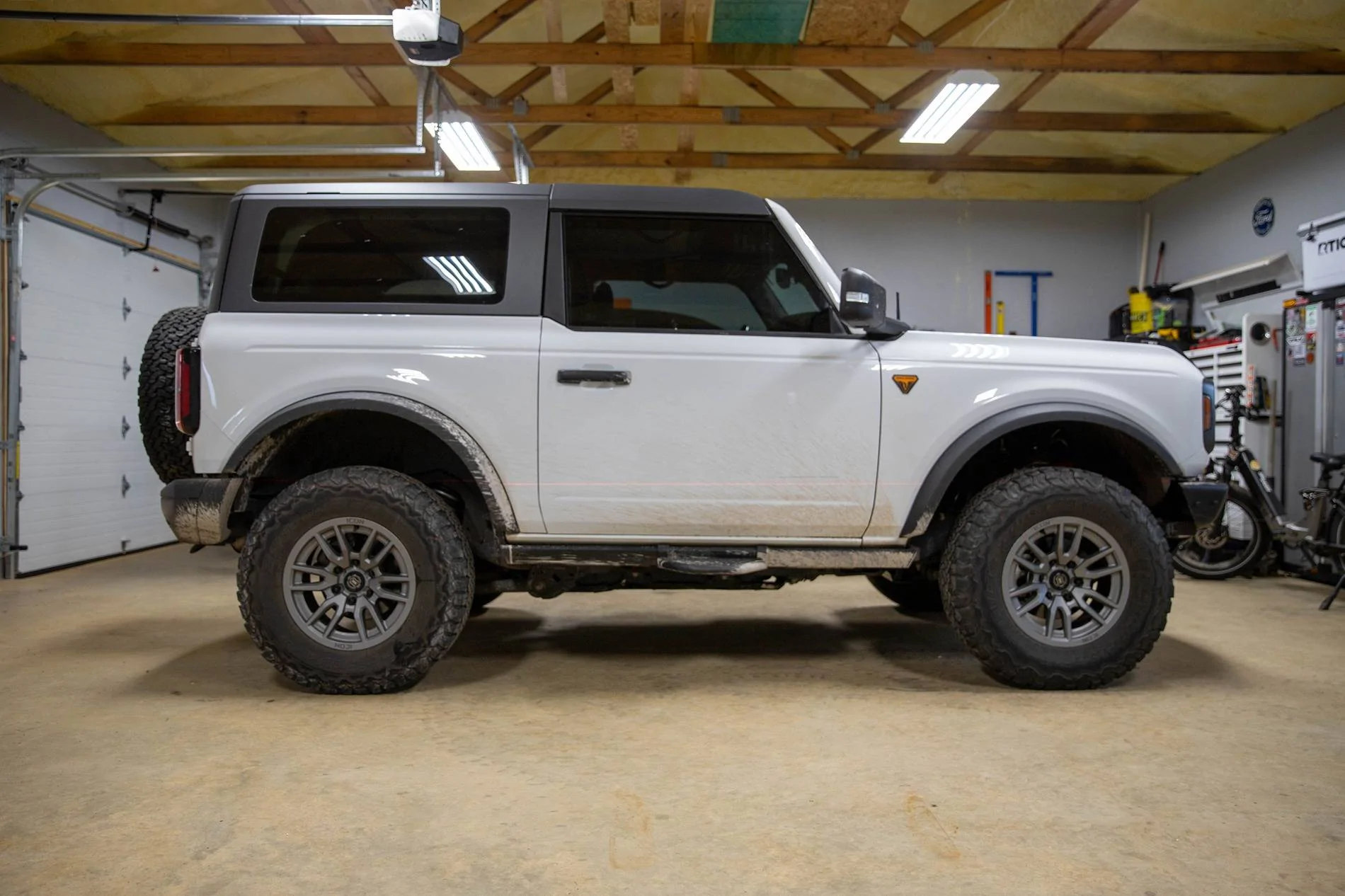

After
Ford Bronco Eibach Coilovers (Lowest Setting) & JBA UCA's 1741384020893-c1

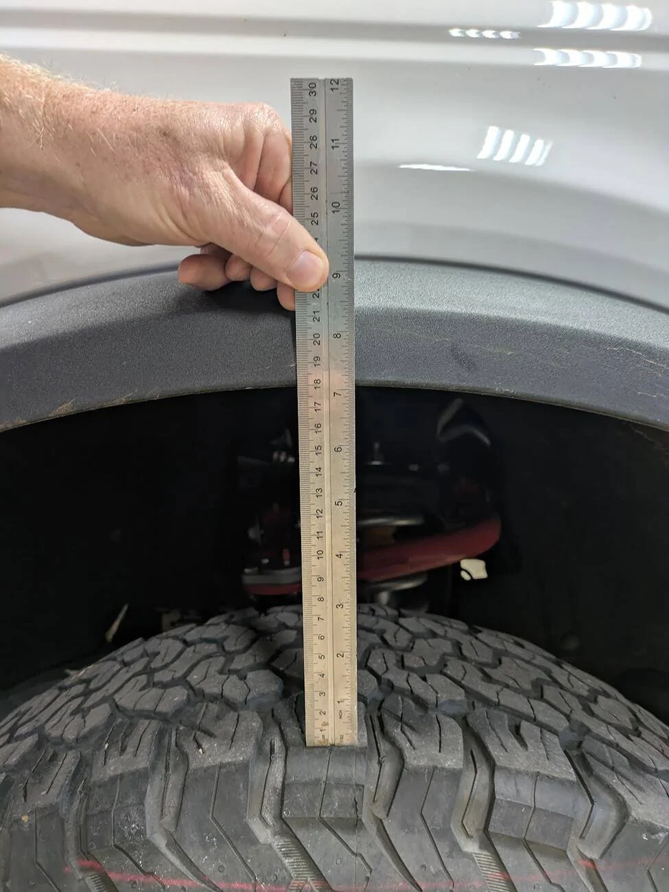

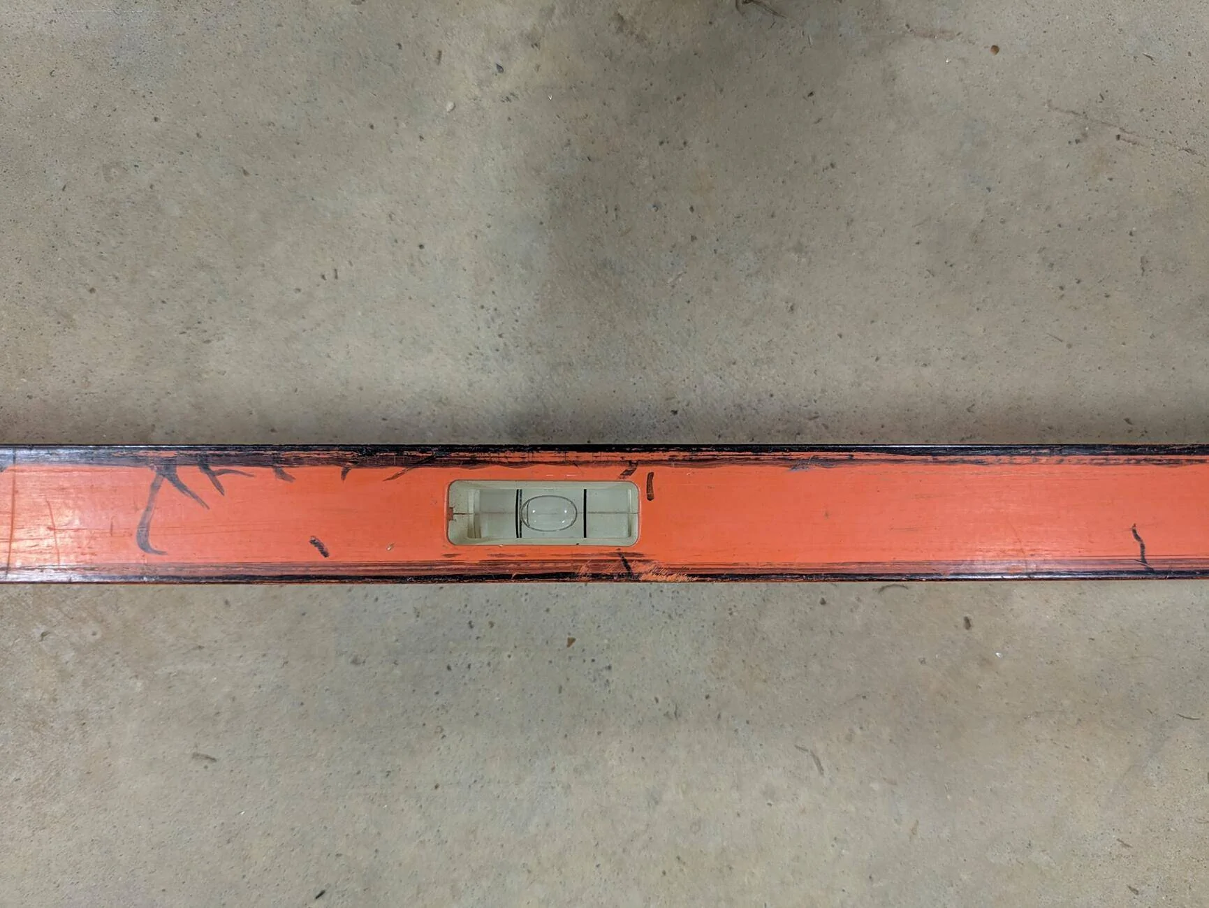

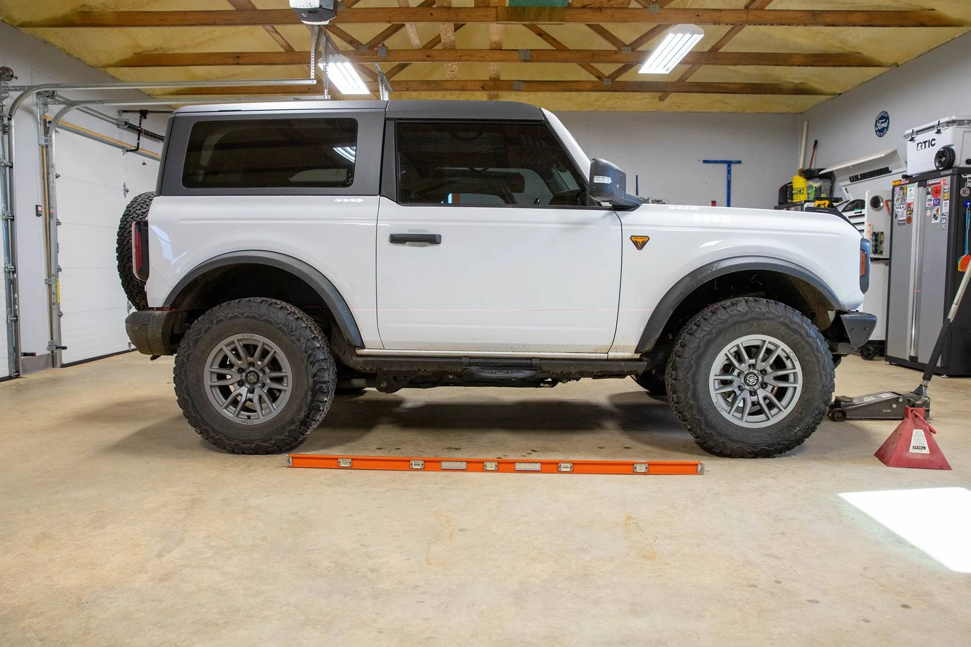

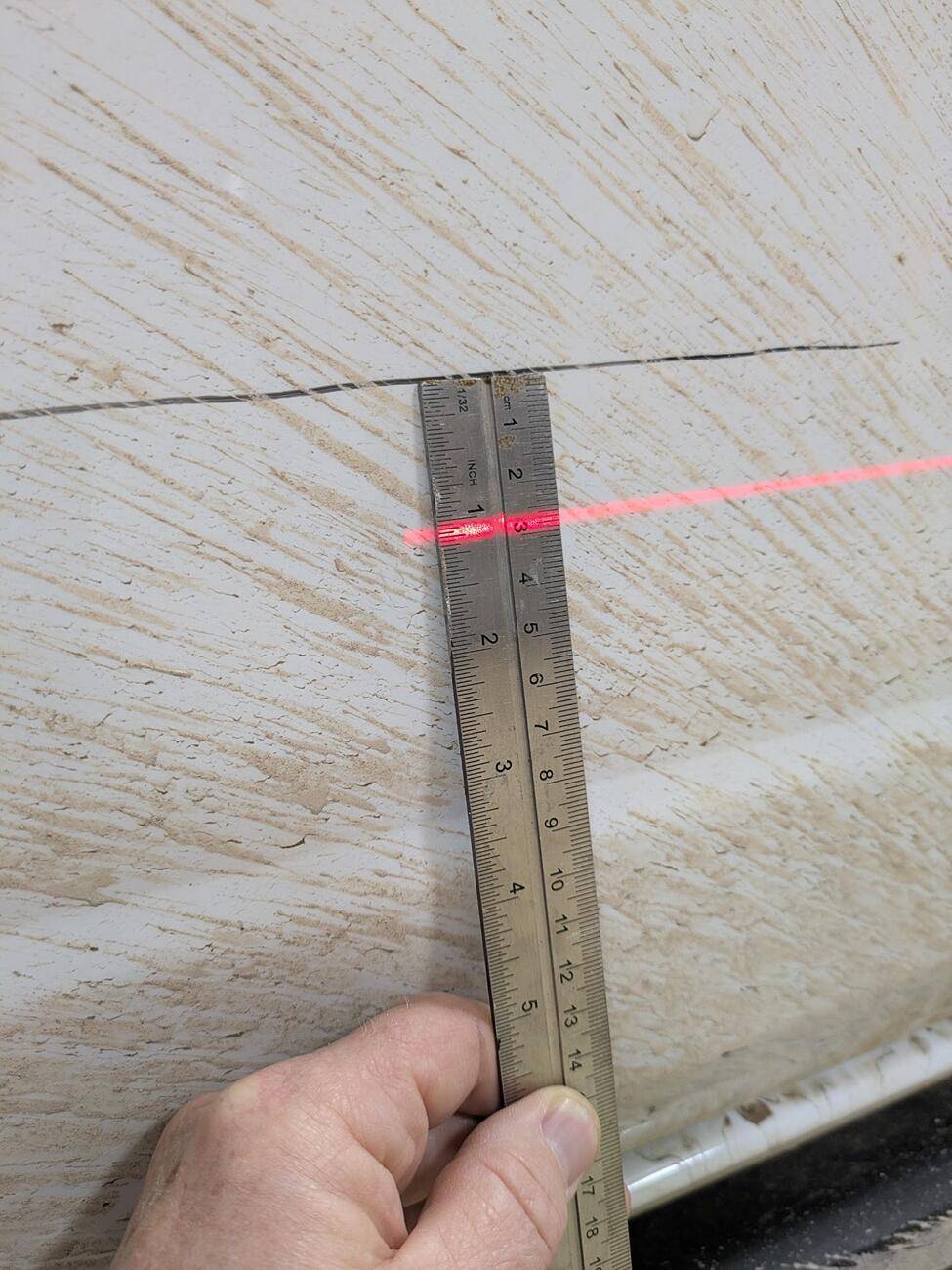

Black line before - Laser after

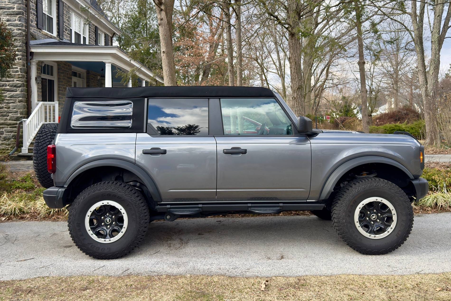

Like you, I used the warranty shock recall as a reason to upgrade to Eibach 2.0 coilovers. I got a set with HD springs from Panda Motorworks (thanks @Caleb@PandaMotorworks ). And like you, I didn't want to lift my Bronco any more than necessary. So I set the rear shocks all the way down and ended up with about a 1.25" lift in the back. I then ran the fronts up so there was about 5/8" of threads showing, giving the Bronco a slight rake (when I load it with gear, I wanted it to be almost level) and an overall lift of about 1.25".
@WheresMyBronco: I think the ride (on road) is much nicer than stock. As @RoLyMa27 says, not as firm and perhaps a bit less responsive, but my driving style doesn't notice it at all. I am looking forward to using them off road (trails and dirt roads) next month. I don't do any rock crawling or very hard trails — more exploring and camping — so I suspect I'm going to be really happy.
Shoutout to Bill, who owns Hardline 4x4, a local guy who did the install (along with new tie rods and trackbar). Great work. Fair price. Quick turn around. Overall nice guy. If you are in the western Philly suburbs and looking for a shop, I really recommend Bill’s (he typically does a lot of Jeep and 4Runner work, but wants to do more Bronco work). Check him out: https://www.hardlinefab.com/
Here are a couple after pics (I don't have any before pics):
