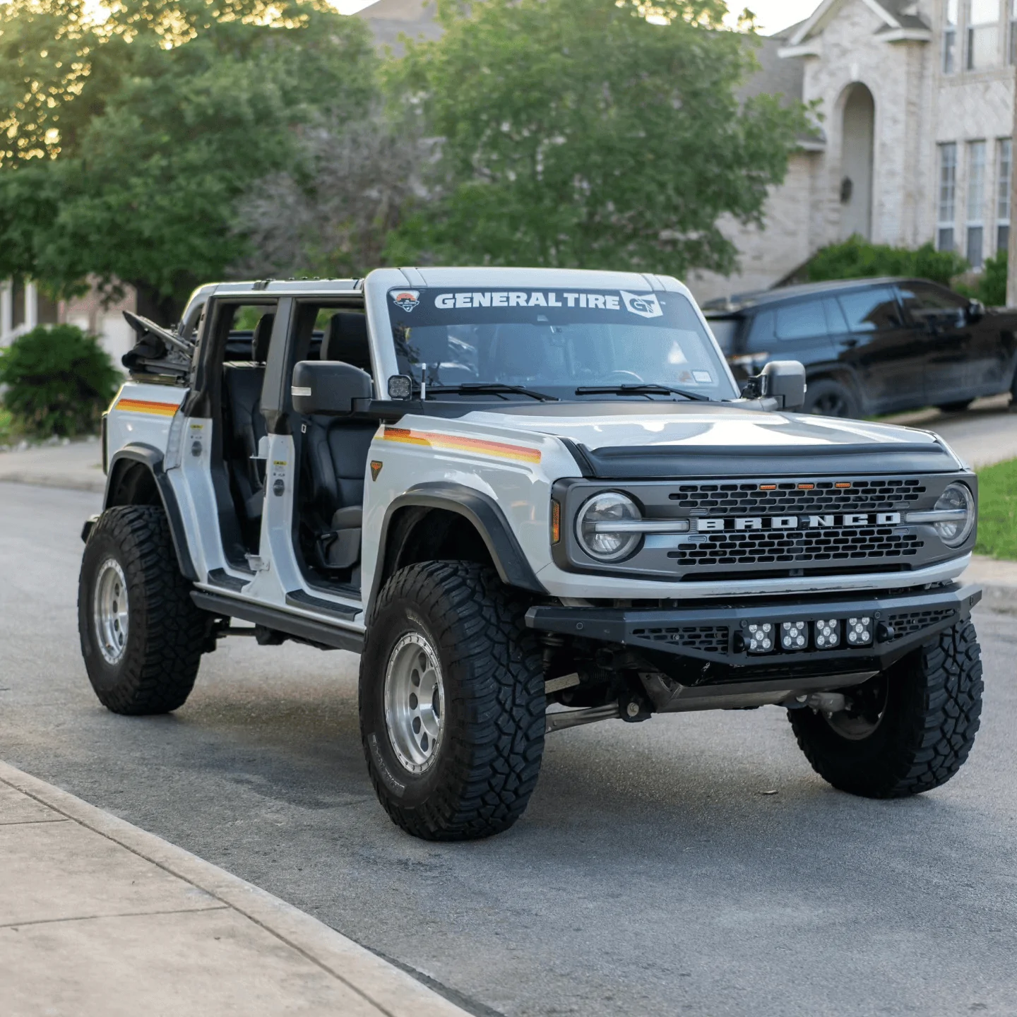

Been using them with Zone UCAs since last November and they've been great! Zero issues and I've done some crazy stuff lol
Ford Bronco Sasquatch Eibach Coilovers with UCA? 1688739647169
Ford Bronco Sasquatch Eibach Coilovers with UCA? 1688739718391

Yours looks like it’s got a good lift on it there. Especially when airborne!!
do you have the heavier weight springs or normal? Do you have the height maxed out? Is it quite firm on the road?

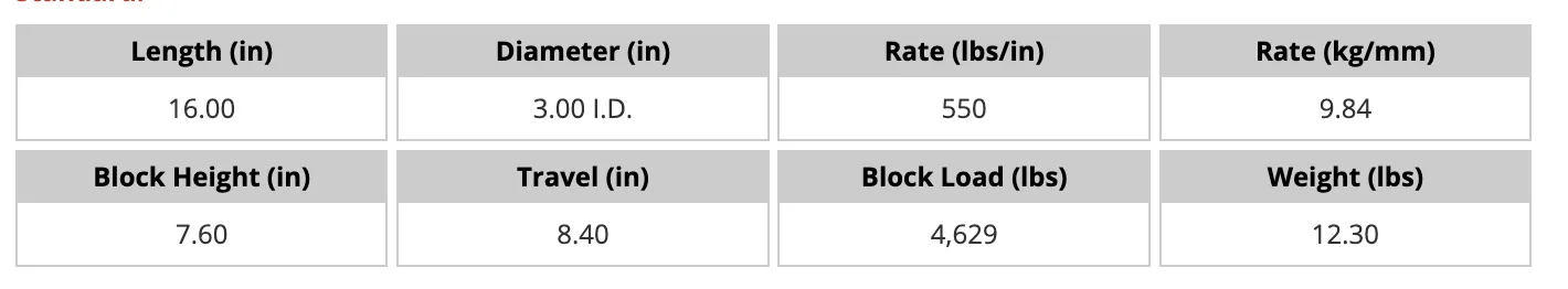

Specs of upgraded front springs :)
Ford Bronco Sasquatch Eibach Coilovers with UCA? Screen Shot 2023-07-07 at 3.54.26 PM

Great thanks for the input guys. Eibach said they’ll give me a discount with exchanging them so I’ll go with the 550’s.

Gonna go out a limb here
From personal experience and from many threads here
Eibach 2.0 coilovers are perfect for the 2 dr
But for the 4 dr, need the 550 springs up front
Just my experience
I'm happy with mine
