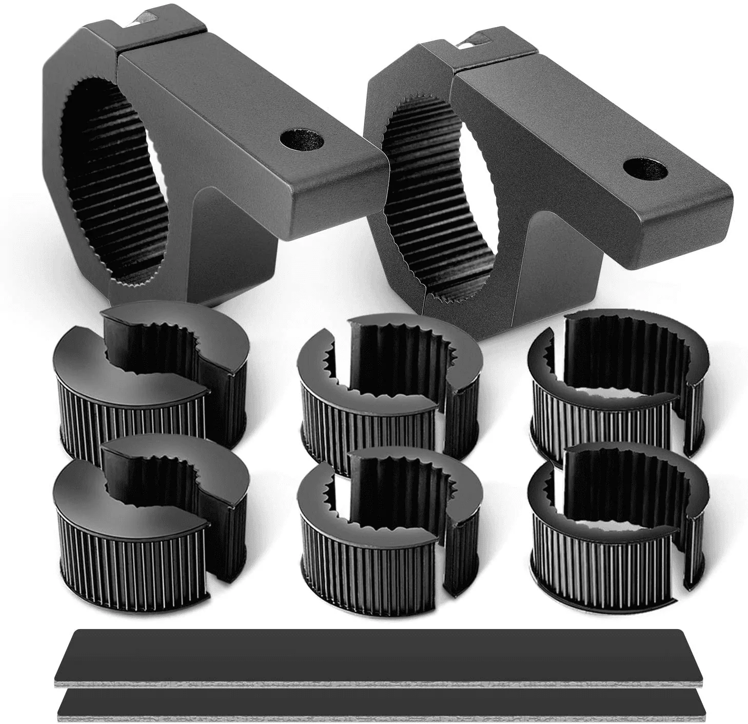

We have a few LP9 Racer in stock and a bunch of LP9 Sport in stock for those interested.
The way you'll want to mount them to your hoops is with something like this:
https://www.amazon.com/Nilight-9002...1_2?keywords=tube+mount&qid=1639840275&sr=8-2
Ford Bronco Baja LP9's on a HD modular bumper? 1639840286298
There are other kits on amazon like this. But they go around the tube and then give you a mounting point for your light.

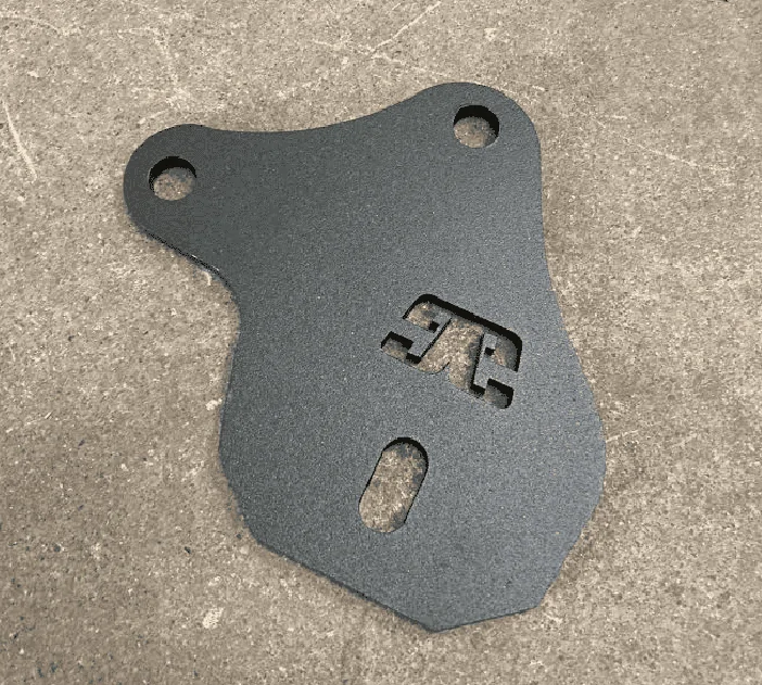

I have a pair of LP6s ready when my Wildtrak arrives. If you don't want to drill your mod bumper than you can use this bracket >> https://gglights.com/products/2021-...52030&pr_ref_pid=6914069954718&pr_seq=uniform.
The single mount (see below). The 2 smaller holes are for the factory bronco bolts. The pill like hole is for your light. I will drill this mount for 2 holes on either side to accommodate the LP mount

that would be good but like I (the OP) and Broncorich above have a bull bar and push bar and have take up those spots. Therefore, drilling is only option if we want sitting ON the bumper.

You are correct. It would not work with the bull bar
