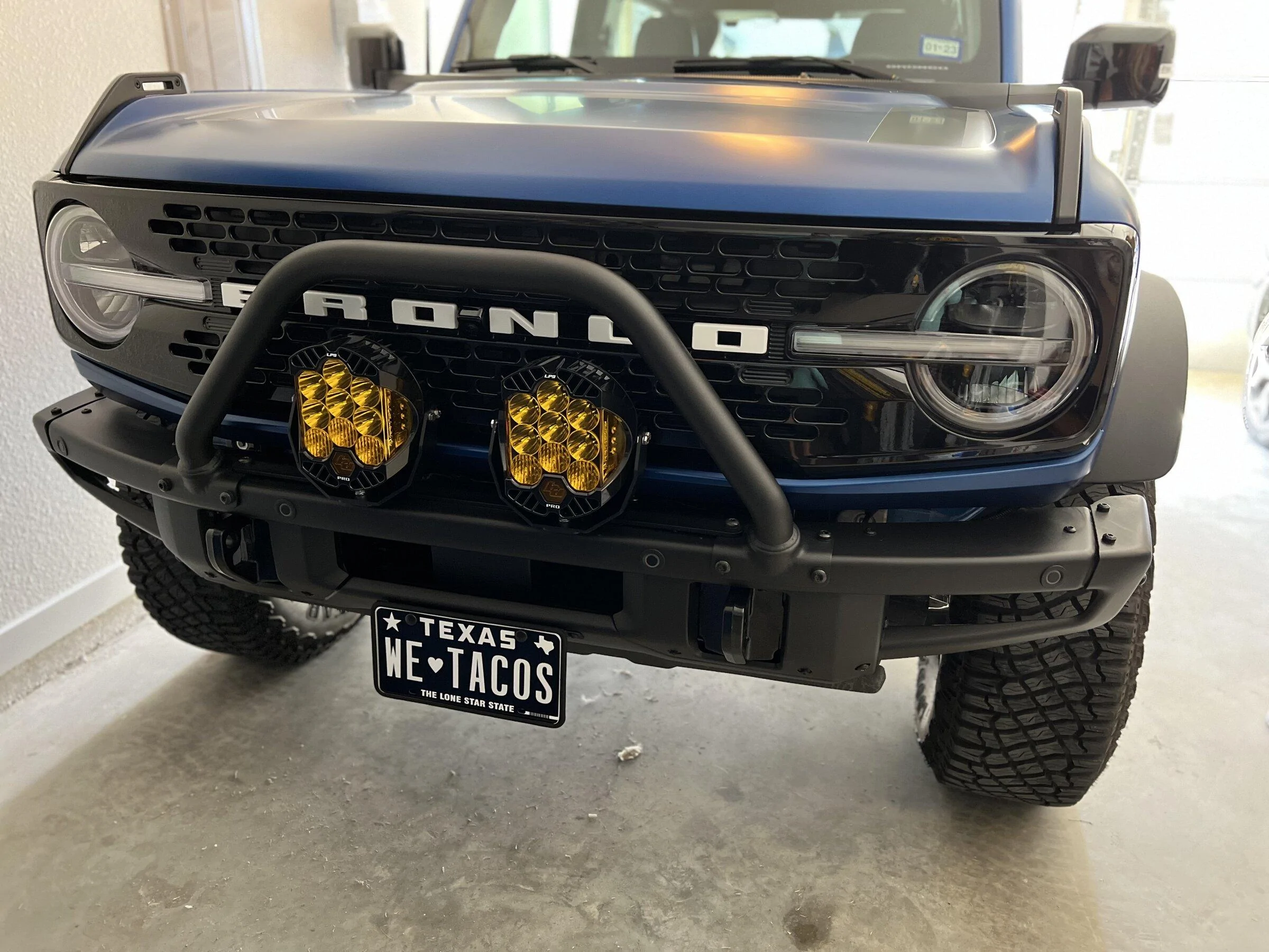

No instructions makes for an interesting install 🤣😂. Actually the fabricator at Rudy’s gave me a few good tips which helped.
INSTALL TIPS (if using Rudy’s mount):
The mod bumper is nice to work with and fairly easy to remove. Pull out four plastic anchors around the tow hooks and remove the two large bolts on each side next to each other. The third bold just keep loosening until the bumper drops down a little so you can access the two rear mount spots. You may need to pull the bumper forward a little to get it to drop the front.
Next I would run the wiring harness through the bay to the front to connect to the lights. It’s a tight fit and also note there are louvers under the bumper and just over the top behind the grill you need to stay away from so they can operate how they are intended. Get those wires through and when you button it all back up together, connect to the lights before mounting the lights to the bumper.
The wiring harness is long which is great, but it also leaves a ton of wiring to zip tie up and keep out of the way.
The pic isn’t the greatest but it’s what you are getting for now.
I was considering other lighting but WOW are these bright. On low, super bright. On high, surface of the sun ☀ They are amazing. The backlight looks great as well. For now I wired all to the upfitters but I may change that later.

Haha, thanks. Can’t believe the plate was available but most people think of themselves (I ❤ Tacos) instead of thinking of all etc.
You can see enough through the front camera but the sides are slightly blocked. No biggie for me. Here is a crap pic in the garage. Don’t mind the mess.

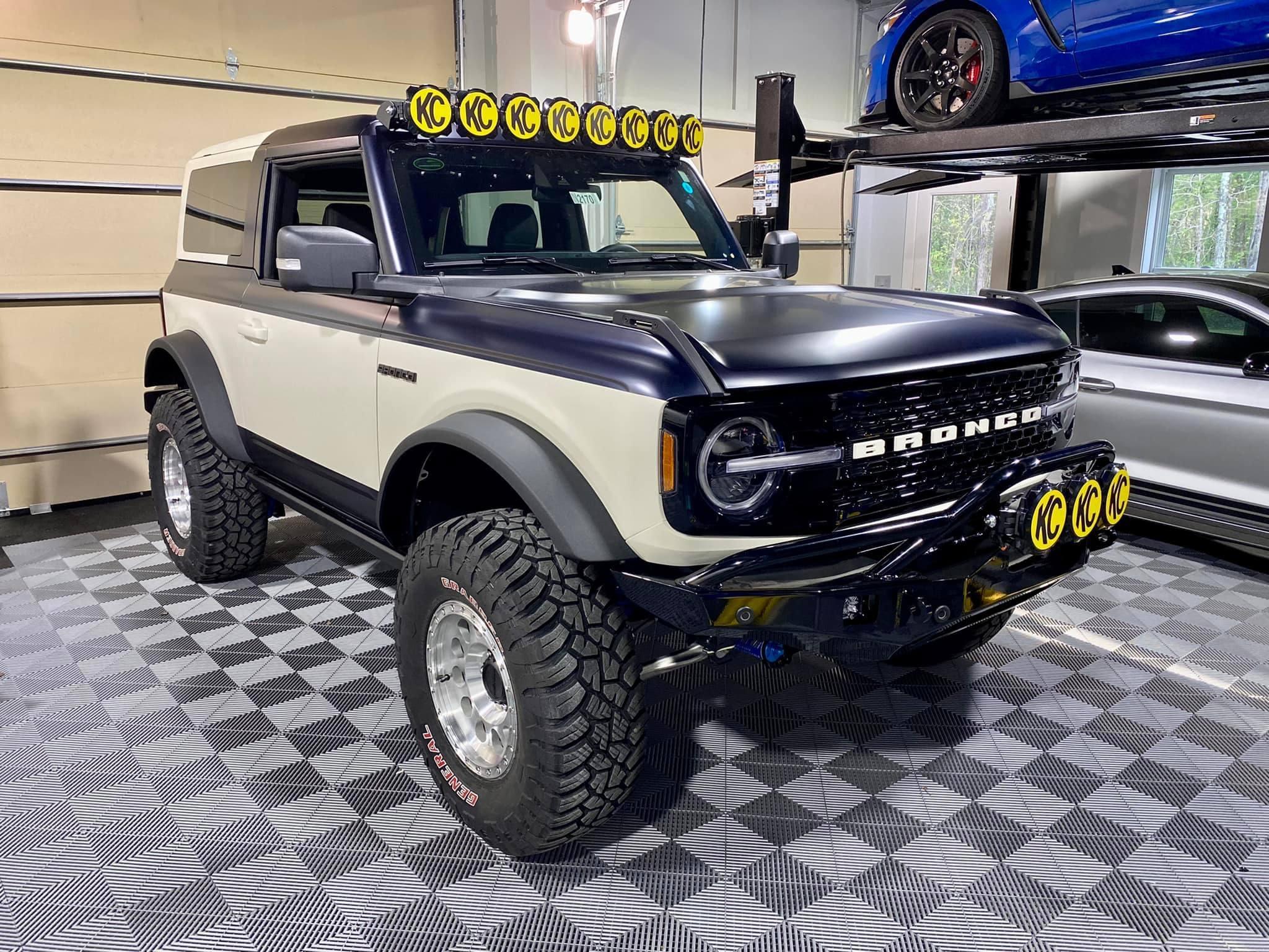

I’m absolute in love with this look - JCR Vanguard bumper with KC lights, Baja style.
def on of the first things I’m doing to mine.
(Not my ride - but saved for inspiration)

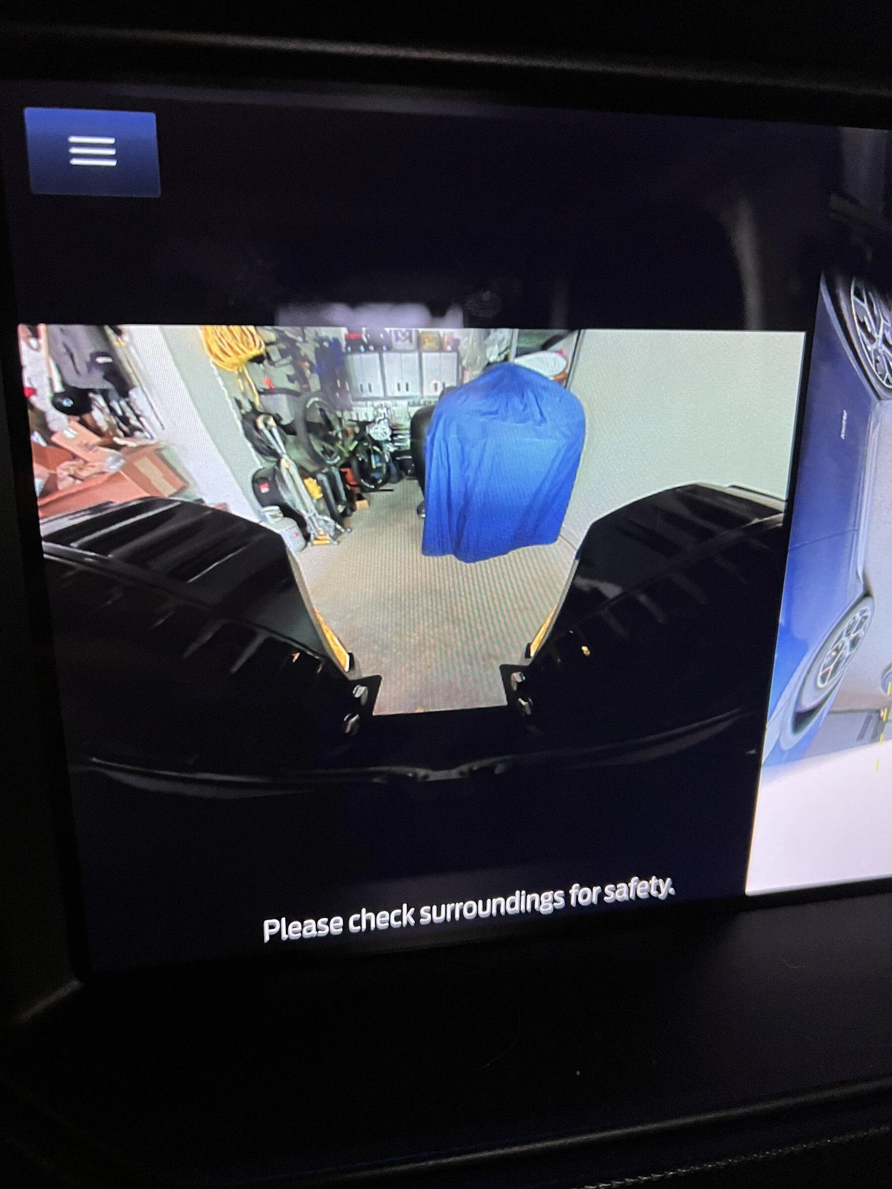

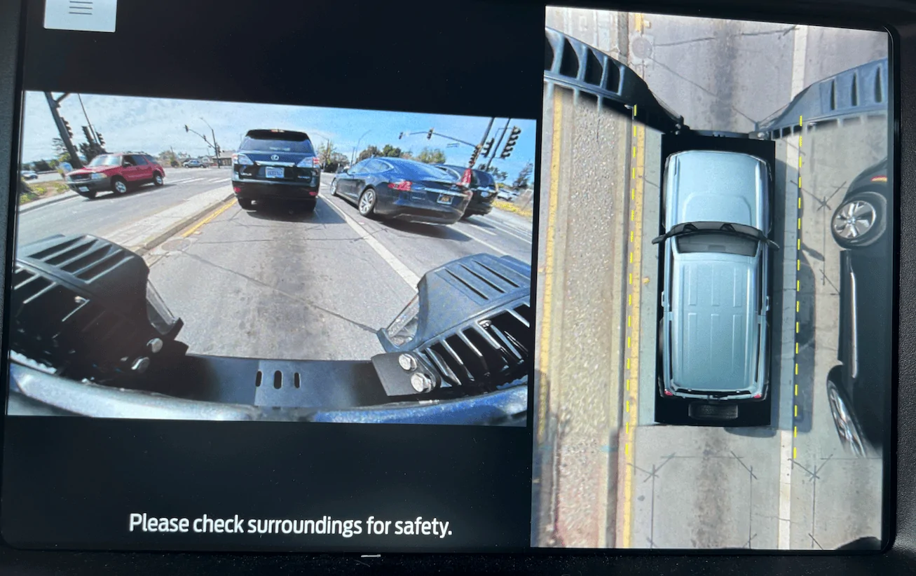

My 360 camera facing forward is slightly compromised by both lights on the side. It’s not a big deal to me
Can you post a pic of how much it blocks the 360/front views?
