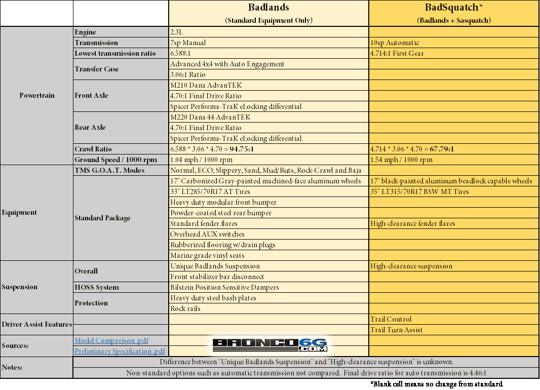

Refer to post 1 AND ITS SOURCES. Even I made a mistake here.
The 4.70:1 Ring and pinion is STANDARD for both the 2.3L, and Sasquatch, but NOT with the Automatic.
I will update Post #1 to reflect this more accurately.

Don’t confuse yourselves people. Refer to post 1.
The 4.70:1 Ring and pinion is STANDARD for both the 2.3L, 2.7L, and Sasquatch variants on Badlands.
The only gearing that changes is that of the 10sp transmission’s 1st gear - giving you a different crawl ratio. Again the auto is not the standard option.
The final 4.70 drive ratio remains constant throughout in any Badlands variant.

That is false. Badlands with an auto is 4.46. With a manual or Sasquatch, it goes up to 4.7. Post 1 doesn't show data for a Badlands with an auto and no sasquatch, just the manual.
Ford Bronco Badlands vs. BadSquatch (Badlands + Sasquatch) Comparison Chart 9662C093-FB78-407D-A75D-B9D3C51ACA5F
https://media.ford.com/content/dam/fordmedia/North America/US/product/2021/bronco/pdf/2021-Bronco-2dr-4dr-Prelim-Tech-Specs.pdf

Sorry Fordboi - I let you down...
Gamecock & Fordboi - I recommend you remove my quote of the old incorrect information so we don't accidentally confuse more people.

I have updated the comparison chart in post #1 to show ground speed / 1000 rpm in the crawler gears. Also added a note clarifying the final drive ratio with the optional 10sp auto tranny. True differences between stock Badlands suspension and Sasquatch suspension are unknown.
Ford Bronco Badlands vs. BadSquatch (Badlands + Sasquatch) Comparison Chart Badlands vs. BadSquatch
