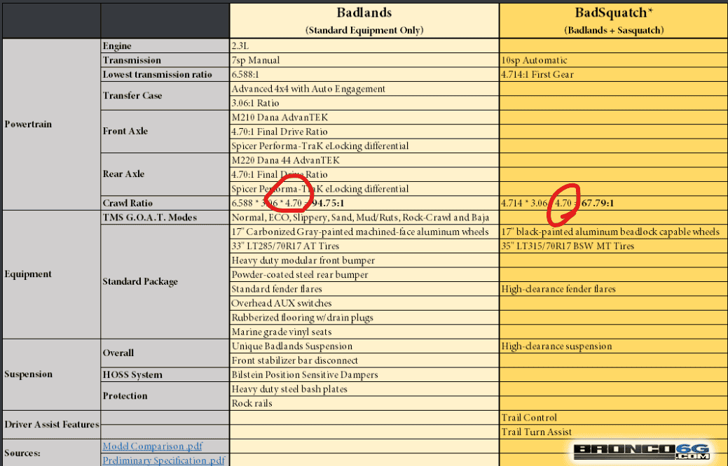

I hope I can help bring some clarity and simplicity to a common question.
It bugs me when I see the same old "what does Sasquatch get me that Badlands doesn't already have" question followed by lazy, partial, or just plain wrong answers. Here is the answer as simple as I can make it.
Sources (please inform me if I have made an error and I will fix):
  1. Ford Model Comparison .pdf
  2. Ford Preliminary Specifications .pdf
Hopefully this helps facilitate a very specific discussion for those of us that are reserving the Badlands model with the knowledge that we will have to choose between manual and Sasquatch (I hope this changes and becomes a non-issue!).
My take on the subject overall is that Badlands gets you one hell of an off road deal without spending another dime. It is actually SO GOOD that I am seriously getting comfortable with the idea that I really don't need to add Sasquatch onto my Badlands - if I decide the manual is my preferred transmission. If the automatic is my preferred transmission - then no brainer, BadSquatch it is. I would be fine rollin' on 33s til they wear out and evaluate going to 35's at that time.
Remaining questions that I have not seen a good answer for:
  • What is the difference between "Unique Badlands Suspension" and Sasquatch "High Clearance Suspension"?
I'm not sure what's going on with the moderators lately but a similar thread just got combined with another thread that was already 24+ pages long, which makes it hard to focus on a simple topic like this. It'd be great if we can just keep this one short and sweet without contaminating it with a bunch of repeat questions. So please don't delete this / move it if at all possible - and if you have questions or comments, make them educated ones!
Oh by the way, here's my "real" off road rig so I'm not just blowin' smoke:
Ford Bronco Badlands vs. BadSquatch (Badlands + Sasquatch) Comparison Chart VnD
so for most of us the only advantage to the sasquatch is 35s M/T and high clearance suspension. new 35 a/t and a lift is probably cheaper than the sasquatch package

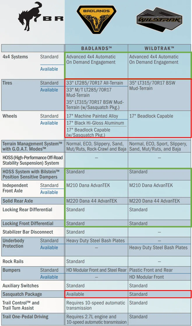

Meaning what? Ford says the Sasquatch is available with sway bar disconnect and without.
have not seen this info.......only on Badlands and FE models do I see disconnect. see chart below

So you’re saying that only the Badlands Sasquatch package is limited? Or you’re saying they limited all Sas package vehicles because one trim level has the disconnect?
I don’t think it has anything to do with the disconnect
question one yes.
not limited on all squatch because the disconnect only on the Badlands and FE.
to answer your last question it is obvious you are not aware of what a disconnect does....
see pic.
being able to disconnect bar allows more wheel travel. If no disconnect wheel only travels so far down because the sway bar end link will limit its travel. It is very hard to explain it typing, a quick google search will do wonders for a better explanation. Google is you friend guys if you don't understand
watch the reveal video when they explain the disconnect it shows the Bronco's suspension dropping when it is disconnected.
