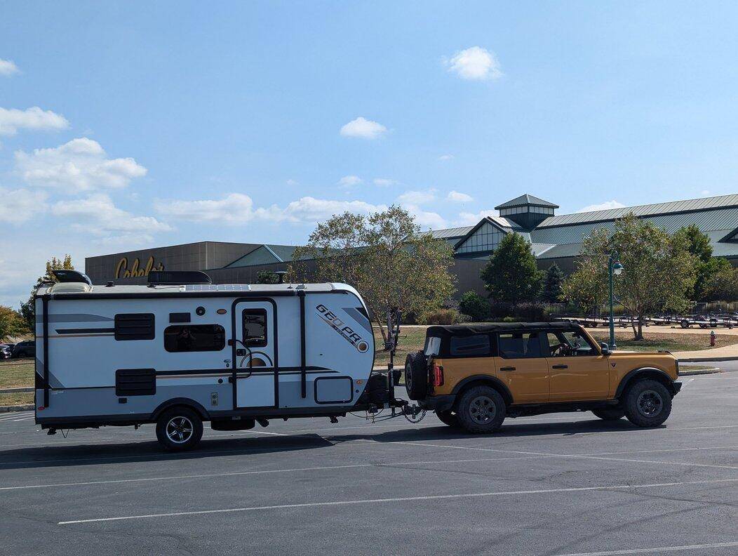

I went with the blue springs and they're just right. The kit comes with spacers to work with different amounts a lift, so you can determine when you want the helper spring to engage. I initially installed with both spacers and found the ride to be a bit harsh when driving empty. In the pic above I'm running without any spacers on my non-SAS Badlands and it's just right.
When the times comes for lift struts and 35s I'll add the spacers back so the sumo springs engage at the same relative point in the suspension travel.
Nice rig! What mode GeoPro is that? Thanks!
mjp2
Feb 27, 2023
497
1,586
NJ
2021 Cyber Yellorange Bronco Badlands
Thanks! It's an early 2020 G19BH that we bought used in 2024. If I didn't know the year I'd have sworn it was brand new as everything was spotless. Drove 6 states away to pick it up as the price made it worth the travel time and expense. 🙂
It's been perfect for our family (wife and 2 young boys) and we have some big trips with it planned for this year. Compact enough to fit just about anywhere but still has all the amenities.
The 4-cylinder 7MT Bronco pulls it without a problem, though you do notice it's back there as the fuel gauge drops. Towed it through the Pocono Mountains in PA loaded down, including a full tank of fresh water and gear for a full weekend, and the truck never complained.
That's great news... and you just made my day. I have a similar camper (cruiser hitch 18bh) with a similar dry weight. I was second guessing using the bronco to tow, but your post made the nerves go away.... especially since most of my towing is flat. Now to buy some Sumo blues. Enjoy your trips!
Nice! I also recommend getting the factory brake controller. There are some threads on this forum that show the easiest way to install it, with the gain dial mounted near the headlight knob. Installation took maybe 30 minutes since I already had the factory tow package.

One last question... thanks... What weight distribution hitch are you using? I'm debating just using the weight distribution hitch OR the blue sumos rather than both. Any insight or opinions are very welcome.
mjp2
Feb 27, 2023
497
1,586
NJ
I'm running the Blue Ox SwayPro WHD with the blue sumo springs. The combination seems to work well on the Bronco. Our suspensions are designed to be supple and articulate off road so they need a bit more help when carrying loads at speed on road.
Towing the same trailer with my wife's 2015 Explorer Sport has a much more planted feel with the same hitch and no suspension modifications.
I don't notice the Sumo Springs while daily driving. I currently have them installed without the included spacers so they rarely engage unless I need them. They were really noticeable when I initially installed them with the spacers, so lesson learned there.

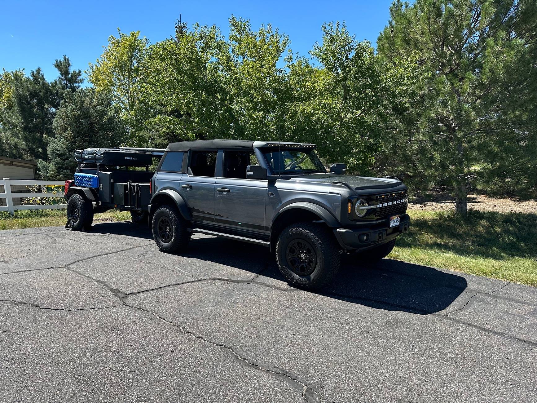

I went with the Blue Sumo springs as well for towing my trailer. Basically it’s a big progressive bump stop so not much to maintain or go wrong. Only down side might be a stiffer ride when unloaded, but I didn’t notice much of a change.
Nice set up which trailer is that
Ellishousehold
Nov 19, 2023
85
1976 Bronco, 2023 Bronco Wildtrak
It’s the Smittybilt Scout trailer… basically a platform you add your components to (water, power, gas, appliances, etc.) I wanted something I could actually tow on 4x4 trails in Colorado to get to dispersed camping spots without the crowds.
