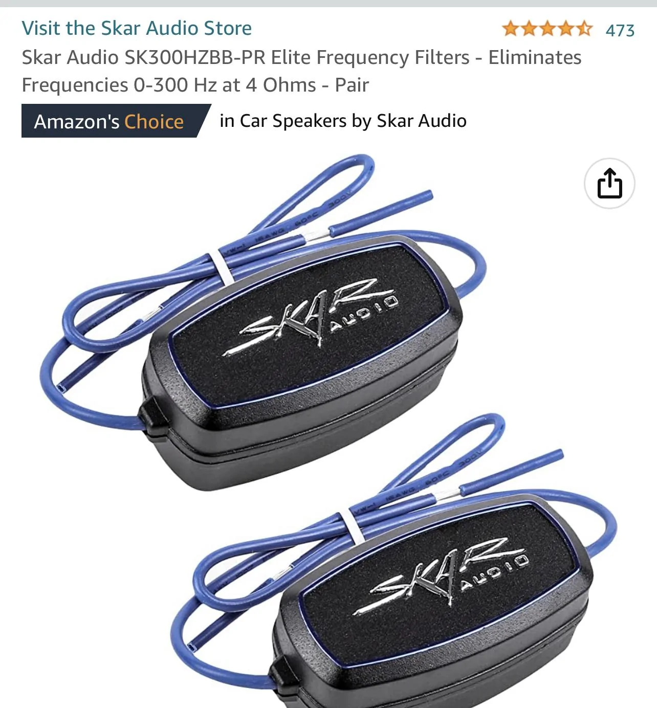

Any update with the 300hz blockers?
Results are in:
Get the 300hz bass blockers! Tested with and without installed at the same time. Without blockers, louder, more treble/sharp actually, and clearer. The treble and sharpness without any blocker is too much imo, and cannot be equalized.
With blockers, more bass, more dynamic fuller sound, but quieter. It was quite evident listening to All Right Now classic rock song by Fire and Water. Yep. I only have one blocker so, waiting on another order.
I’m still shocked there is more bass with the 300hz bass blocker. 🤔
Odd, my rear audio in the back keeps cutting off after 20 mins.
Ford Bronco B&O front speakers worth changing? 5A435D6E-0BD7-43BA-8F6F-3CBFF84BD0E5
Skar Audio SK300HZBB-PR Elite Frequency Filters - Eliminates Frequencies 0-300 Hz at 4 Ohms - Pair https://a.co/d/8C79gjh

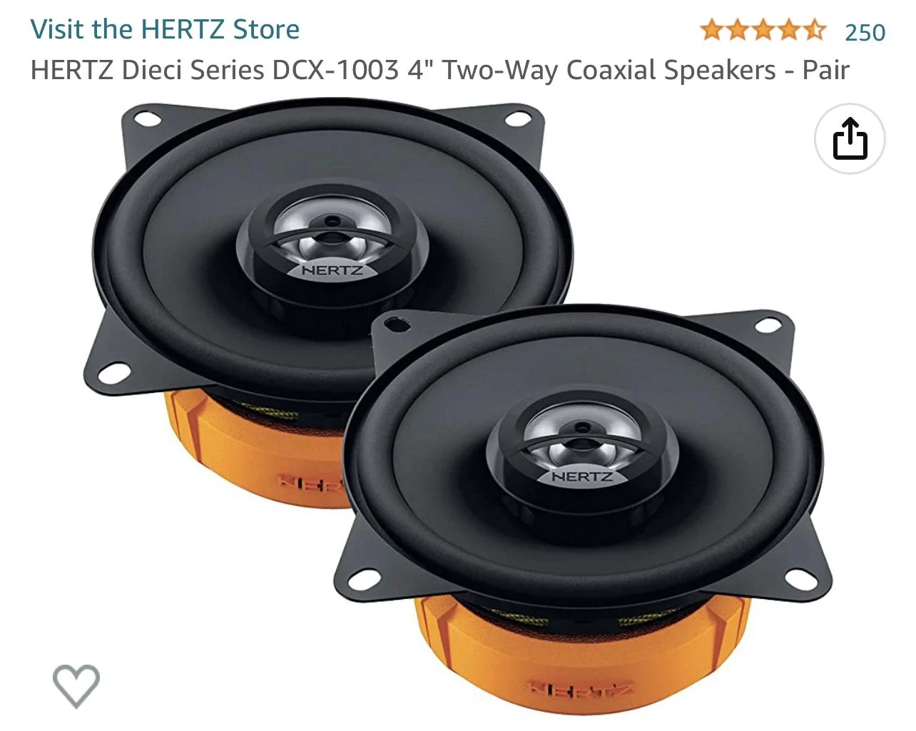

Just tested the Kicker CS and Hertz against each other (no blockers) in fronts. Hertz wins in clarity and overall sound. They are a bit louder too.
Yes, it’s worth getting hertz for the 4 speakers. Even with just swapping w/ 4”.
Buying more Hertz I guess uhh. No blockers on the rears.
The balance of sound should be perfect with the loudness & clarity of Hertz without blockers in the rear and with blockers in the fronts.
Ford Bronco B&O front speakers worth changing? 3B58E883-3859-4351-B092-F8D5B5F1212C
HERTZ Dieci Series DCX-1003 4" Two-Way Coaxial Speakers - Pair https://a.co/d/8fyvOUM

I just did a quick swap of the Hertz DCX 165.3 in the passenger kick panel and I think it's an improvement
everything is subjective, but to me better clarity, range and much better mids and high's
slighly less overall volume and not as heavy on the low's as the b&o
thanks for the feedback on the blockers @WheresMyCar
on the weekend I'll swap out the driver kick panel and try blockers on the front's
