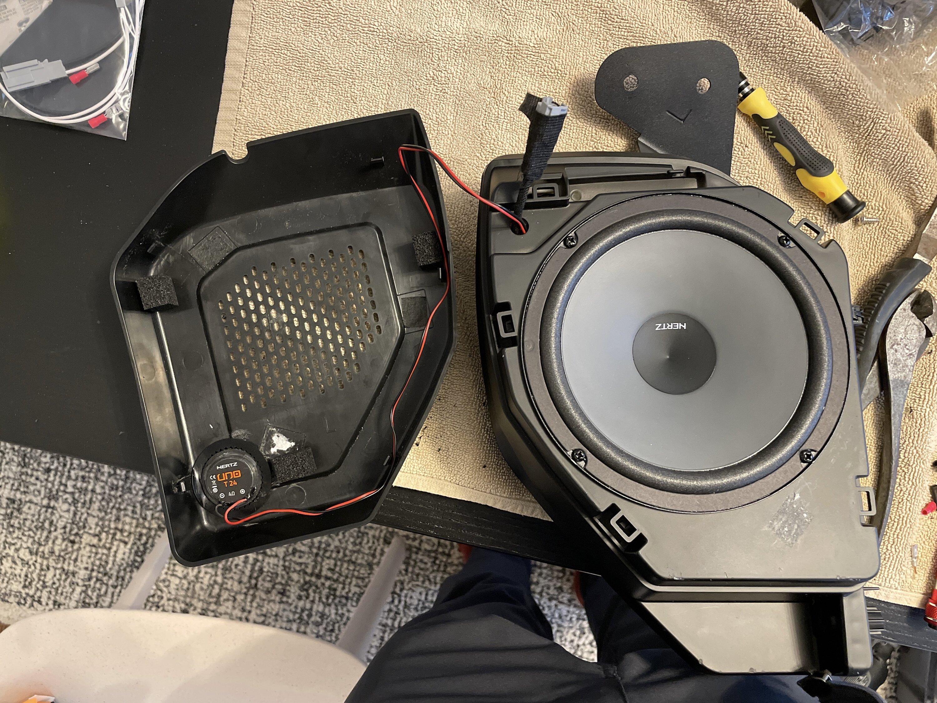

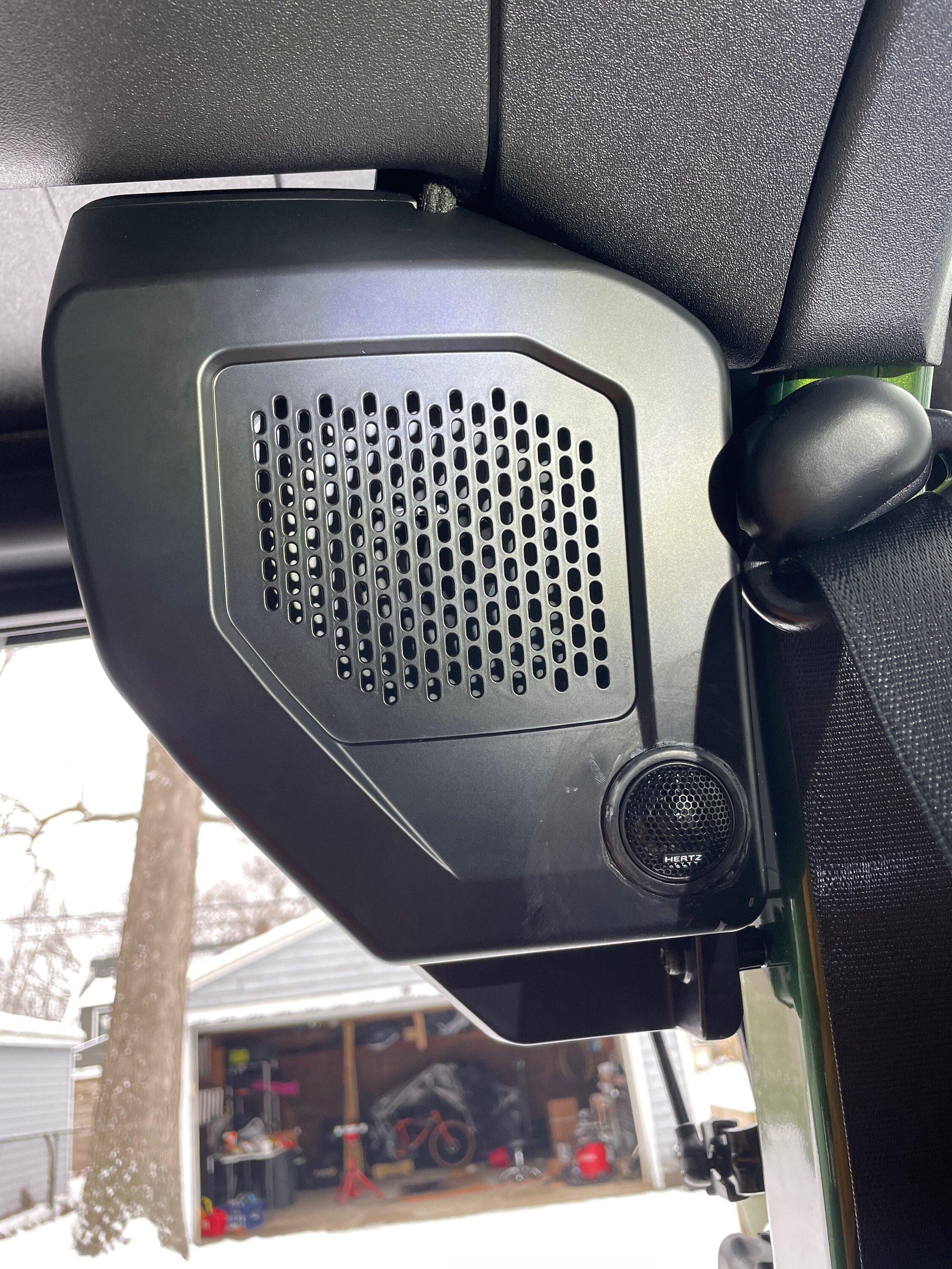

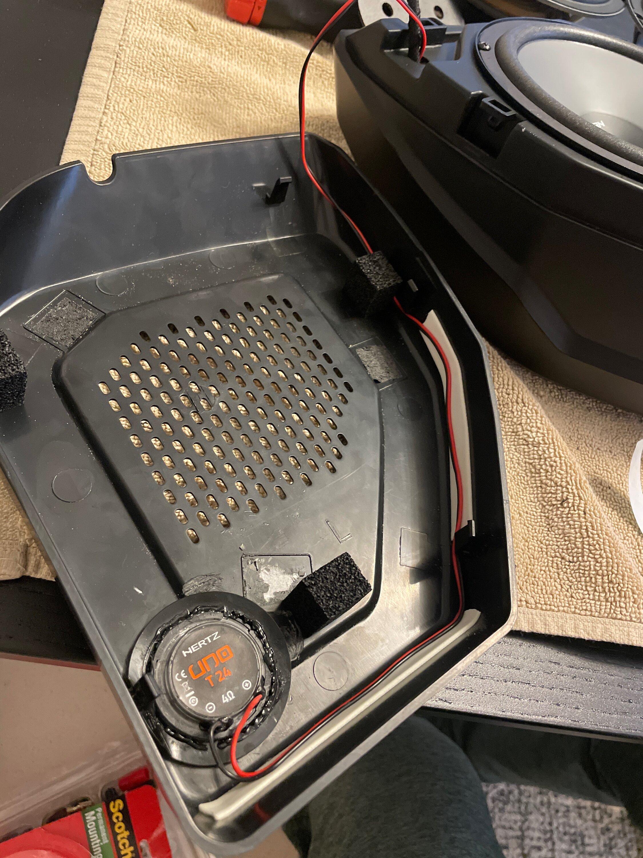

Would you mind posting a pic of your tweeter install on the pods? I was thinking about doing the same, but wasn’t sure if it would work.
I think it would have been a bit cleaner if I’d used a different glue than superglue, and if the Mabett pods weren’t painted (the OE pods are molded in color). When I tried to clean the excess glue off, the paint came with it.

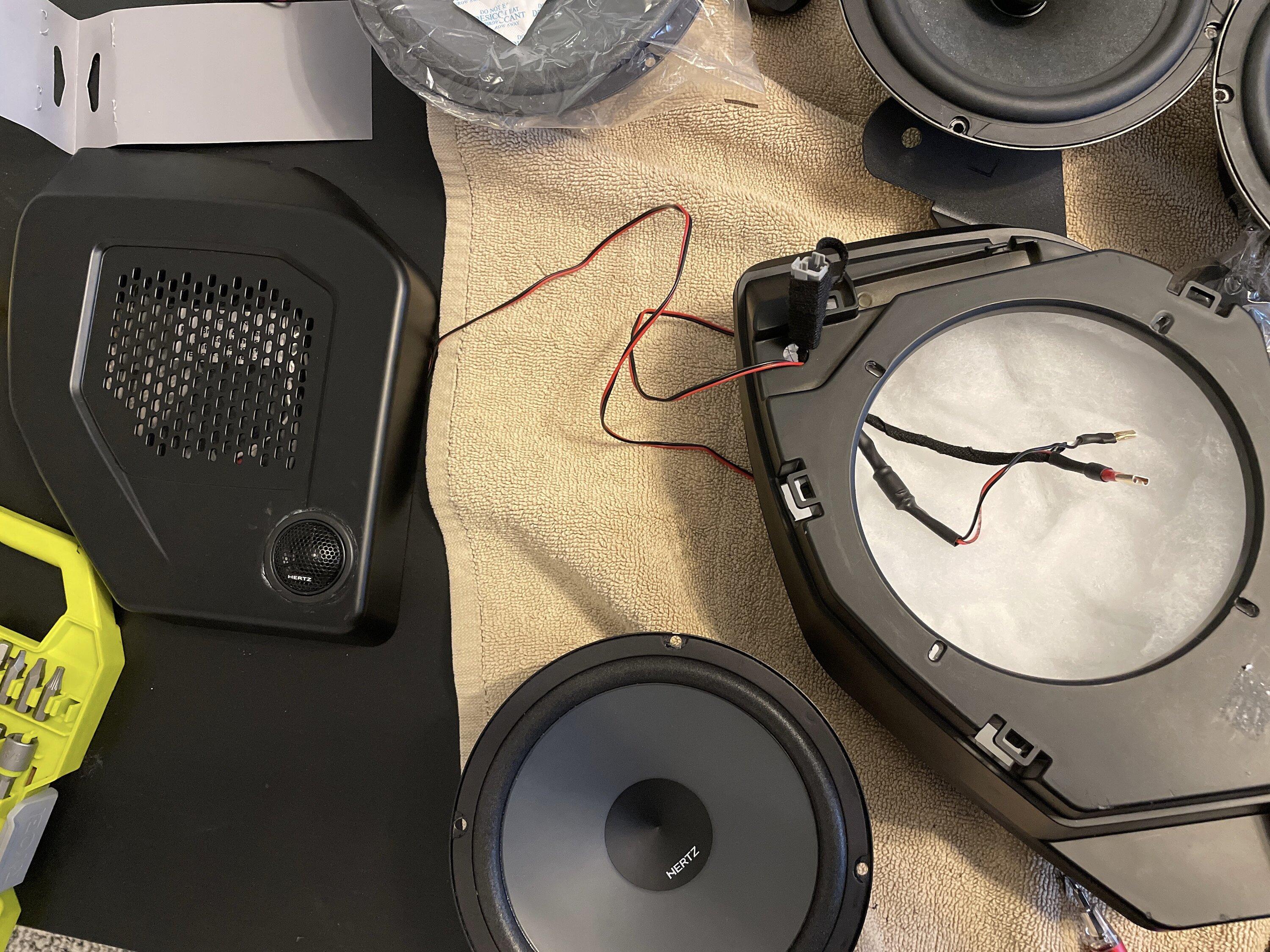

Installed the remaining Hetz speakers in the front with 300hz bass blockers. I think I’m all set now. Just 5 speakers swapped.
Hertz DCX-1003 in front and rear, Center PRV woofer, the rest stock OEM B&O.
The cut out I had before in the rear is gone. Maybe due to poor insulation on my test harness.

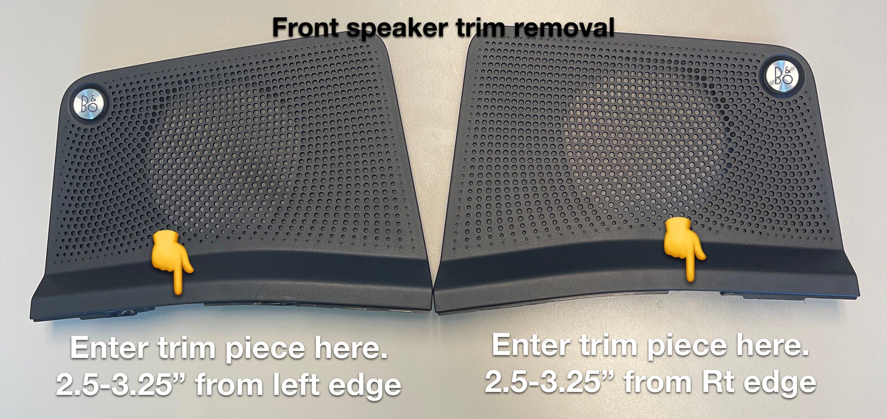

Insert trim piece here to start, then move along sides. The lip you don’t want to crush ends just a little bit after 2.25” from edge. I made the mistake assuming that opening was in the same location on both sides.
